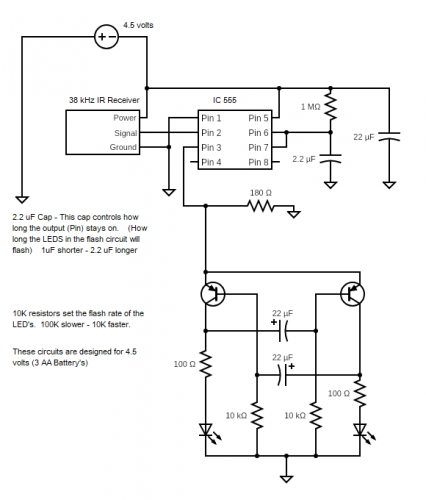

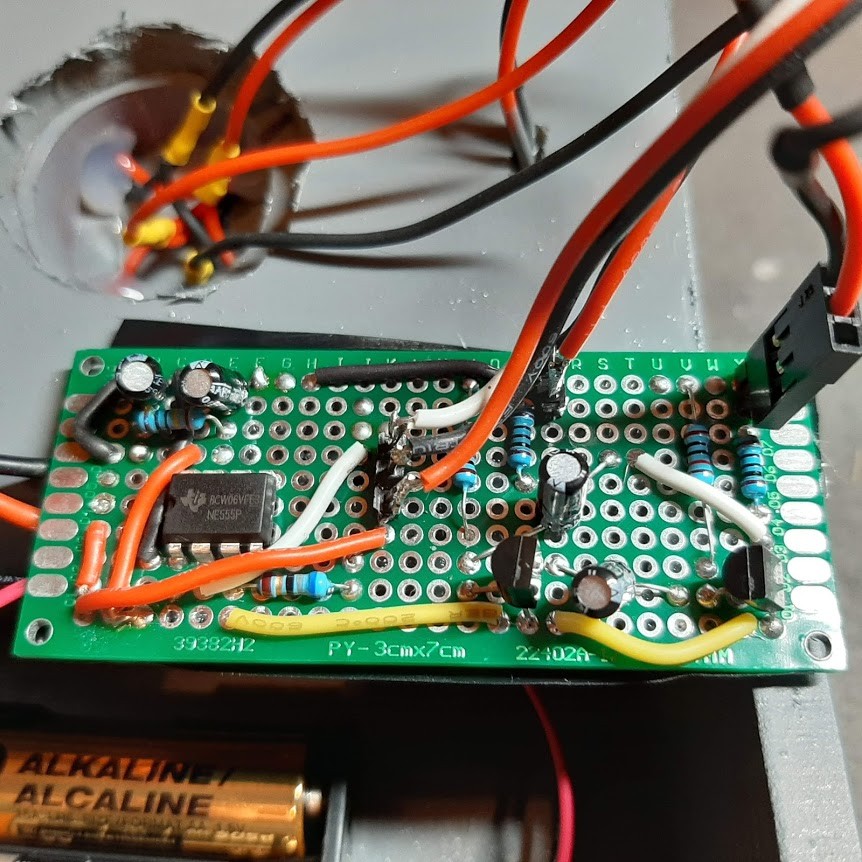

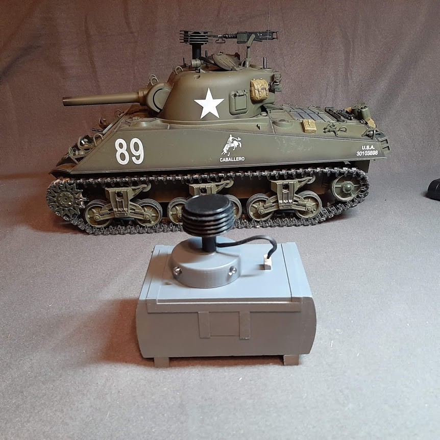

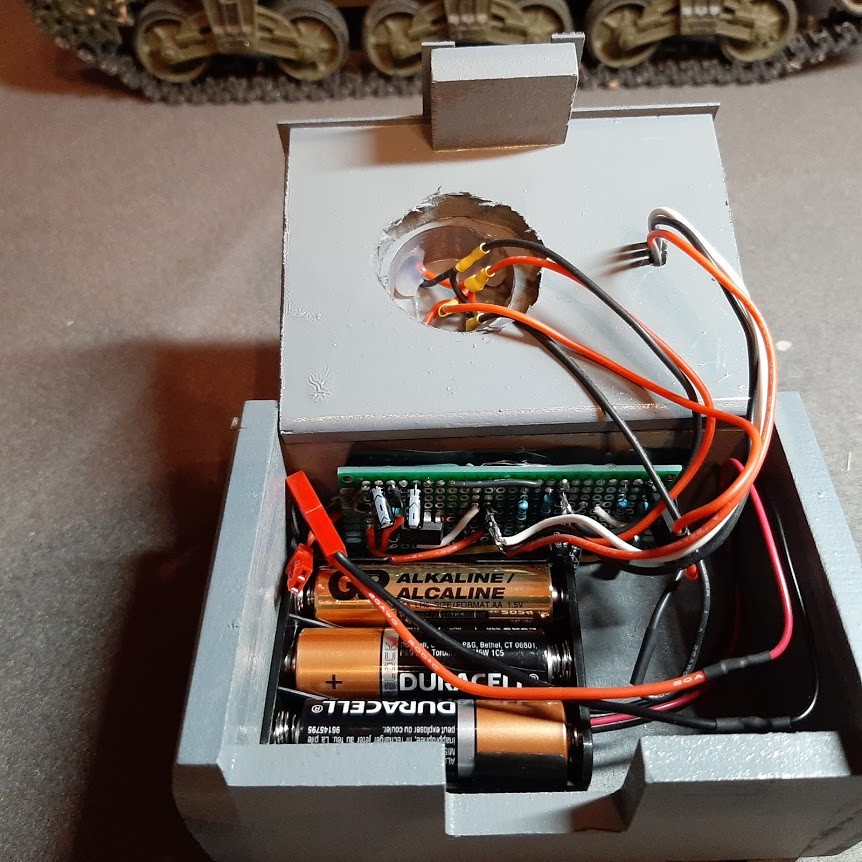

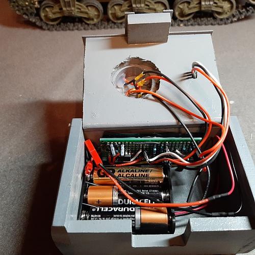

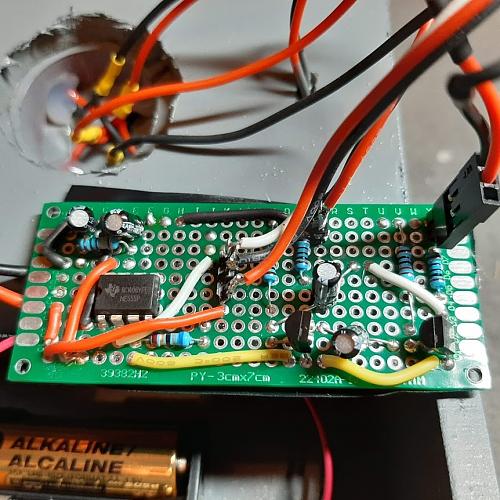

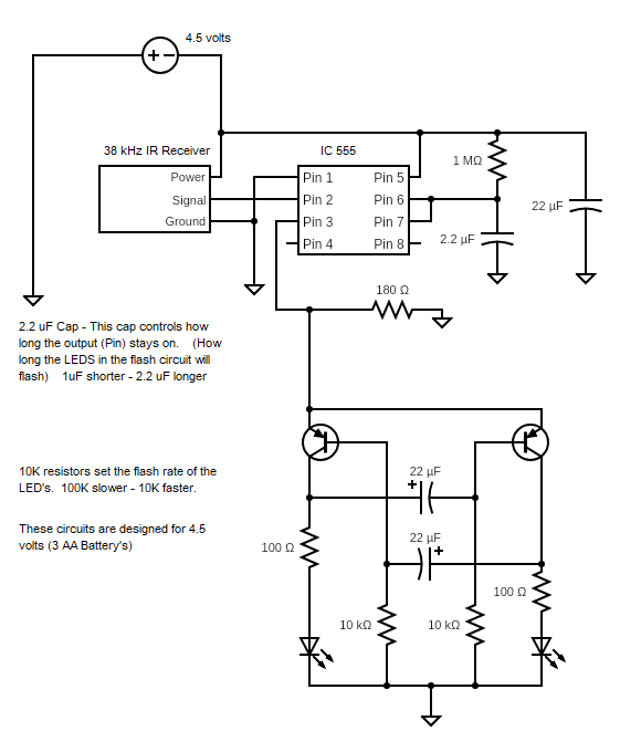

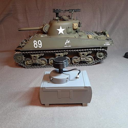

    I Finished up my IR Target Project. This one is just has flashing LED's when it's hit, but there is no reason you couldn't add a smoke system or a motor to raise a flag. I built the circuit board, used a hang long apple with a sun shield I 3D printed. Power is 3 AA battery's. Put it on the ground or in the back of a RC truck and have some target practice. :-)

    Click image for larger version  Name:	Target.jpg Views:	0 Size:	205.7 KB ID:	261651
Name:	IR detection and Flasher Circuit.png

                    All the parts are listed on the diagram above. The IR Receiver unit is the HL 6.0 apple and costs about $3. The IC chip is a IC 555 timer chip. LEDs are 5mm 2 - 2.2 volt LED's Power is 3 AA battery's in a holder.

                            • #15
                              Rudinater: What is the # on the transistors you used for your IR target
                              Thanks
                              • #16
                                Thanks
                                Both Q1 and Q2 are general PNP transistors such as 2N3906,2N2907, BC558
