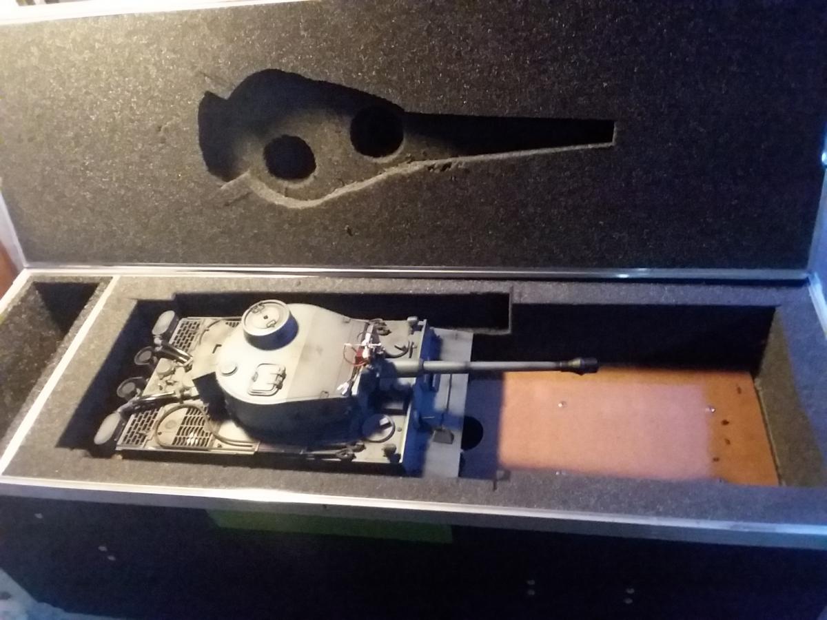

    Transport cases
    Surprised that there isn't a topic about this. So what do you guys use to transport your tanks?

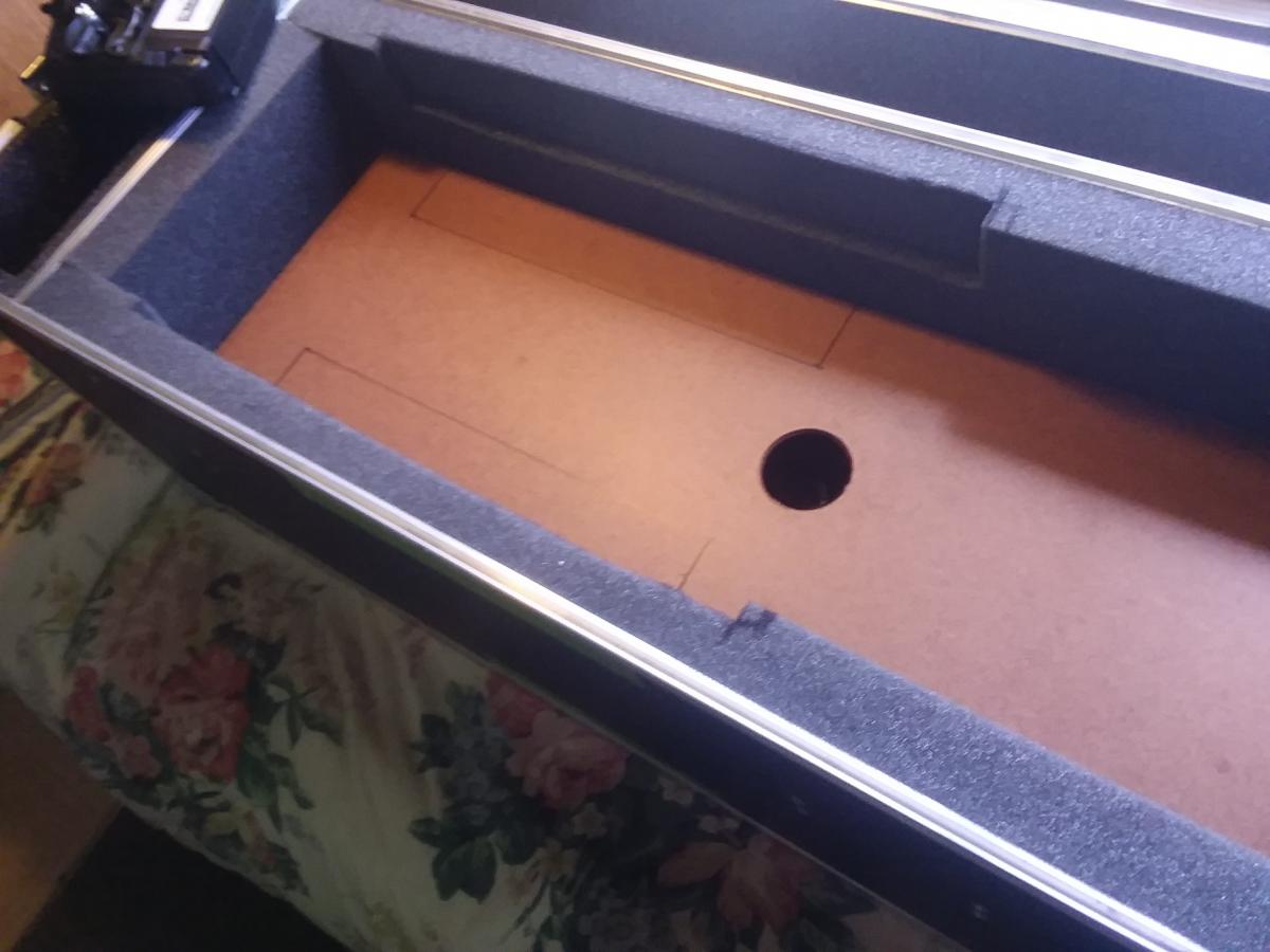

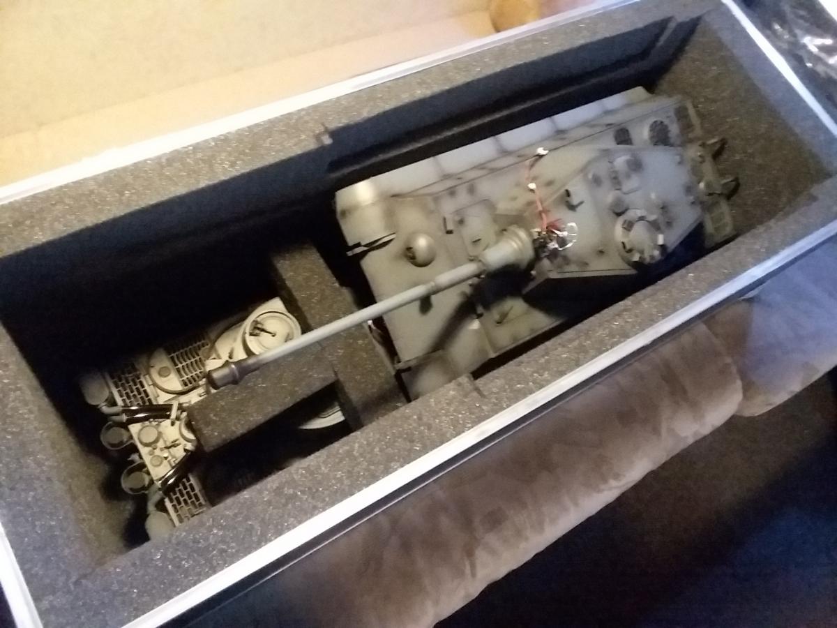

    When I was looking for a good tank transport case I couldn't really find anything suitable ready made. At least not in the Netherlands or in Europe. So I resorted to this:
    I bought a big aluminium trunk of the brand "Defender" and clad the sides and bottom with 5mm thick EVA foam. After that I used sheets of 3cm EPE foam to make a tray for the tank and a smaller tray for the remote control and two battery packs.
    ​​​​The trays are removable, so can be swapped if I would ever feel the need.
    Now all that remains is to take it into the wild. :)

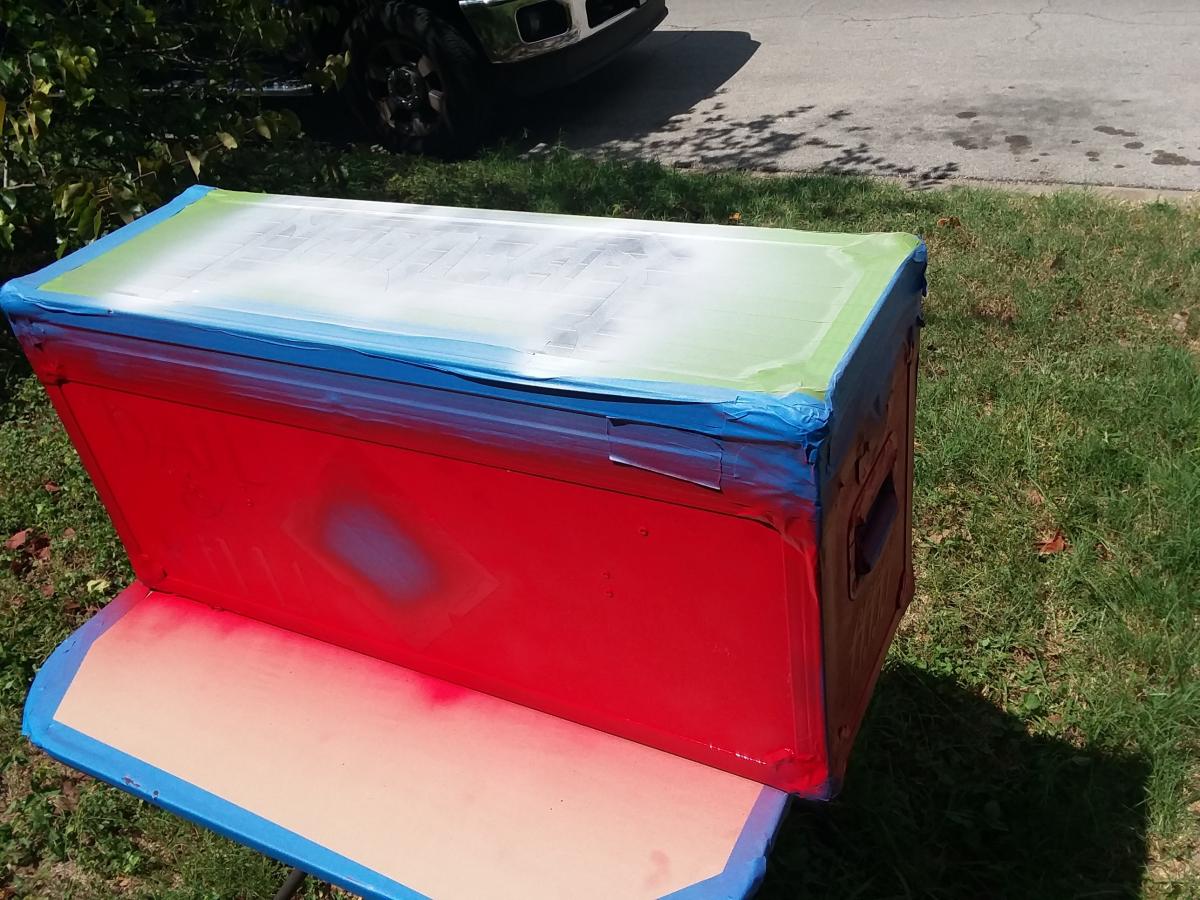

                    A couple of months ago I found this box at Goodwill (thrift store) for $25!
                    I guess it's an equipment carry case for musical equipment or some such. Way too good of a deal to leave behind.
                    I immediately set to work on modifications and decorating.😉 Click image for larger version

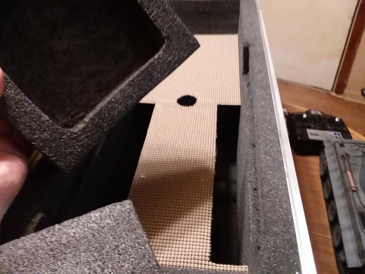

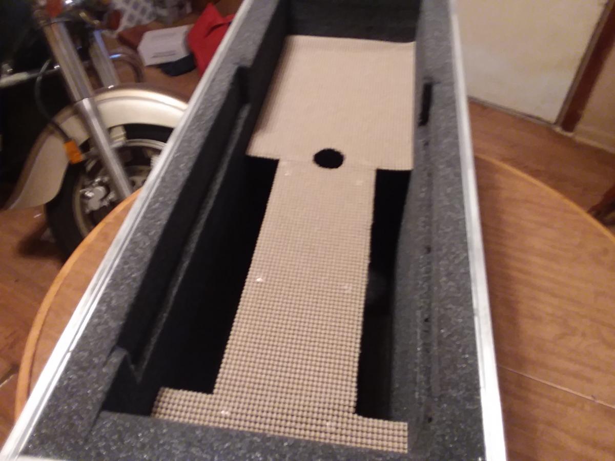

                    I first built in a removable shelf so the case can accommodate two tanks.
ID:	270549Click image for larger version
ID:	270548Click image for larger version
ID:	270547Click image for larger version

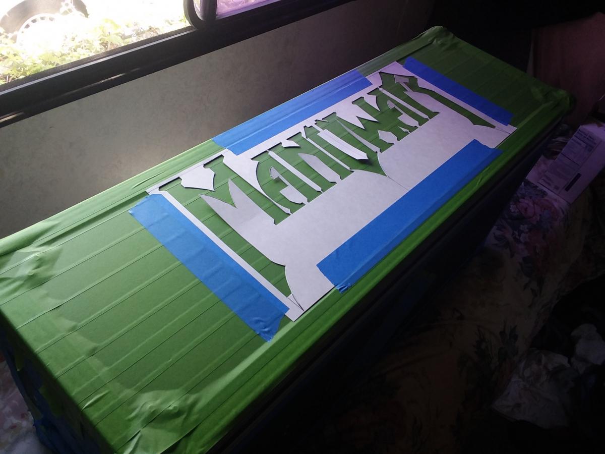

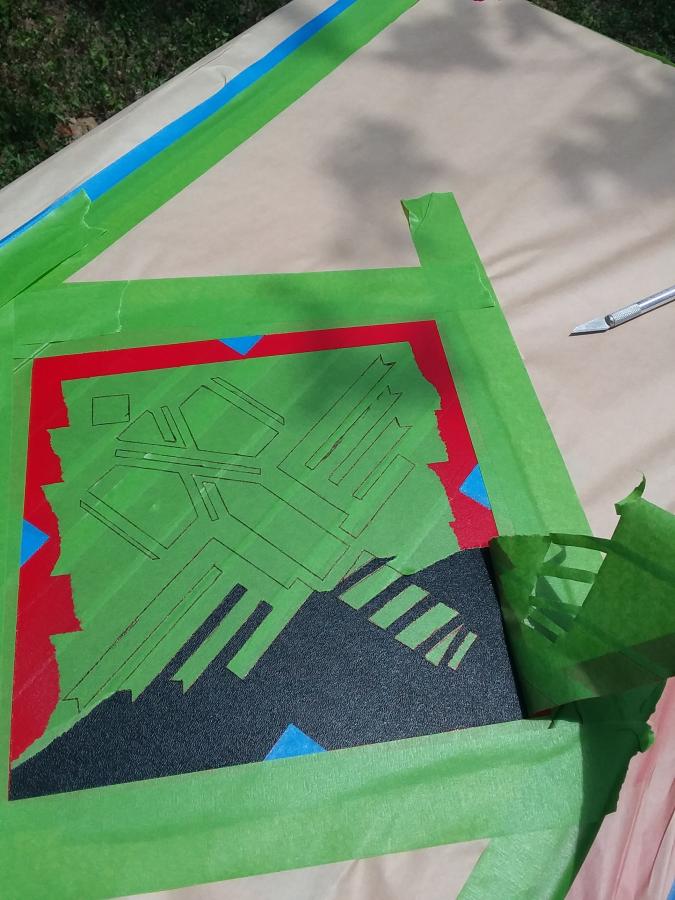

                    Then I went about the tedious task of stencil making and masking.😒
ID:	270542Click image for larger version
ID:	270543Click image for larger version

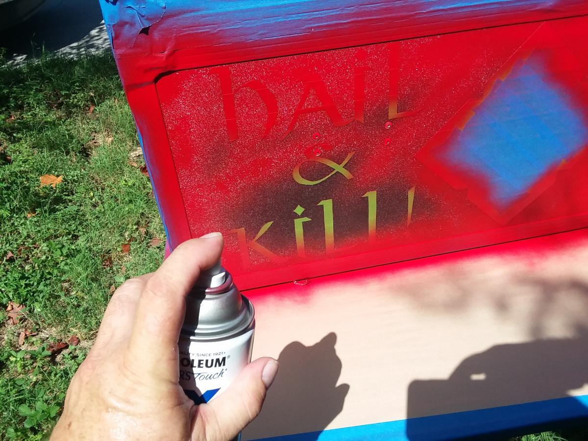

                    Once I was happy with the masking job, out to the great outdoors for paint! Click image for larger version
ID:	270551Click image for larger version
ID:	270550Click image for larger version

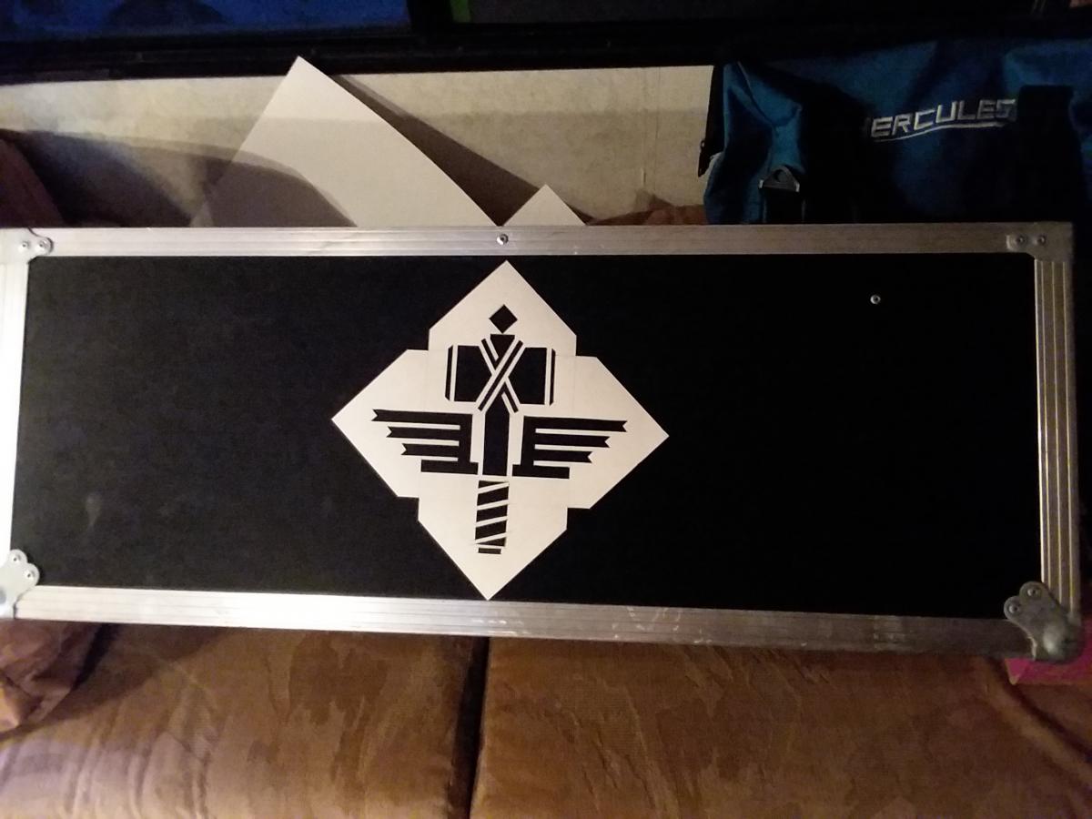

                    So this is my first carry case project and I have a few more planed. It was actually quite a bit of fun!😃
                    This is the end results.

                          Originally posted by Alpha
                          That came out really sharp, Pynaegan ! Did you seal it with a clearcoat?
                          Thank you! I thought about a clear coat for about ten seconds and decided against it. (my last clear coat job was an utter failure)😆😒
                          The surface of the box is deceptively textured and porous so it took a number of passes to get the "black" to disappear. I was afraid my lack of skills would leave my paintwork dull and being a porous surface would be next to impossible to start again. (If'n it ain't broke, don't be a fix'n it)😏
                          HOLY SMOKES!
                          I just looked up the box I have for the first time!😲
                          Looks like it's worth about three to five hundred dollars! (well...before I "had my way" with it)😆
                          If I had to make ANY recommendations, it would be "Frogtape".
                          https://www.amazon.com/Duck-1396748-...45142158&psc=1
                          The green tape on my project was frogtape.(no bleeding)😃
                          The blue tape on my box was regular masking tape. (occasional bleeding)😒
                          Next time will be Frogtape all the way.😏
                          I'm sorry I didn't document the entire modification as I should have. Once I start picking up tools, I get into a "groove" and forget to take pictures.

                                Sorry it took so long to follow up. (life and such)

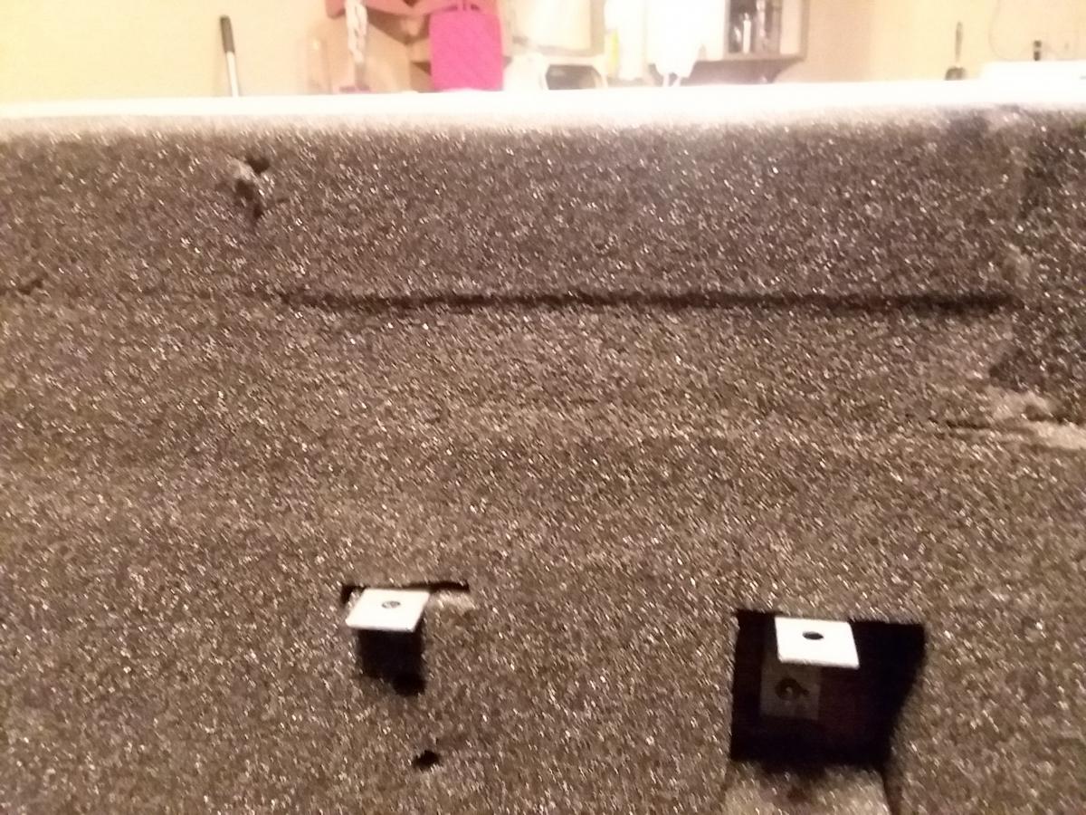

                                After measuring for the height of the shelf, I pop riveted some two inch brackets to the inside.
ID:	274815Click image for larger version
ID:	274809Click image for larger version
                                Made the shelf to fit the Tiger 1
ID:	274812Click image for larger version
ID:	274817Click image for larger version

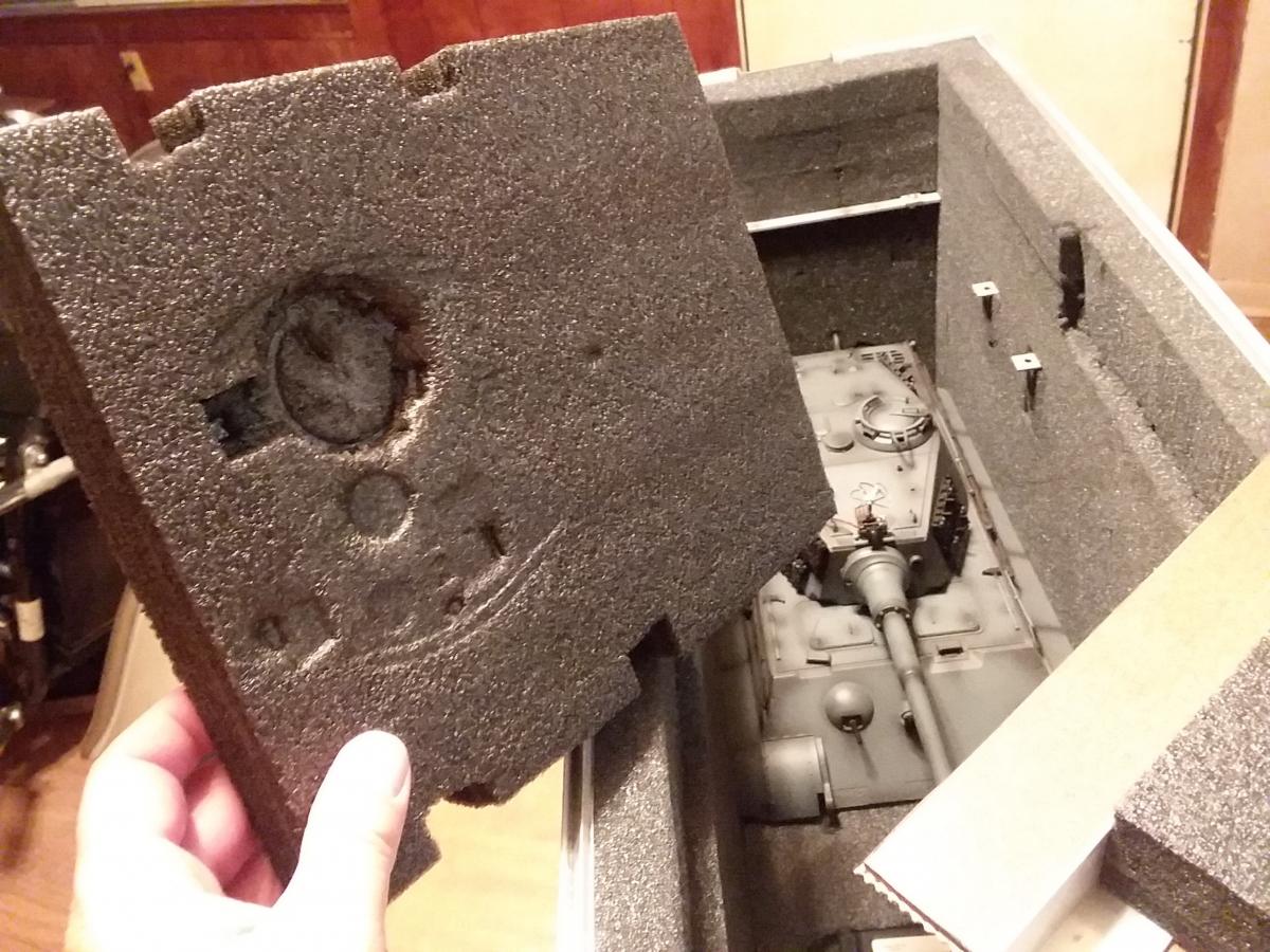

                                Cushions for the Tiger 1
ID:	274810Click image for larger version
                                A bit of spacer padding to keep the King Tiger in place.
ID:	274814Click image for larger version
                                Padding for the Tiger 1 and it's controller.
                                Cavity at the end of the chest holds batteries, charger and FPV goggles.
ID:	274819Click image for larger version
                                Clamp down the lid and we're ready to travel!
