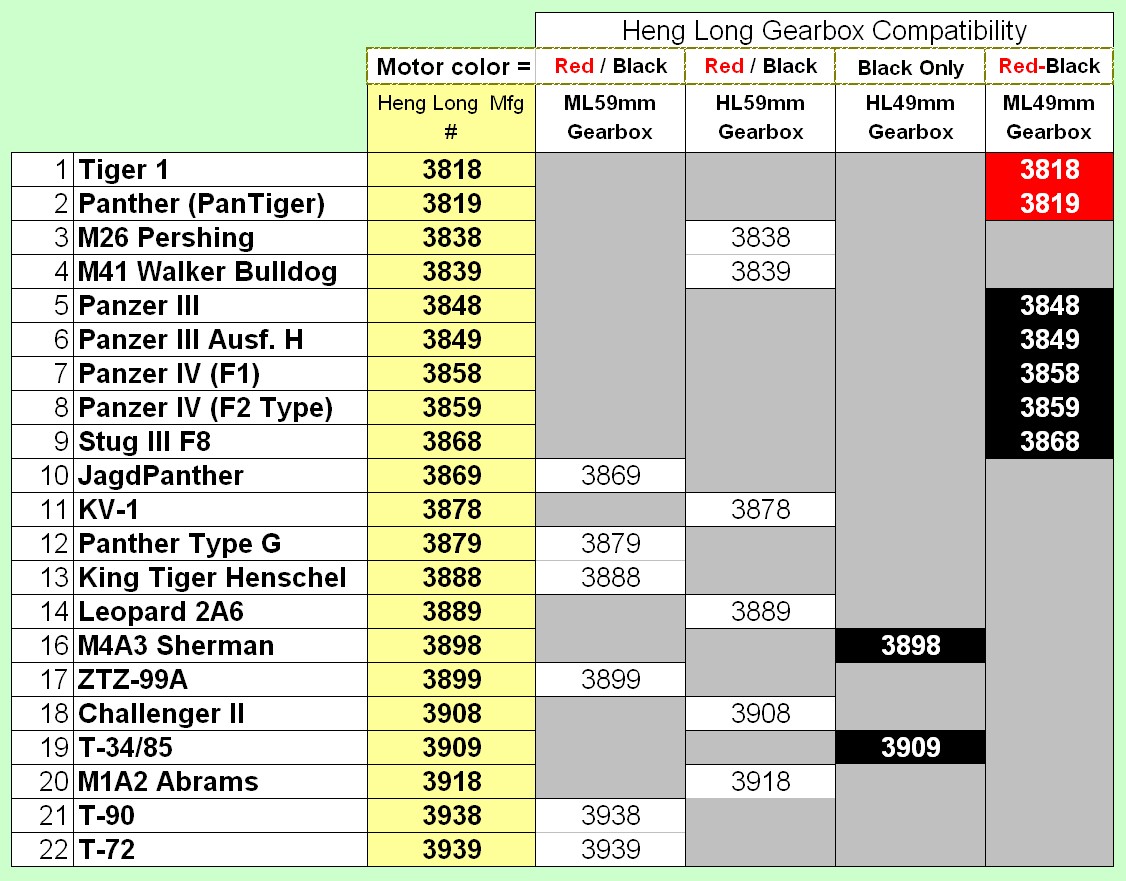

    Tiger I should be ML49 gearbox and you can use Red or Black/Blue motors.
    Click image for larger version  Name:	HLTank_GearboxMotors.jpg Views:	0 Size:	234.4 KB ID:	272855

      That's a good reference chart but for some reason Motion doesn't reference part numbers just descriptions like high/low short shaft etc.

        I guess “ML” means medium/low and “HL” means High/Low. I would also assume “59mm” is long shaft and “49mm” is short shaft. I don’t know this for a fact as it’s just an assumption. I don’t know if Motions tech support can verify this or not...

          You are correct: Long = 58/59, Short = 49
          HL = high low, ML= mid low
          • #6
            So it appears my Tiger I needs a middle/low short shaft gearbox set.
