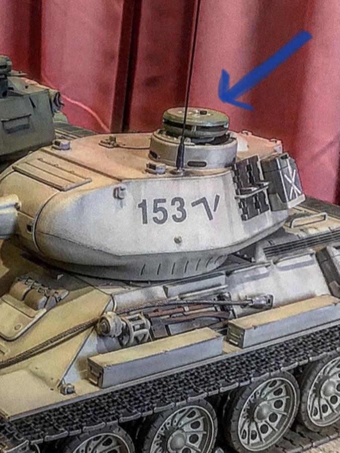

    LegoDEI makes an excellent low profile IR receiver. You have to install it which takes some basic hobby skills, but as you can see it sits about as low as an open hatch would.

      Can it be mounted inside? Dai
      • #4
        Ive seen it done, but it means your running IR receivers to each side of your tank yourself.
