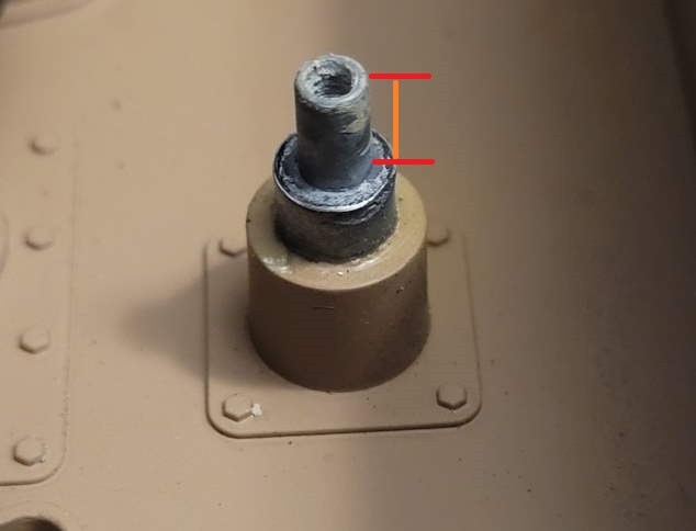

        Rubicon99 Finally got some time on this, just to be clear, do you cut off the stepped section with the thread, then possibly enlarge the opening to insert the M41 rollers by its shaft with friction/CA? Thanks.
          Yes I removed the shaft and did a some fitting as needed.

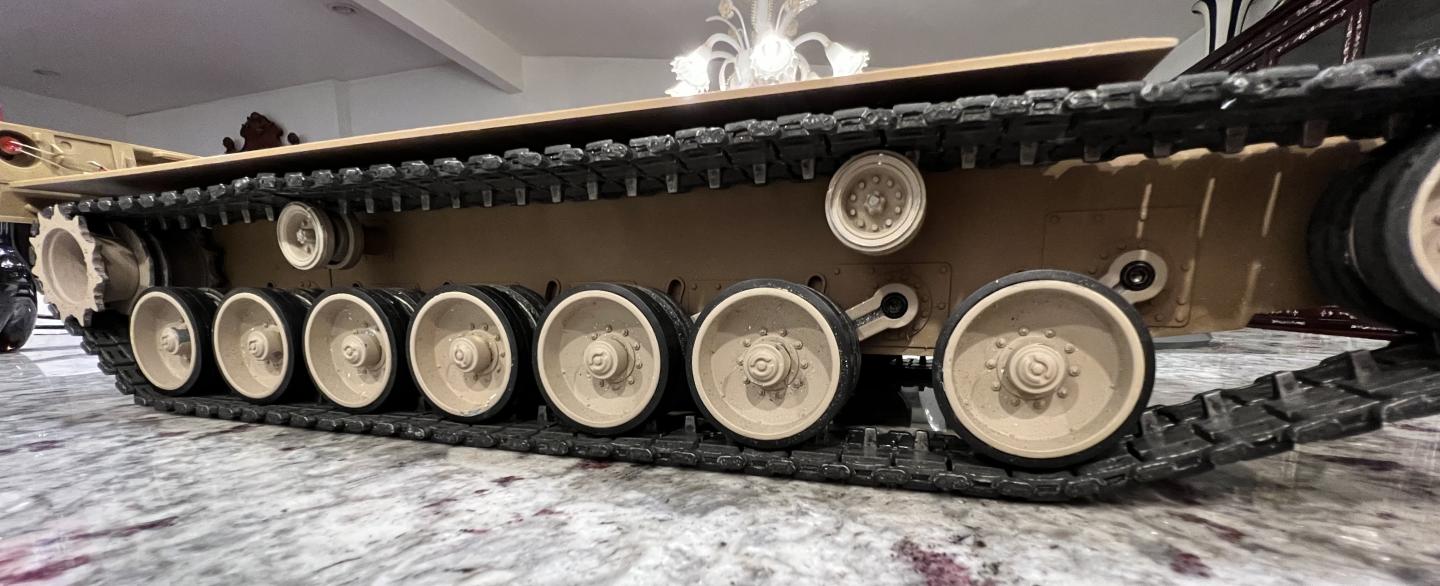

              Rubicon99 I know it's an old thread, and I don't know how I misplaced the return rollers for 6+ months, but they were in one of my drawers so I ended up fitting them since I had some time. Thanks again for the tips. BTW, the DKLMRC tracks were throwing on the Leo 2, but they seemed just fine on the HL Abrams.
              BTW, the OP's problem & mine could actually be solved differently, the problem is that when the factory glued in the roller's shaft into the "pocket", there's either debris inside the pocket or the person simply didn't seat it home, hence the mounted roller extended slightly and the guide teeth ride on the roller. With some heat on the shaft, the shaft can be removed from the plastic housing and ground down from behind, reseat the shaft+roller and be done. But I like the practicality of the replacement.
