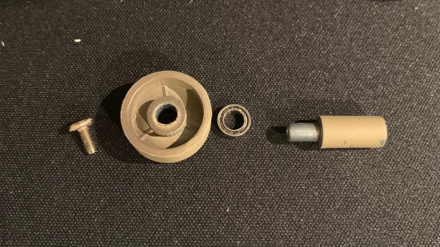

          I received the remainder of the metal upgrade components and wanted to share what I've learned during my installation. So far, I only managed to install the metal road wheels and metal sprockets.
          Tips:

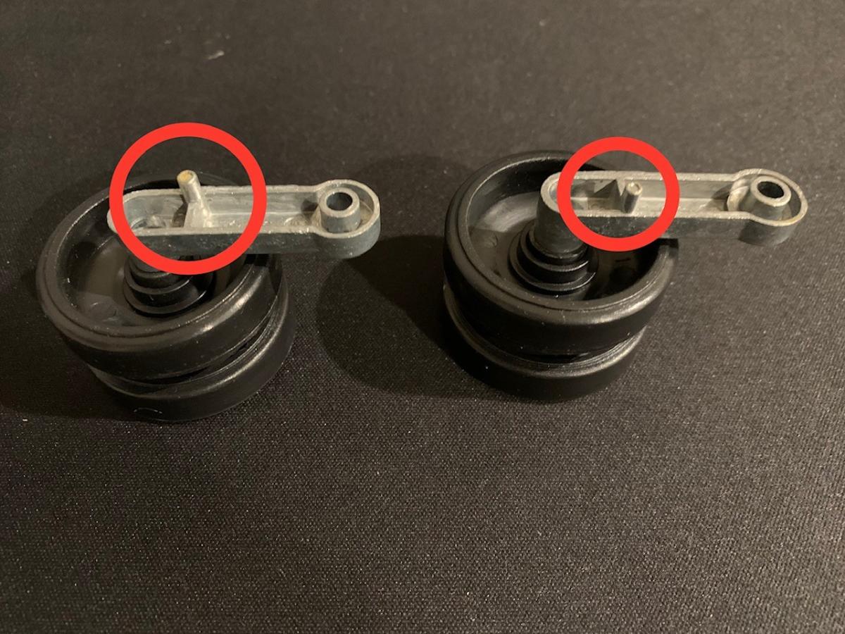

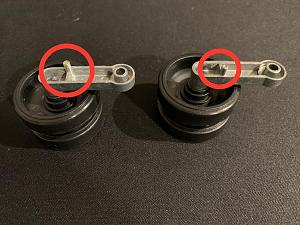

          1. Use quality tools, such as a hex bit screwdriver instead of the hex key the kit comes with or you may risk stripping the screws
          2. In regards to the road wheels, be mindful that the pin that slots into the groove on the tank body is on the upper half of the suspension arm for road wheels that go on the left side of the tank and is on the bottom half of the suspension arm for road wheels that go on the right side of the tank. I realized there was a difference after installing 2 road wheels on the wrong side.
          Click image for larger version  Name:	IMG_8142.jpg Views:	0 Size:	162.7 KB ID:	307596

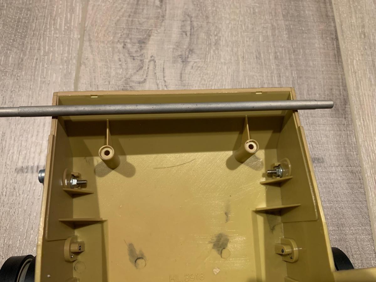

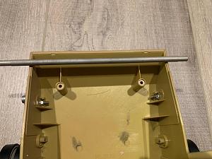

          1. Did I receive the wrong idler bar? The one provided seems way too long
          Click image for larger version  Name:	IMG_8145.jpg Views:	0 Size:	112.2 KB ID:	307597

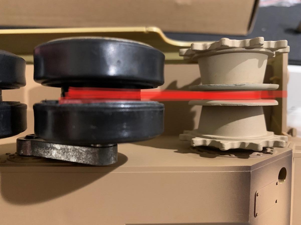

          2. In regards to the long and short guide wheels on the top of the tracks, the metal version I received can be disassembled as seen, however I can only remove the plastic wheel on the tank since the rest is molded into the lower hull, meaning I can only swap out the wheel?
          Click image for larger version  Name:	IMG_8144.jpg Views:	0 Size:	258.6 KB ID:	307598

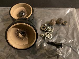

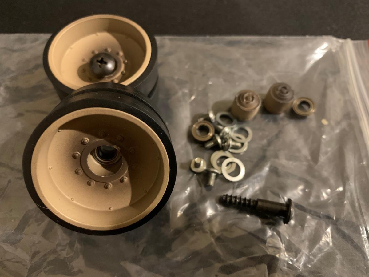

          3. In regards to the idler wheels, am I supposed to use the extra bearings and washers to shim the wheel so it doesn't wobble? I've only inserted one bearing inside the center hole. I also realized that the caps do not fit and can't be inserted to cover up the screw but I guess it doesn't really matter since the idler wheels are mostly covered by the hull.
          Click image for larger version  Name:	IMG_8143.jpg Views:	0 Size:	91.2 KB ID:	307599

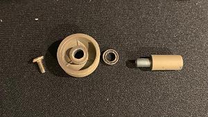

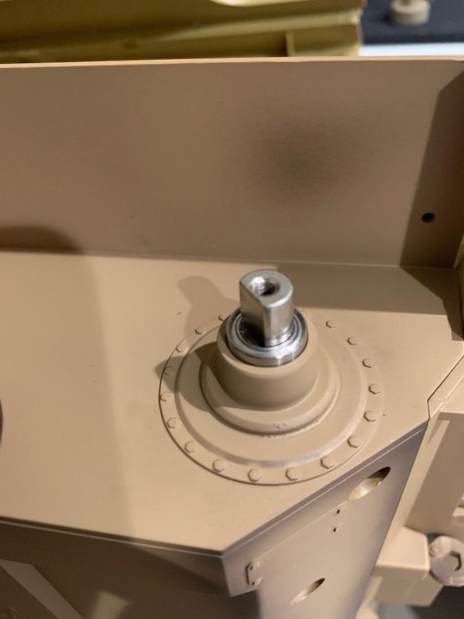

          4. Lastly, is the drive shaft bearing assembly supposed to be flush once inserted in the flange? I followed another members advice on only purchasing the bearing instead of the kit with the flange and it doesn't seem to sit flush, however when I installed the sprocket, the center guide looked aligned with the road wheels.
          Click image for larger version  Name:	IMG_8140.jpg Views:	0 Size:	36.6 KB ID:	307600Click image for larger version  Name:	IMG_8141.jpg Views:	0 Size:	76.8 KB ID:	307601

            #1 Yes that appears to be the wrong idler support bar. It looks just like the one for the old 5.3 Abrams which did not have the new adjustable idler.
            #4 The bearings should be flush. When flush there is also a small gap between the bearing face and rear section of the sprocket hub (once the sprockets are installed).This gap does cause the bearing to slowly work its way “slip” out. A solution to the bearing slippage is to add a nylon “spacer” (washer) or two to close the gap and hold the bearings in place. This is actually a very common issue with many HL tanks and the solution works perfectly to solve the issue with no degradation in performance. In fact it tends to add even greater axle support.

                      Hi Rubicon, regarding issue #4 .. During tank day last week, I remembered you showed me this "track slip out" problem with the sprocket on my Abrams tank, and told me the solution.. Could you clarify the solution again, or snap pictures of the solution of how the nylon spacer washer is fitted to your Abram sprocket to show the solution.. For me, it is easier to see a solution pictures... Thanks.

                          #32
                          Should I apply force to try to get it flush, I'm a little concerned of damaging/breaking it.
