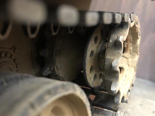

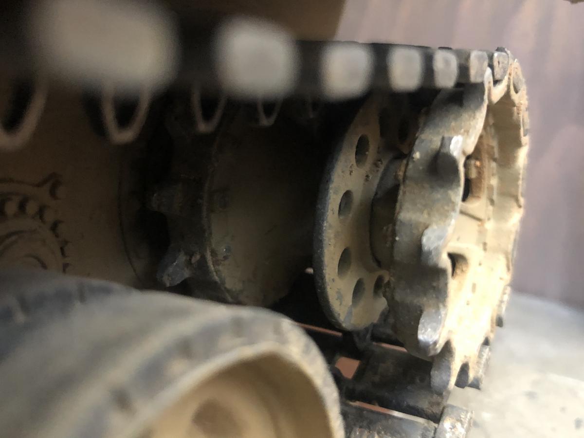

Depending on where you intend to run the tank you might want to run only the out ring on each sprocket. This is usually a mod that works best if you routinely run in soft soil terrain. Why? Because the track will carry soil up and around the sprocket which as it falls free lands between the two rings and is packed in place by the guide teeth. This causes there to be less room for the guide teeth and they will “ride up and out” from between the two rings and cause a de-track. Removing the inner ring allows the soil to continue to fall free and the packing issue is solved, yet track retention remains. Occasionally on some hard turns the track will slip slightly off the sprocket toward the inner hull and rub, but then “re-track” itself. This is the lessor of to evils.
If you do this mod you will need to adhere the outer ring to the outer sprocket. Most of us use a small amount of black RVT silicone to adhere the outer ring in place. RVT is more then strong enough to hold, yet is completely reversible and relatively easy to remove should you want to.
If you do not plan to drive in soft soil often then leave the sprocket ring setup with the two rings installed on each.
