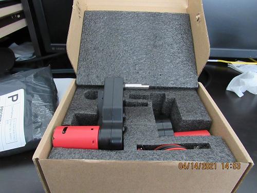

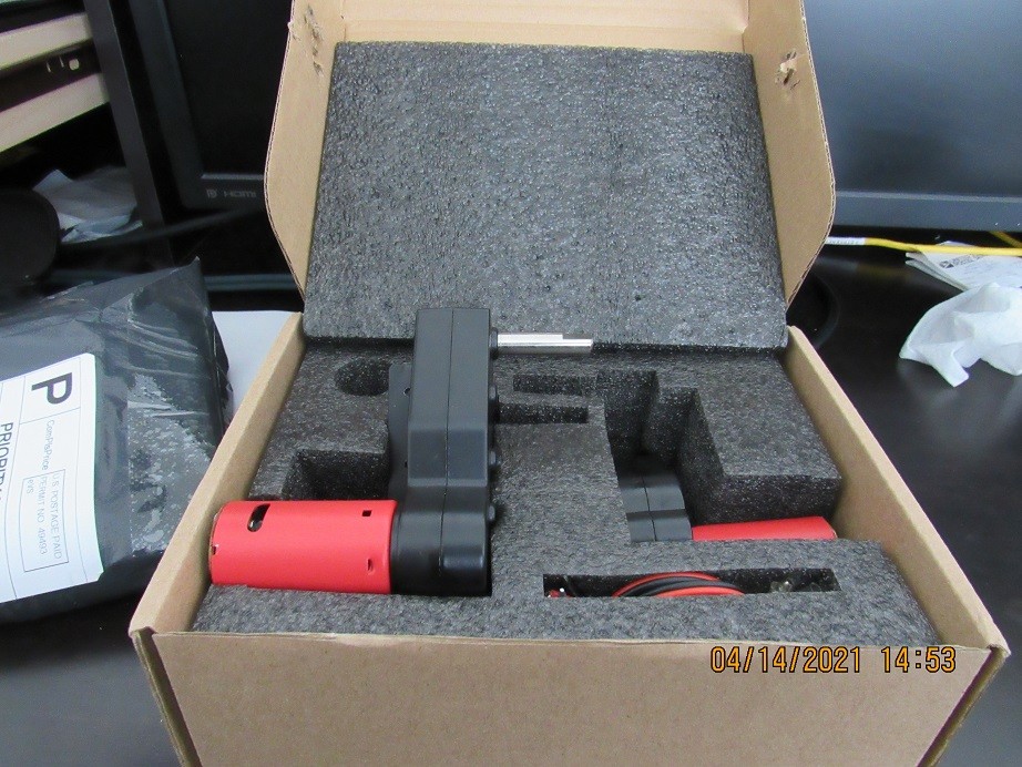

This is the Heng Long gearbox available from Toucan Hobby.
Henglong ML49mm ML59mm Steel Gearbox 1/39 or 1/56 Gear Ratio for 1/16 – TOUCAN RC HOBBY (toucanhobby.com)
Unfortunately, no spec for the motors.
I was looking for your gearbox with the 540 motors. Do you have a link to the seller?Comment

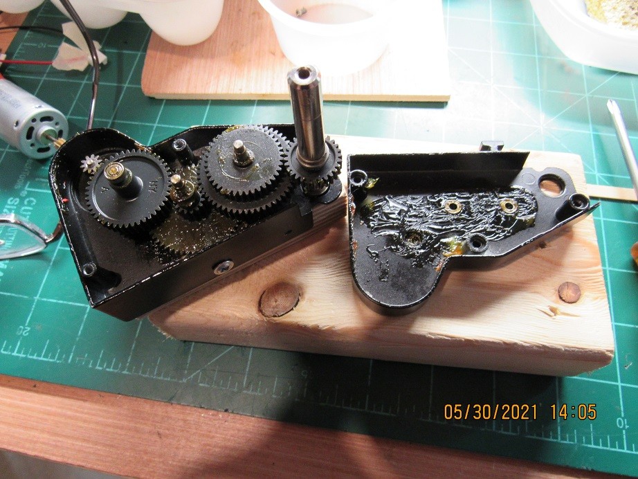

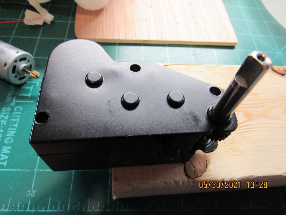

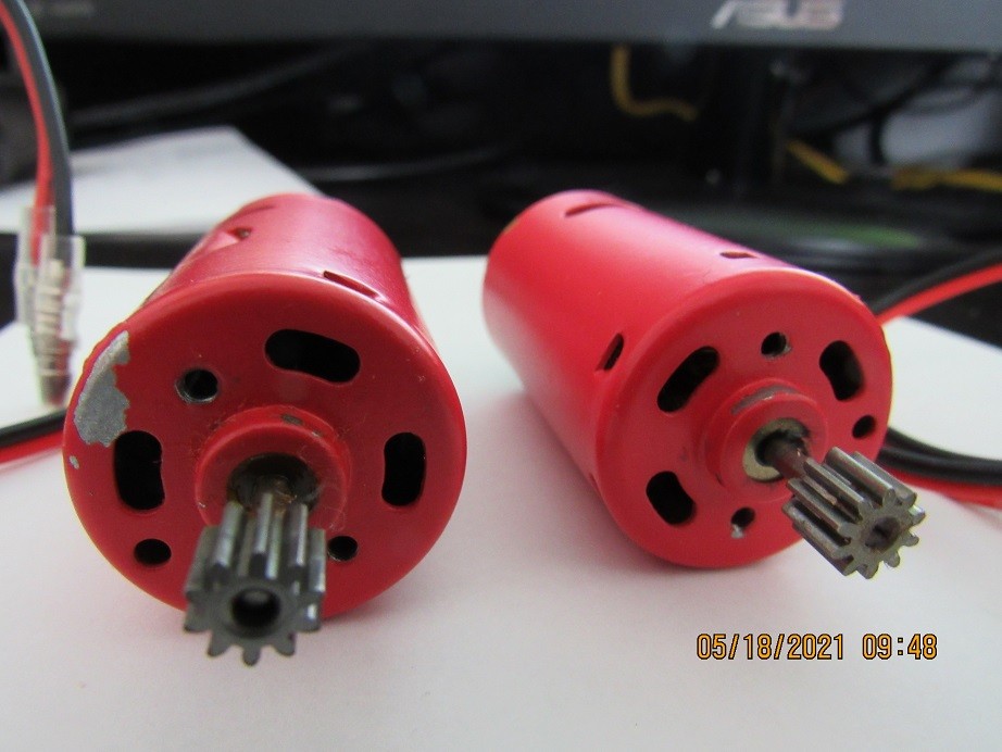

How easy is it to swap to the 540 motors?
The gear ratio is 4:1 for this gearbox. A 25000 Plus/minus 5000 rpm 540 should work fine?

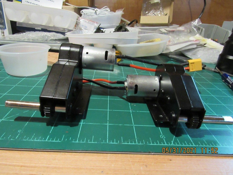

With the 540s the Abrams is probably slightly slower than it should be in scale speed, but it has tons of power. I'm using a Clark TK80 to power it.I answer my own questions:

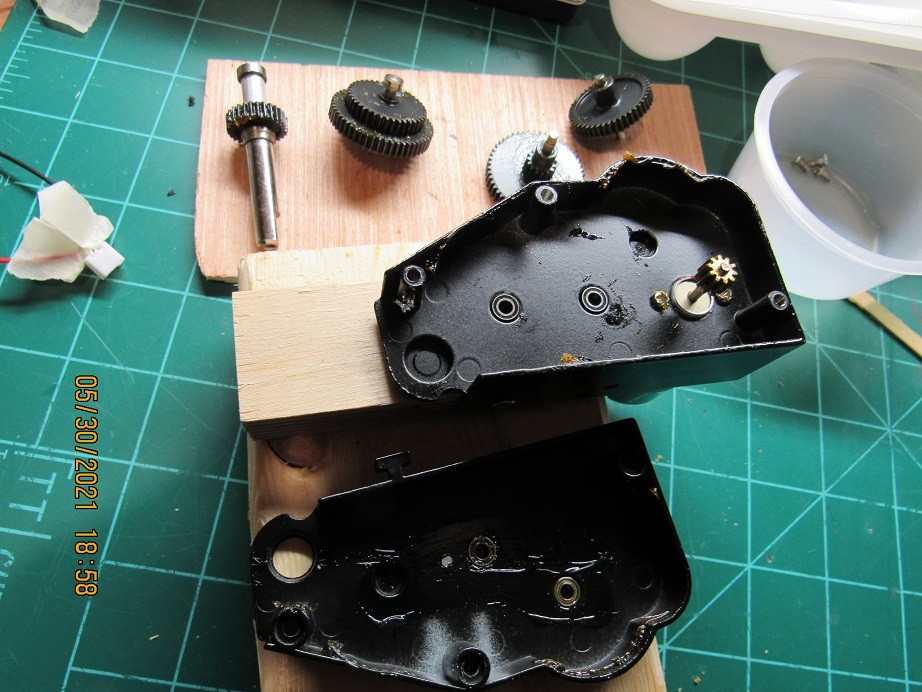

That motor should work fine. You just have to undo 4 screws on the motor case, slide a couple of gears out of the way, remove two screws holding on the motor, and pull the pinion gear. Installation is the reverse. They are made to fit the Leo so the 550s should fit in that hull. The gearboxes are also available through Toucan. Mounting screws come up from the bottom just like the Heng Long CNC gearboxes so they will not work for every installation.

I have swapping 380 vs. 390 motors on the Heng Xin gearbox many times. The 550 gearbox seems very similar.

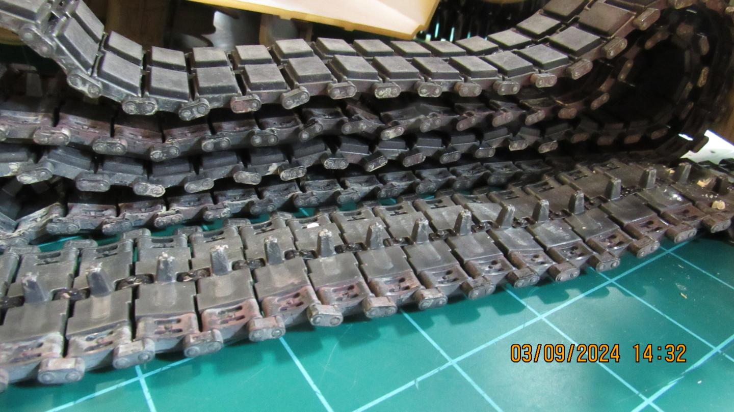

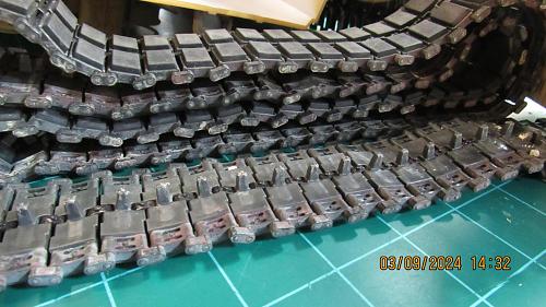

Using your ebay link to UK seller as a clue, I searched sellers in Europe and Hong Kong. I found a used Tamiya original track (not the expensive die-cast metal track). It came in dirty, but in very good physical condition. I was able to clean it up and it looks like new. Thank you cleong .https://www.ebay.com/itm/395141544590
Its a more reasonable price I believe, but see if HK-based retailers can order it and have it sent to you?
It will be used with the Heng Long Chellenger2. I paid about 60% of what I paid AAF Meseum Shop. I am happy that the used tracks seemed to be on a display model with very little wear.Originally posted by TamiyaThe double-pin tracks, which are equipped with pads made out of rubber like the actual tank, come pre-assembled.Comment

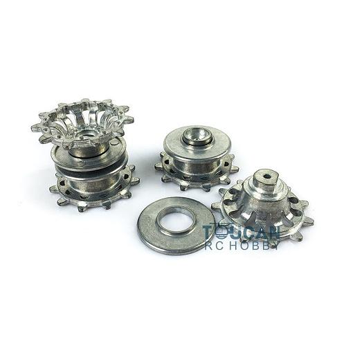

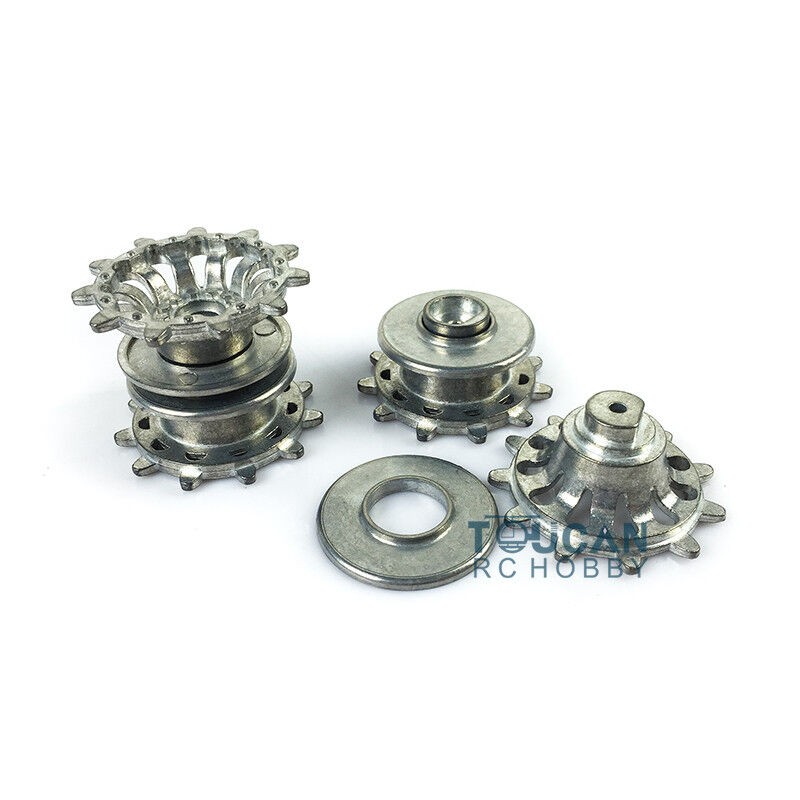

I use the HL metal sprocket with the Tamiya nylon track on my HL Leopard 2A6. They are hand in glove perfect match. Runs extremely smooth.
I am buying upgrade parts for the Challenger2 before putting down the money for the tank. With the track problem solved. I should move ahead very soon. Won't find out how well the Challenger2 metal sprocket works with the Tamiya nylon track until I have the tank and the parts. I am ordering the HL challenger2 metal sprocket. I believe that it has a good chance of working as is with the Tamiya track.
