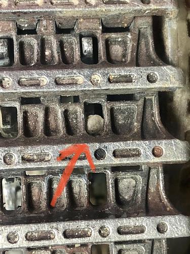

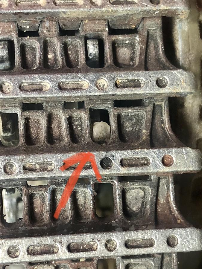

                        DLKM metal tracks are the same as the Haya metal tracks. Both are high quality in their construction and both work, but I would not use them for anything more then simple running because of the issues pointed out in a review thread I did on them and the stress to the Tamiya idlers and return rollers that can and do happen when driven in soft soils or sandy conditions. The metal tracks are solely hard packed surfaces only in my recommendation when used on the Tamiya Centurion.
                        Another option looked at, but yet to be tried is to see if TD Centurion plastic tracks will work on the Tamiya Centurion. TD "plastic" seems to be on par strength wise with Tamiya nylon tracks.
                        On a side note the TD metal Centurion tracks running on TD sprockets have similar issues with soft soils and sandy conditions when it come to small rock jams in the track "sprocket holes".
                        Typical rock jam that causes the issues. This does not happen with the Tamiya nylon tracks as they allow for small rocks like shown to be easily pushed out by the sprocket teeth. Metal tracks do not have the "flexibility" of nylon and the rocks simply get jammed in. Can be a bit of work to manually force the rocks back out.

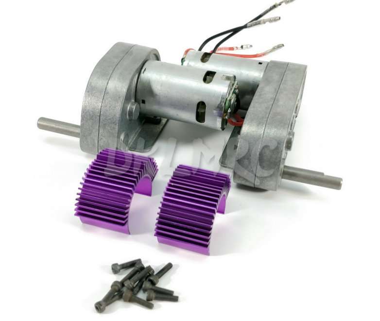

                                        There are no "HL" 540/550 gearboxes that I am aware of. Hooben has a larger 550 or 775 gearbox as an option, but that one isn't sized for an 8mm shaft as far as I can tell. The normal Hooben CNC gearbox has a 380 on it I believe. I posed that question to Hooben and got no response. The HL CNC gearbox also uses a 380 sized motor and I can verify that as I own like 4 sets of those CNC gearboxes. The ones I'm using were bought through Hobby Raw years ago, but they are the same type that DKLM RC uses in their version of the Leo 2A6 metal hull and their Chally metal hull. Kinda looks like they are not selling the Chally version anymore as it's not on their site anymore. I think the actual manufacturer of these 550 gearboxes is probably Canshuo hence the CS in the name below.
                                        Made by cast aluminum alloy, reliable and durable! full set included; 1. Cast aluminum alloy metal chassis. 2. Cast aluminum alloy rear plate. 3. Metal swing arm with torsion bar suspension. 4. Dual 550 4:1 sealed steel gearbox. 5. Sprocket shaft bearing included. 6. Hull mounting plate. 7. Metal idler and New Metal Sprocket wheels with track guide. 8. Metal road wheels with bearing (5mm holes). rubber tires and wheel caps 9. Metal track return wheels. 10. A pair of Metal track with slot-in replaceable rubber pad. 11. Included LEDs for lower hulls . Set hull will prefect fit for HL upper hull as well as Tamiya Leo2 upper hull (need to slightly modification, prefect for scratch builds too. Lead-time : ship next day if we have stock, 1-2 weeks without stock. Weight : 6.5KG Tank board which can drive this dual gear-box without issues 1. SLU Sound Board with The latest SLU ESC 2. Elmod Fusion Pro with 20A fuse (Elmod mentioned 10A fuse work fine) 3. IBU2 Pro is working fine on the Gearb...
                                        • keilau
                                          • Mar 2021
                                          • 1815
                                          • Windy City
                                          #40
                                          This is the Heng Long gearbox available from Toucan Hobby.
                                          Henglong ML49mm ML59mm Steel Gearbox 1/39 or 1/56 Gear Ratio for 1/16 – TOUCAN RC HOBBY (toucanhobby.com)
                                          Unfortunately, no spec for the motors.
