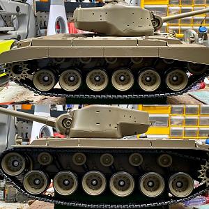

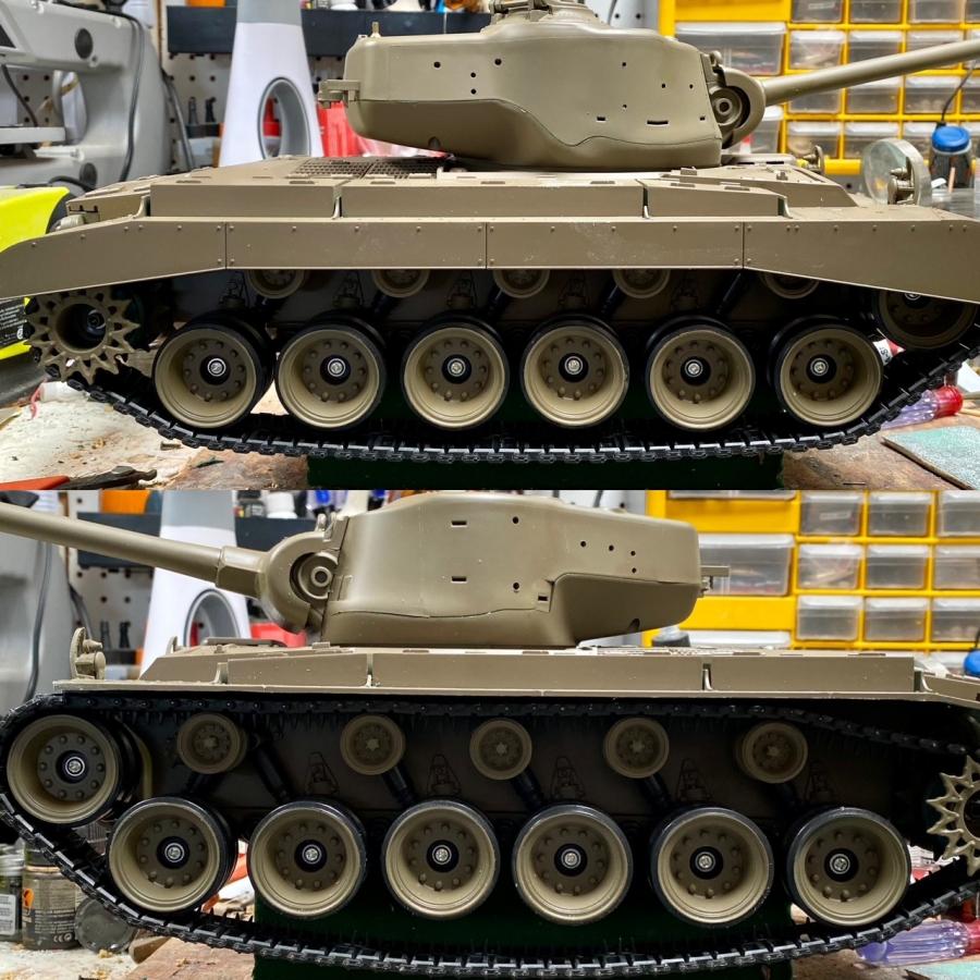

    Good start. I removed the skirts on my old HL Pershing and it made a huge difference in improving the looks.
    Since you are building it, I would recommend getting the metal road wheels, suspension arms and metal sprockets. But keep the plastic idler wheels. The metal idler wheels like to cause de-tracking issues when the tank is driven in reverse. A note: Almost all of the suspension components and road wheels are interchangeable with your M41. HL just reused the parts from the M41 when they made the M26.
    Here is some other anecdotal information:
    The M41 tracks and sprockets will work on the M26 and vis versa. Though you would have to add links to the M41 tracks and take a few from the M26 to do the swap, super easy.
    The M26 and M41 can both use the Abrams sprockets with Abrams/Leopard 2 tracks. They can also use T72/90 tracks in combination with the M26 sprockets.
    The best “classic” look M26 aftermarket tracks to use are Tamiya M26 tracks followed by Mato all metal M26 tracks. On my old HL Pershing I used ALL the above combinations and they all worked great.

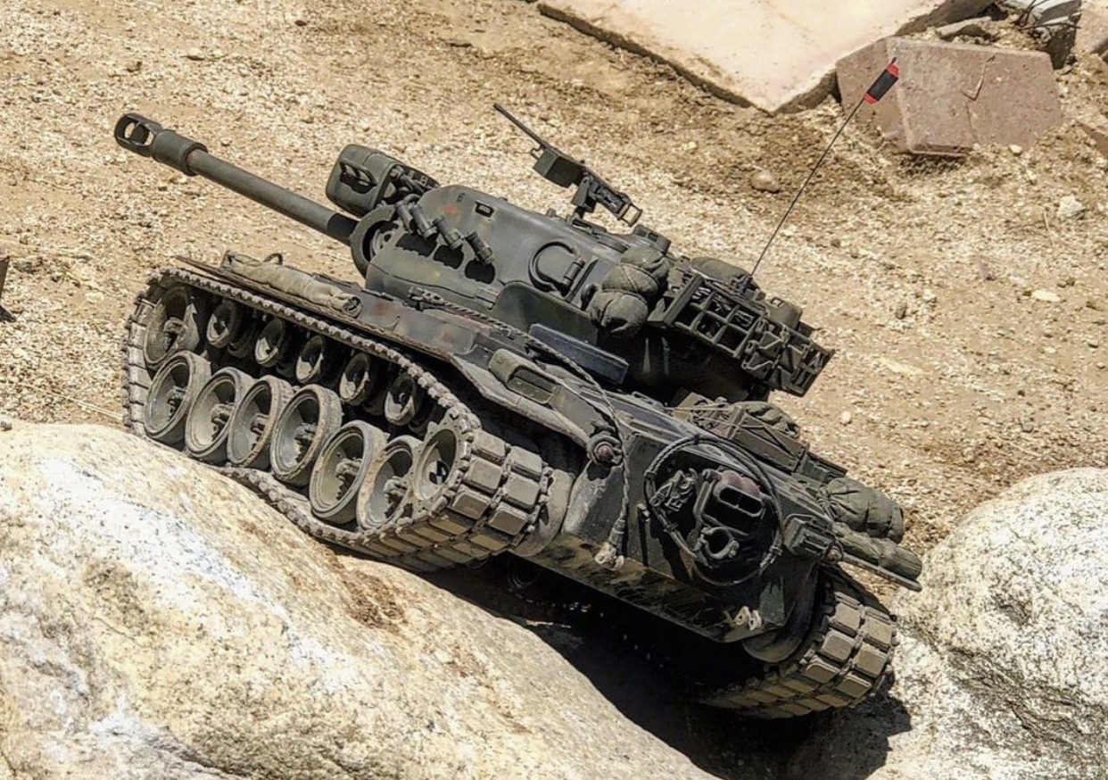

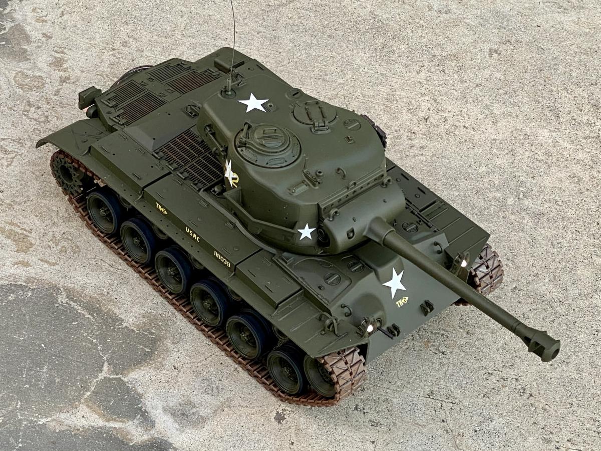

    My old HL M26 in early/mid 1960s Italian Army reserve/training unit scheme...kind of, about, close enough LoL
    Click image for larger version  Name:	7EACB611-2EDE-4FC8-B4B2-D693A6EF9DB9.jpeg Views:	0 Size:	222.8 KB ID:	306393
    Shown below with Abrams tracks and sprockets.
    Click image for larger version  Name:	2FFFC43A-6296-4D77-A572-6AAF54DF8A78.jpeg Views:	0 Size:	381.6 KB ID:	306394

            The Henglong Pershing is a great model with so much potential and it performs well. I built one for a customer by upgrading it with a Tamiya barrel since the henglong was cut short to fit in its box.
            I also found that the tank could use some added ballast weight to make it perform just a bit better since it’s so light for its size.
            ive drivin my Tamiya chassis that is becoming my M47, around a bit and found it performed quite like that henglong I built.

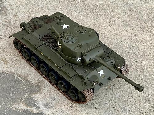

              Ok, tank is re-wired for 6.0 except for putting an IR bulb in the barrel.
              Now I have to put on the necessary separate parts before a first paint coat. There are more holes in the upper hull than in swiss cheese. I can guess where most parts go by matching them to the size and configuration of the holes and pictures on the internet, but that's like doing a jigsaw puzzle with only tiny internet photos to go by! No instructions in these static kits.

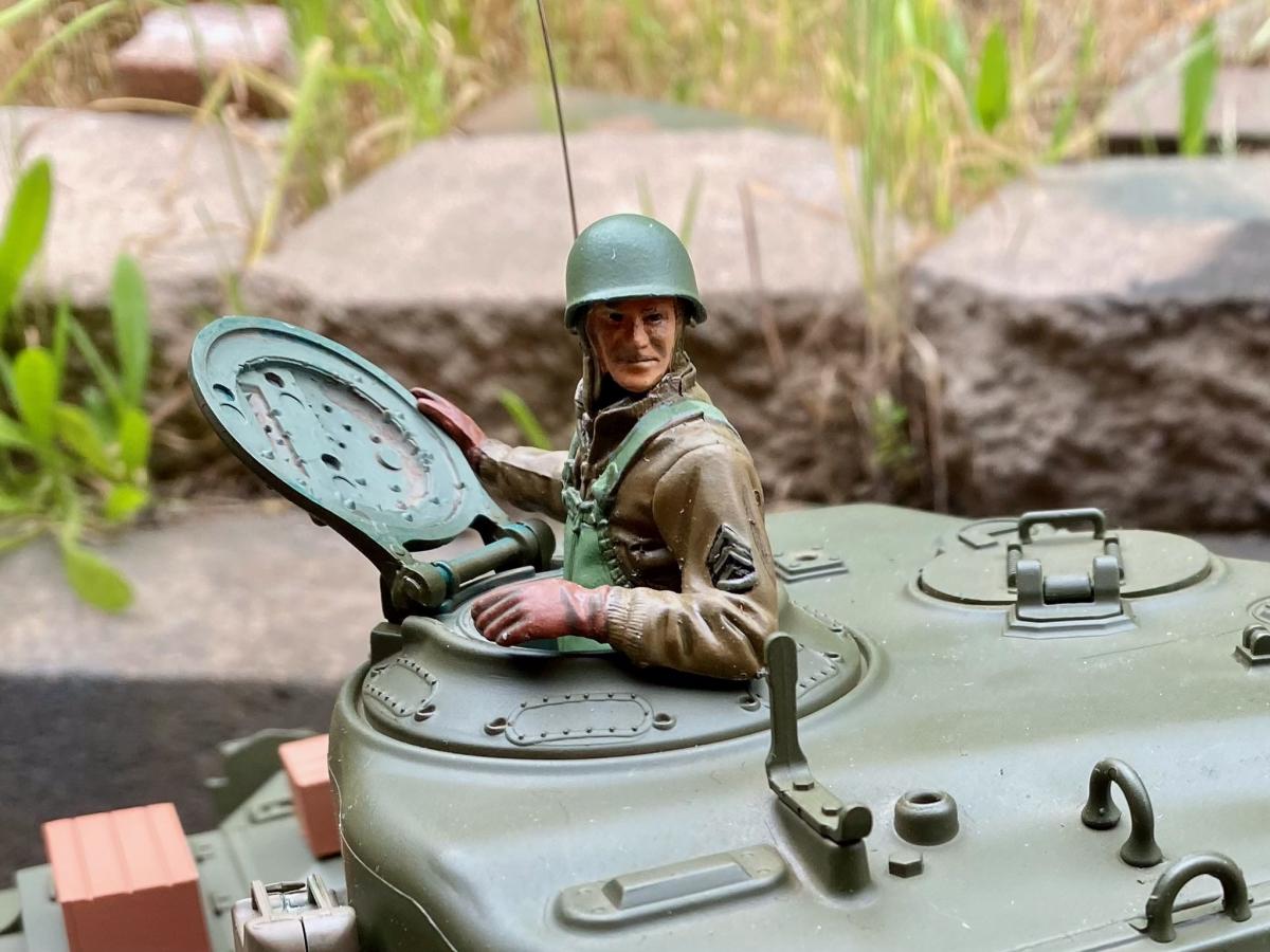

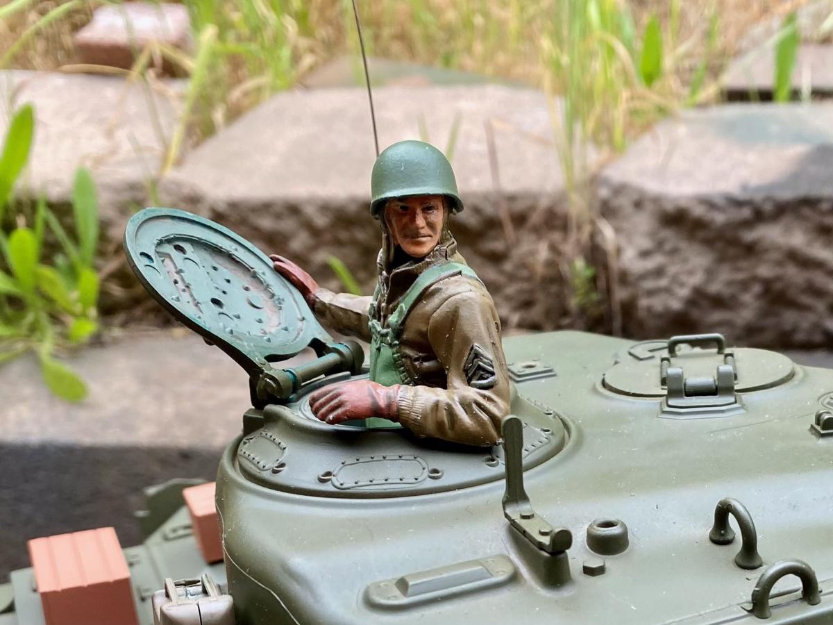

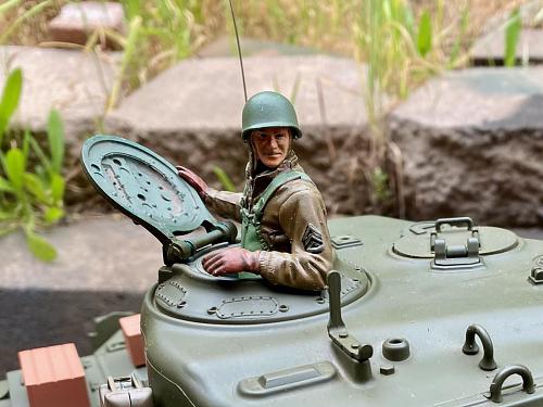

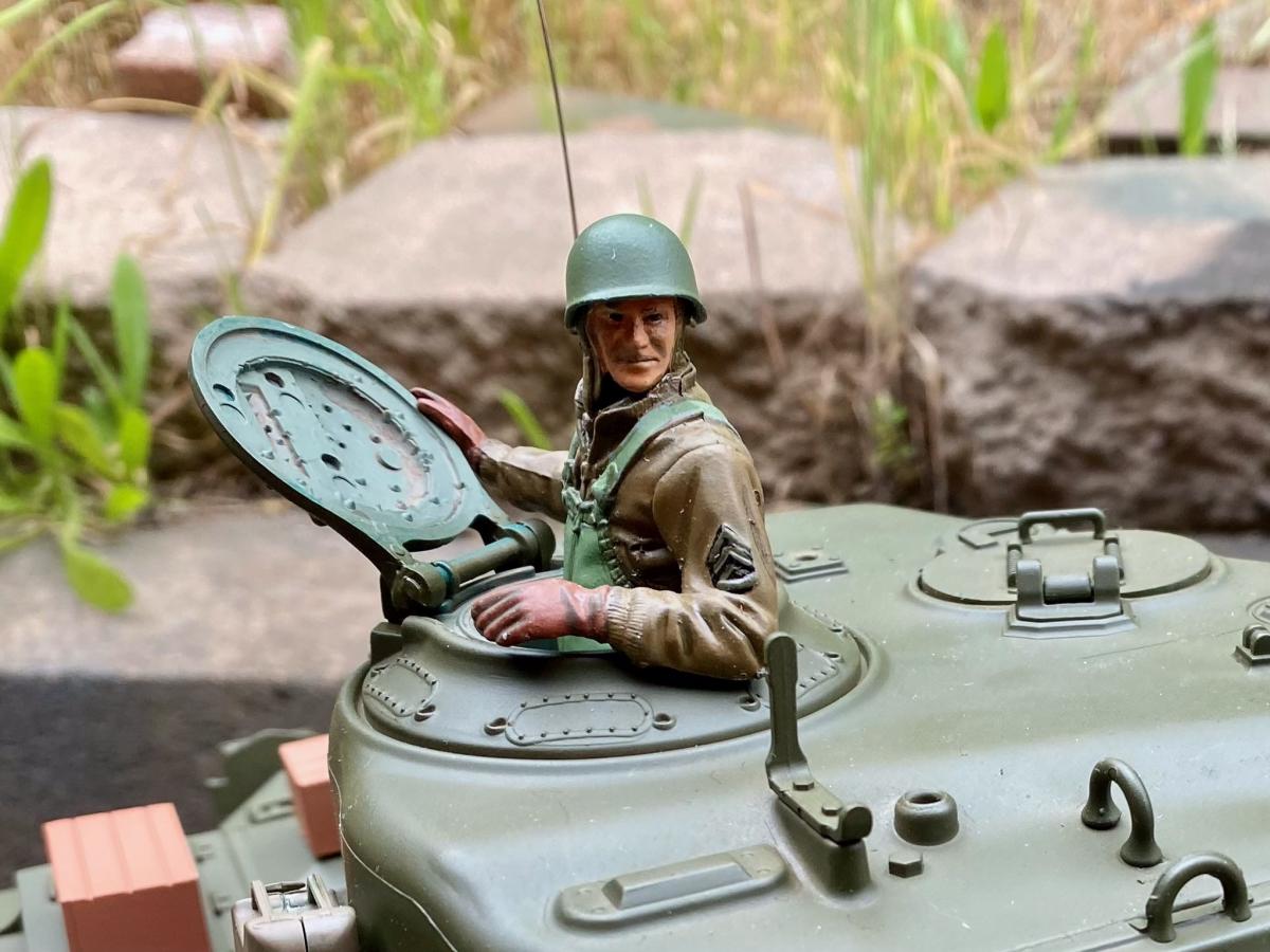

                    Finally figured where the tank commander that HL includes in their US tanks come from. It’s an unusual pose, or was until I got an M26 Pershing. One hand on the hatch sill, one holding the hatch. Now if I was a suspicious type, I might think it was cloned from the Tamiya M26!

                      I noticed that also when I got my Pershing.
                      Wasn't sure what that guy was supposed to be doing at first. Throwing a grenade maybe??
                      HL stuff is almost all copied from Tamiya including the soldier offering the dog a treat on the Stug.
                      I don't mind at all considering the price difference.

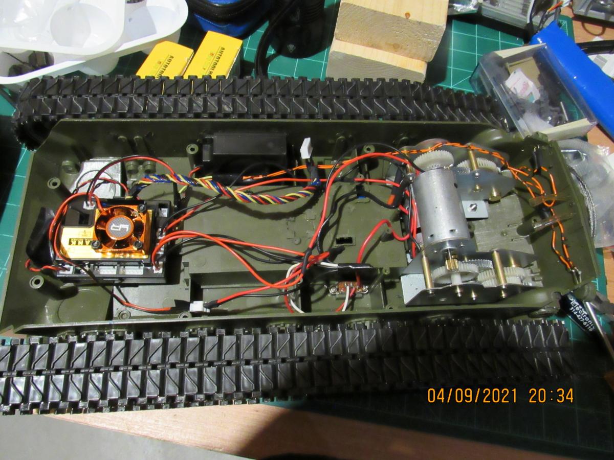

                        My 2005 vantage Pershing Henglong is VIP. Version 5.3 control works amazingly well. The driving experience is world ahead of the original 27 MHz RC. Metal gearbox and track kept breaking down and is waiting for the bearing version of gearbox and 390 motor.
                        My first metal gear set was from Tamtoys.de. It was casted oversized and cannot fit the Henglong gearbox frame. The Mato metal gear and track can run, but I will pick up several track endcap around the basement every time. Some of the metal endcap were broken when fell off. I am considering using the plastic track endcap on the Mato track. (Anyone had tried that?) I kept the plastic idle wheels, but it did not help very much. I suspect that the normal version (non-bearing) gearbox has too much vibration that contributed to the Mato track problem.
                        I have to move the TK5.3 to the front because nowhere else has enough vertical room. The speaker is half the frame of the new speaker which is much smaller than the original.

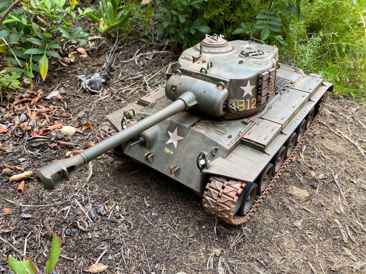

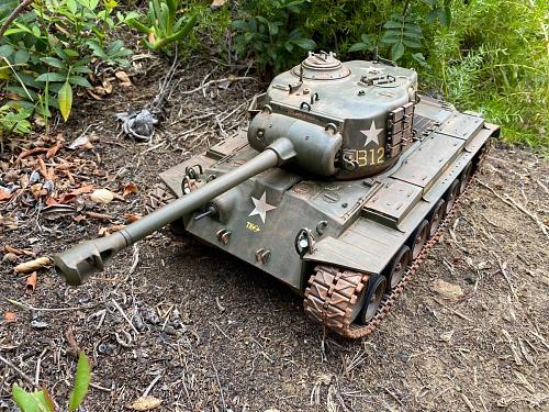

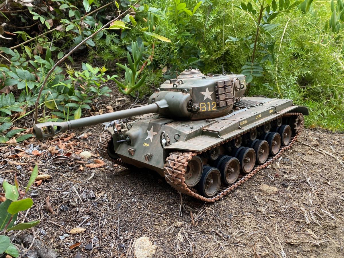

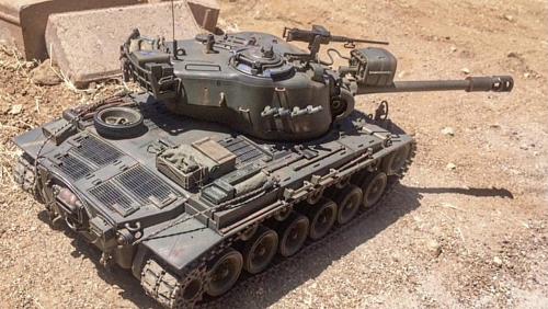

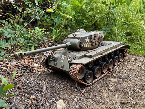

                          Progress: static kit from Toucan, MFU 6.0 and IR LED circuits and a speaker added, decals from Archer Fine Transfers. Korea? Vietnam? Still needs some toning of the weathering and the addition of stores carried externally - boxes, tarps, etc.
                          Better than this, anyway!
                          Twenty six tanks, and not done yet!

                            Dang that looks GREAT!!! It is amazing what a little tweaking here and there, good paint and weathering work can do to improve a model.👍👍👍👍
                            • #15
                              Nice work Bob!
                              Steve
                              • #16
                                Great work again! You really mastered the weathering without overdoing it. The Pershing looks particularly realistic!
                                • #17

                                    Thanks guys! It actually is the “dirtiest” tank I’ve done. Grime and dust, those are unavoidable in the field, but mud and caked dirt? No tank crew would allow that to accumulate if they could help it. No “mud wallow” for me! Internet photos have become invaluable for looking at the conditions tanks are in while in the field. In this case, driving down a red dirt road for a couple of hours will cover a tank, especially if it isn’t the front of the convoy!
