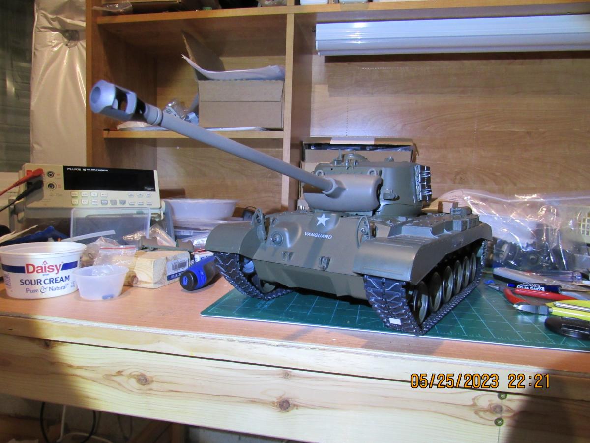

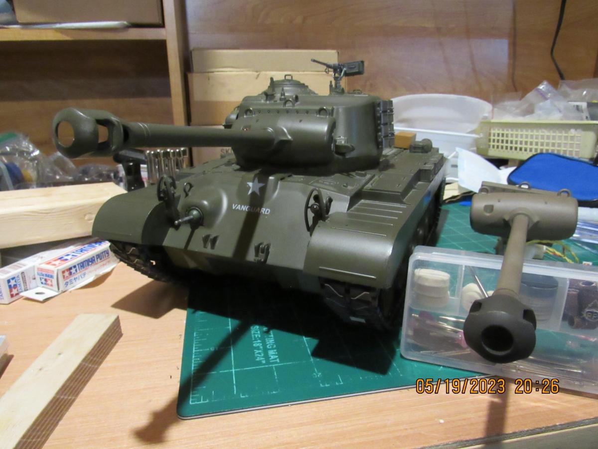

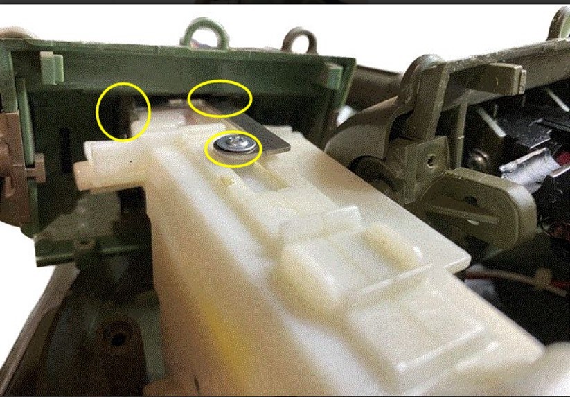

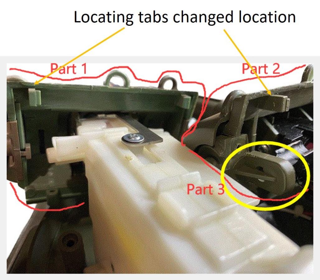

                    My latest upgrade on the historic 2005 HL Pershing is the HL metal barrel recoil BB shooting unit.
                    A few days ago, I posted on a Heng Long Metal Barrel Recoil BB shooting unit for 3838 Pershing upgrade kit that I purchased for my 2005 Snow Leopard. I said that over 18 years, HL changed the cannon mantle mounting plate enough that the kit does not fit my Pershing. I contact the Toucan seller (build-for-u) to request a return. They got back to me in a few days after talking to the HL technical team. They came up with the idea of swapping the old mounting plate to the new unit. It works, but it is not a simple direct drop-in replacement. It took me 2 days of careful griding and cutting. .
                    The Metal Barrel Recoil BB shooting unit works with TK-6.0/7.0 without any electrical modification. Just connect the recoil motor to CN6. I have upgraded the Pershing with a TK-6.0S MB which works together very well.
ID:	378855Click image for larger version
                    If you have a very old Pershing like I do, the upgrade is not recommended because it requires too many try and fit steps. If you have a newer version of Pershing, the "metal barrel recoil BB shooting unit" kit should fit as is and is highly recommended.​ You can see that the upgraded tank has the longer, more correct barrel.

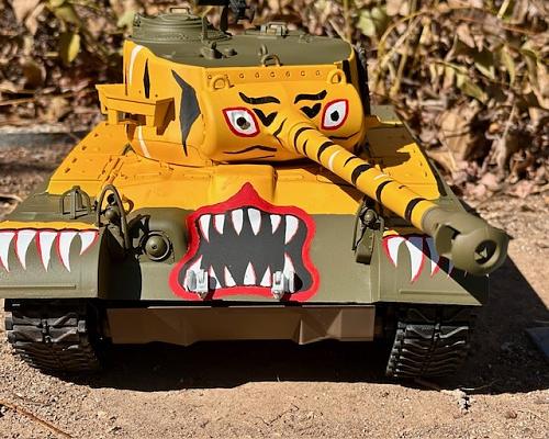

                    • #50
                      Working on another Pershing myself....I did a respray with Tamiya XF-62, going for early Korean war era. Normally I would cut off the fenders as I like the look a lot better, but this is going to be more of a "loaner" tank for my small tank club here in FL, so decided to keep things simple. Also blacked the metal tracks with Birchwood Casey "Brass Black" (my favorite method), followed by a rust wash and then sealed with dullcoat. I let the tracks wear naturally after that and I htink it gives a pretty realistic look without going overboard and it's a very easy process.

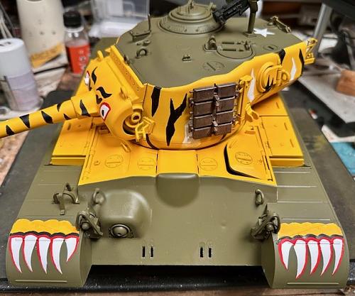

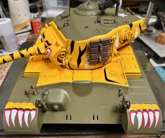

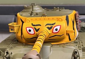

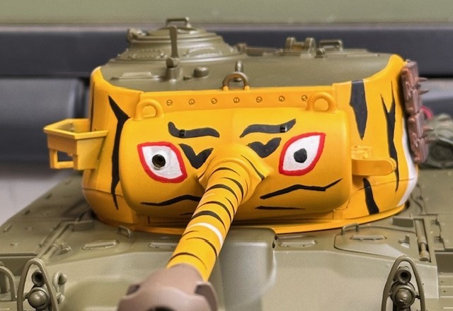

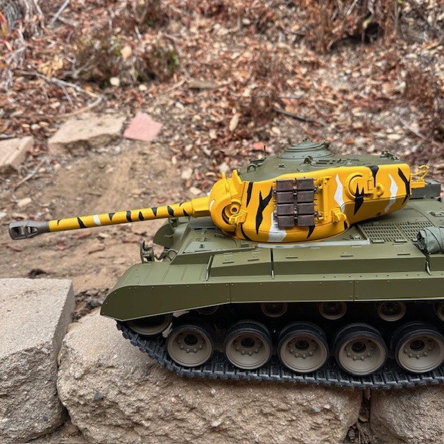

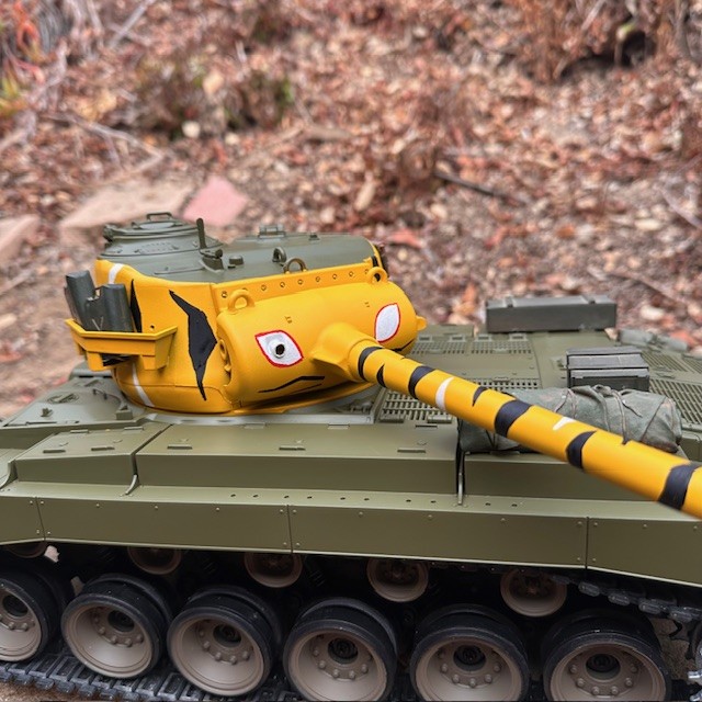

                        A new Pershing project. The turret is 90 percent painted, next will be the hull. Painting straight lines on complex curved surfaces is taxing!
                        Click image for larger version  Name:	IMG_1744.jpg Views:	0 Size:	153.1 KB ID:	417082 Click image for larger version  Name:	IMG_1745.jpg Views:	0 Size:	115.4 KB ID:	417083 Click image for larger version  Name:	M26 Tiger Face 05.jpg Views:	0 Size:	164.0 KB ID:	417084
                        The side skirts are staying on this one (probably) because most of the images I used for resources have them. As far as the stripe pattern, since the real tanks were field painted, I feel free to make my own interpretation.
                        A side point though. Since this was intended to be primarily an art project, I bought the Heng Long version with plastic suspension, except for the sprocket and tracks. Mistake! There are no bearings or even bushings at all. I'll have to add them on at more expense than buying them as part of the kit if I intend to run this one at battles...which I will!
                        Edit: After looking at my photos, I decided the face needed to be more pronounced.

                        • #52
                          That's a tough one to follow. Great work as always Mr B can't wait to see the finished product.
                          • #53
                            Looks great. My non-airbrush art skills would be lacking doing something like this. It's sad because my Grandmother was a great artist. I guess that didn't get passed down... :)
                            • #54
                              a suggestion, get a cheapo laser level and stick it above your bench/workpiece and project the line on your tank where you want the paint line, should be a good guide regardless of the surface curves
                              • #55

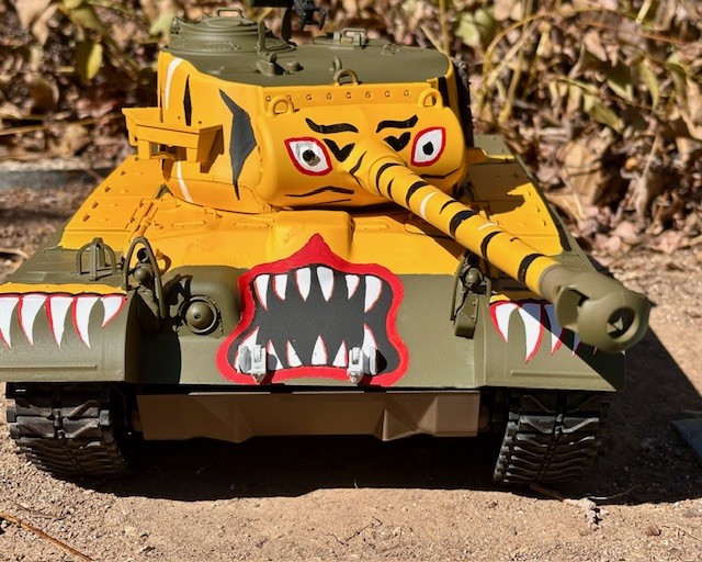

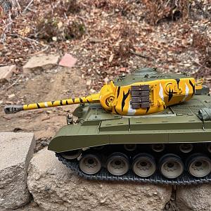

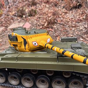

                                Claws, but no teeth yet:
                                • #56
                                  Progress photo: teeth!
