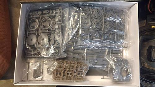

    THIS Click image for larger version
Name:	Panzer 1B 01.jpg
ID:	310648 PLUS THIS Click image for larger version
Name:	Panzer 1B 02.jpg
    EQUALS ?

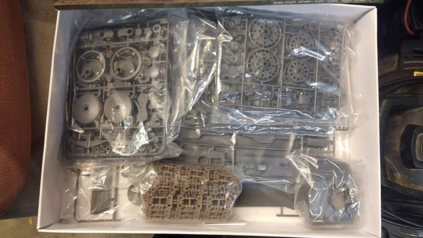

                So I was mistaken as to what I had bought. Here is the Panzer 38T aka Panzer 2 I have with the RC kit. Its quite a cool thing I just dont think I will ever get to it since I have no interest in German tanks.
ID:	310782Click image for larger version
ID:	310783Click image for larger version
ID:	310785Click image for larger version

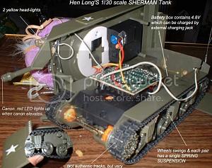

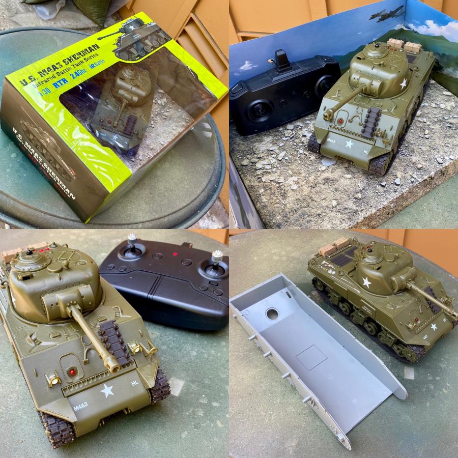

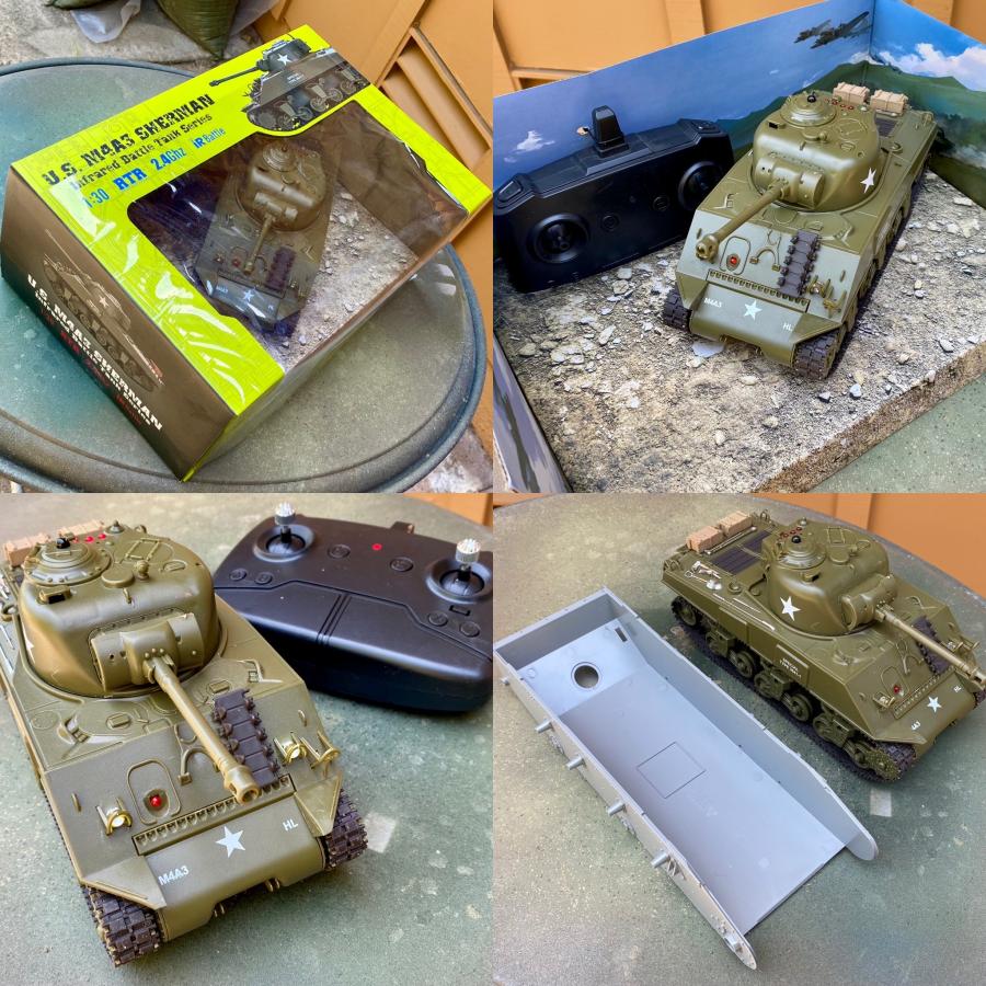

                        Now the gamble begins...again, as with my M3 Lee build, I'm trying to use inexpensive components. I don't intend for this tank to rumble with the big boys in the sand. So, I bought a Heng Long RTR 1:30 M4 Sherman. For $50 bucks you get motors, sound, radio control, lights, etc. They're sorta cute, kind of a shame to dismember it for this project. maybe I can take it apart in such a way that I can reassemble it if it proves unsuitable for the PzKfw 1.
                        I haven't opened up the shell yet, but it looks like it's screwed together, like 1:16 but smaller.
                        For those unfamiliar with this tank (I was), here's a photo; packaged, opened, activated and next to the P1 tub. The transmitter is 2.4ghz. On/off switch, tank start switch, two buttons on top for MG and main gun. Four red lights on top to register hits, a half buried IR receiver on the hatch, a red hull MG light, headlights. Sound is similar to 1:16 but tinnier of course. Turret traverses but barrel doesn't elevate. 3 AA batteries for the Tx, a 1 cell lithium battery and a USB charger for it.
                        Control is Mode 1, Tamiya style. I'll be opening it up in the next day or so.

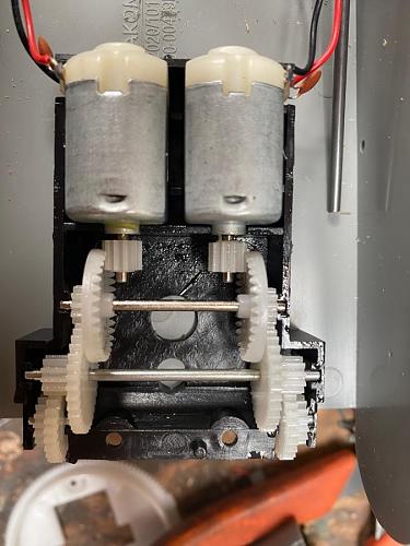

                            Temptation? Gratification? Zero time interval!

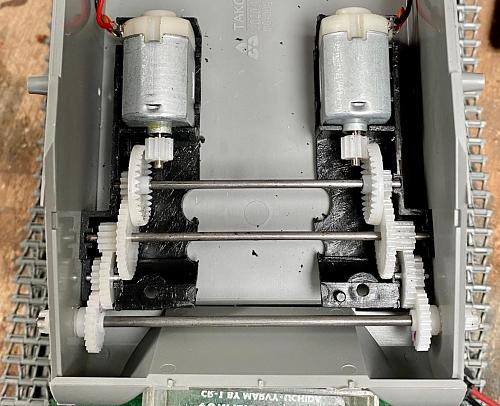

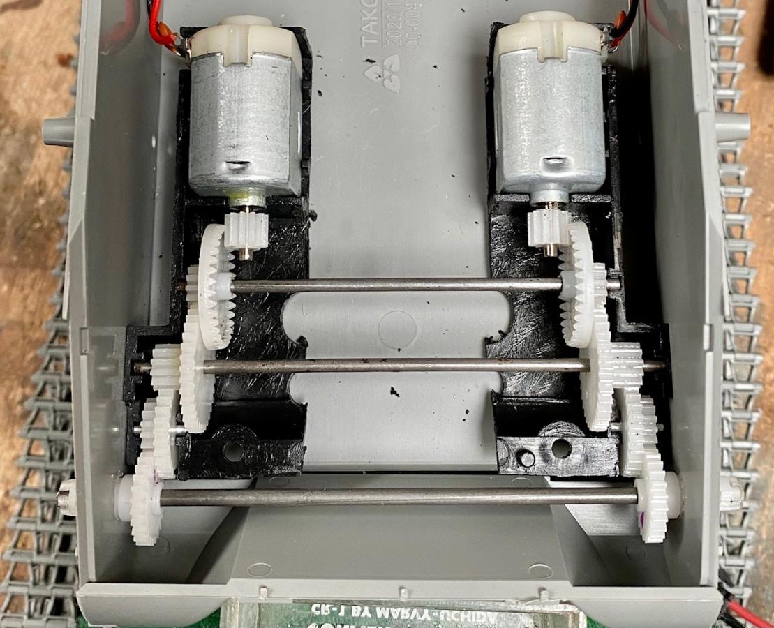

                            I opened up the Sherman. There's a lot of potential there! Upper left shows the setup. gearbox in front MFU on top of it, turret gear and motor, and speaker in the rear. Upper right shows the gearbox and front axle. The axle is stationary, the left and right gears rotate freely on the axle, and the sprocket press fits on the gear. Lower left shows the turret rotation motor and gear. Lower right shows the various plugins; power, motors, lights, sound, and IR.
                            I'll need a longer front axle, and keepers for the gears to mesh. The turret gear is precisely the diameter of the turret ring, but it will need a standoff to align with the pinion gear. Pictures as this progresses.

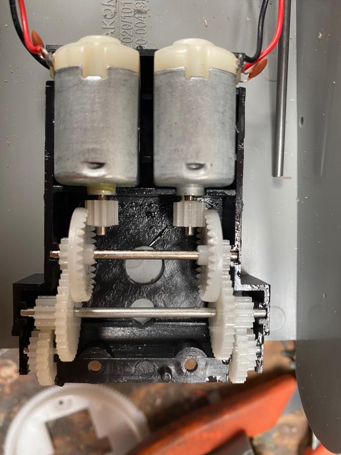

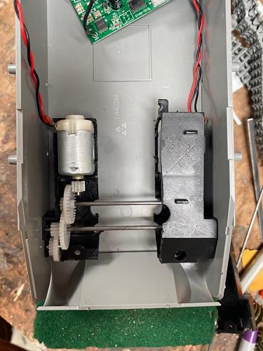

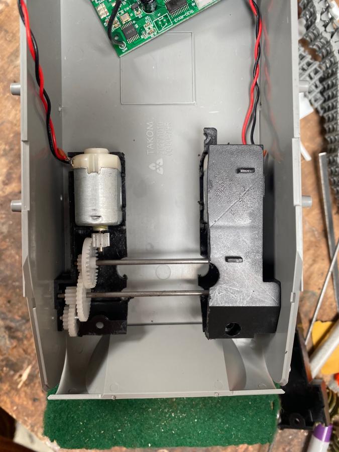

                                Always something. On post #14, you see on the upper right corner the HL gearbox; solid axle, free turning gears with the last two fitting into the transmission humps on the hull. The 1B has the same set of humps, but farther apart! If I were to leave the gear trains intact, the last two would not fit into the hull front. I thought I was stumped, but tried an experiment. I cut the transmission in halves, and made longer axles out of 2mm metal stock. It works!
                                Here's the gearbox with the top off.
Name:	Panzer 1B 04.jpg
                                Here's the gearbox split in half. One side has the top on. there may need to be some more trimming, but that's for later.
Name:	Panzer 1B 03.jpg

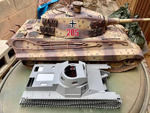

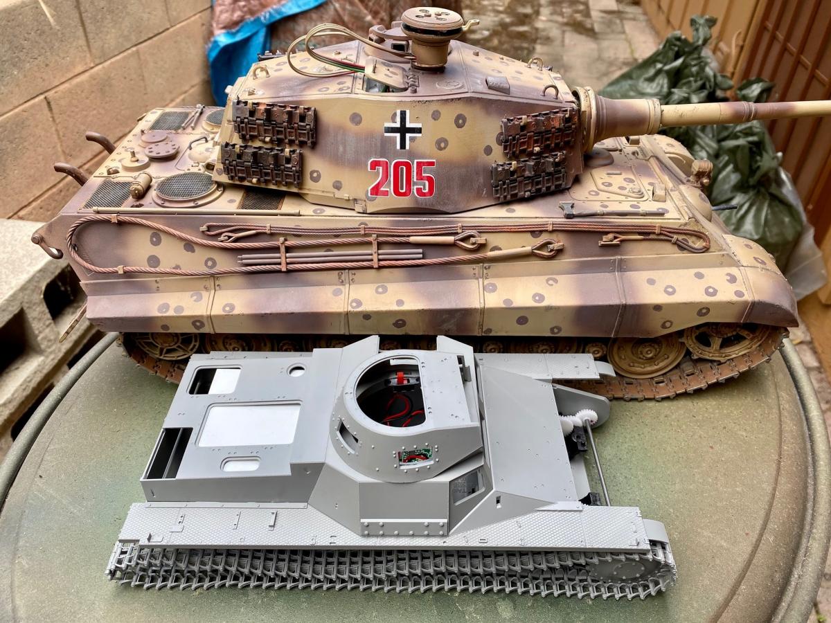

                                    Wall to wall inside is 7.7cm. Total length of the tub is 27.4cm. Tub floor to deck level is 4cm. However, the critical limitation is the front (transmission) wall. There wouldn't be enough clearance I believe and the front glacis will be very close to the gearboxes. Also, this is a 3.7 volt system, so it'd be hard to mix 1:16 and 1:30 components.

                                      In a project like this, I do a lot of dry-fitting. One has to, to figure out what fits. This dry-fit is just for fun though!

                                      • UltraVargen
                                        Dutchie
                                        • 266
                                        • The Netherlands
                                        #20
                                        That's not that much smaller than the Panzer III. I was thinking maybe 1/16 size motors would fit, but using the 1/30 size gears. Use most of the rest of the 1/16 electronics.
                                        Might be overkill though, as I assume the kit is made of styrene, so more fragile than the 1/16 tanks.
