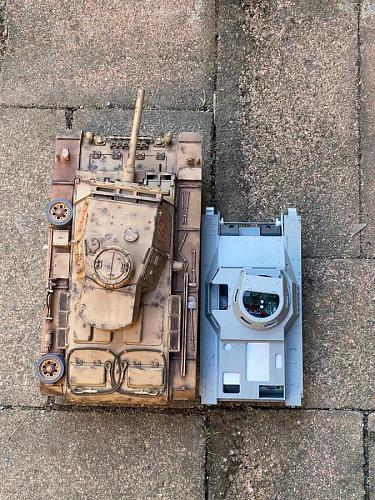

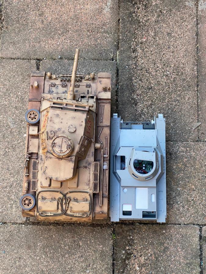

    The perspective on that last photo may have been misleading. Here is a side by side with a Panzer III.
    And yes, it's fragile. A build thread on RC Tank Warfare shows almost all moving parts upgraded to metal. I don't expect to do all that, for me this is a limited exercise using specific resources. Practice for the Holy Grail, a 3D printed Russian T-35 tank!

      Ah ok, now it does look like quite the difference in size. Not much room there for "big" electronics.
      That T-35 is not my cup of tea (too utilitarian, not enough aesthetics). But it must be a very cool project to do!

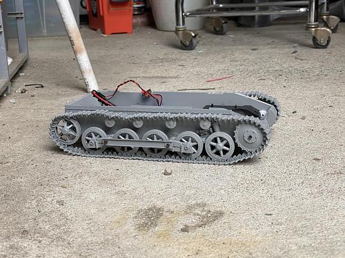

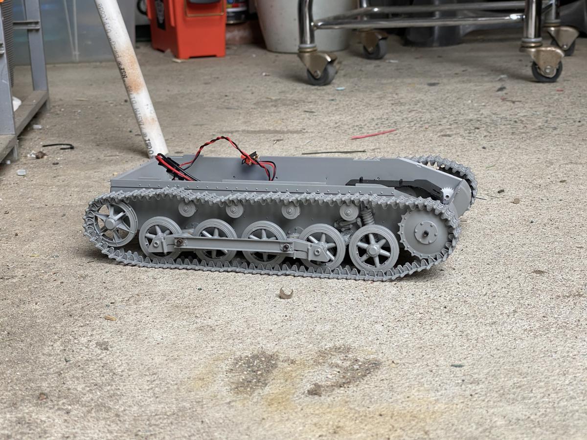

        Phase One success!
        I've adapted the HL 1:30 electronics and mechanics to the running gear. Still some tweaking to do, but here's proof it runs! 97 track individual track links and pins on each side, lots of brass tubing for bushings, almost every tool I own, and nuts and bolts accumulated over 30 years of r/c flying, building and repairing. I grabbed hints and tips from a comprehensive build thread on RC Tank Warfare, without which I would have despaired. I've managed to make nearly everything removable, for maintenance, repairs and upgrading. I've already removed two links on each side because the plastic skeleton tracks are stretching with use. I do have some metal tracks enroute from China.

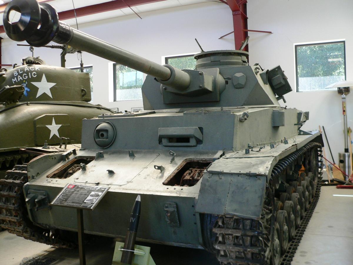

                So why am I doing this project? Nostalgia. Here's a Panzer 1A at the now defunct Military vehicle Technology Foundation museum in San Jose, California, with a figure (me) for scale! 😉
                Click image for larger version  Name:	Panzer 1 02.JPG Views:	0 Size:	135.7 KB ID:	312430
                Speaking of us nerds, any error stand out? skcart era no sdrawkcab, at least from period pictures of the real ones.
                So, what's next to it on the left and right?

                  Nice work on your project!
                  Panzer IV on the left(?) and a Matilda on the right.

                    Excellent, right both times - the Matilda is easy, I mean light blue? The Panzer 4 was harder.
Name:	Panzer IV 03.JPG
                    • Barmonkey
                      • May 2021
                      • 54
                      • USA
                      #30
                      Hey...First post and I am a winner!!! What can I say. The only clue I had for the Panzer IV was the triangle support piece on the fender. I recently built a 1/35 Tamiya PzIV...

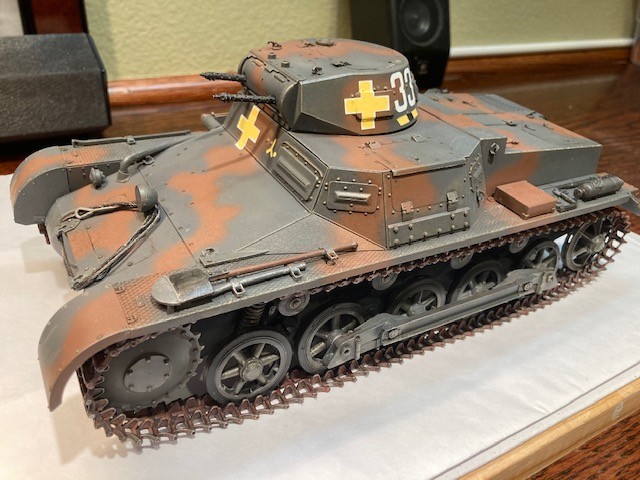

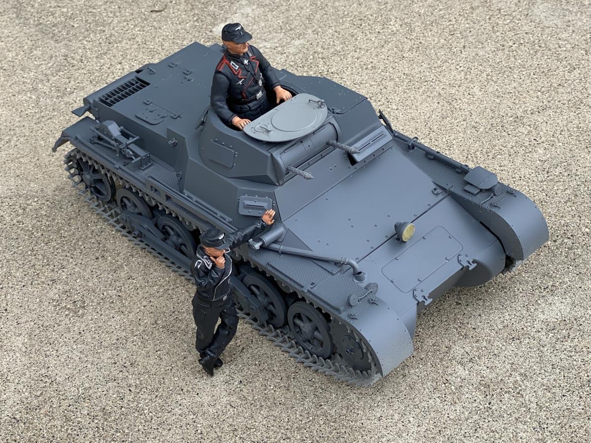

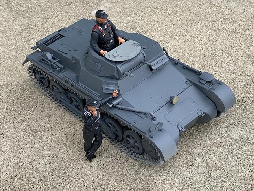

                        Another progress snippet. In this, it's painted and decaled, no turret or weathering yet. It drives like a 27mhz 1:16 scale HL tank, quick and jerky! Most of that is due to the large sprocket wheel mated to the 1:30 scale Sherman gearbox.

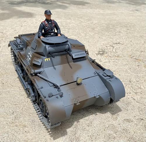

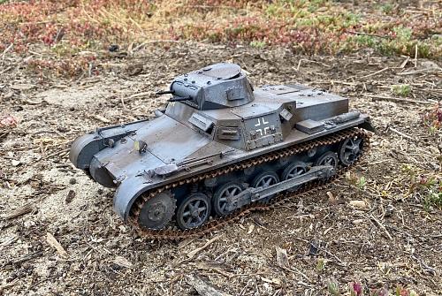

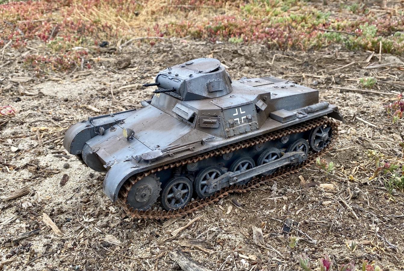

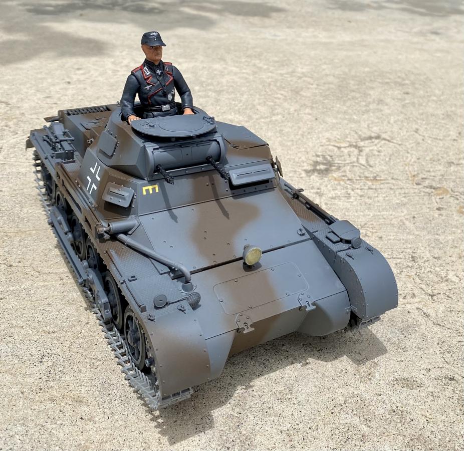

                            Final test; painted, weathered, running on dirt & sand.
                            I like the Heng Long electronics, the weakest part was the transmission from the gearbox to the sprocket wheels. The wheels kept slipping. Took some glueing. A lock washer would have been the best solution, but I didn't know that until after it was all assembled. Still, it runs fine. Could be slower though. The plastic individual link tracks and plastic link pins are holding up better than I'd hoped.

                                #35
                                I am taking my hat off to you. I have the same tank too. It took me quite a long time to link those tracks together and they were so thin and fragile. I broke about 20 of those pins. I was amazed how you could have it rolling with those pins holding those tracks. I just have mine on display for now :-)

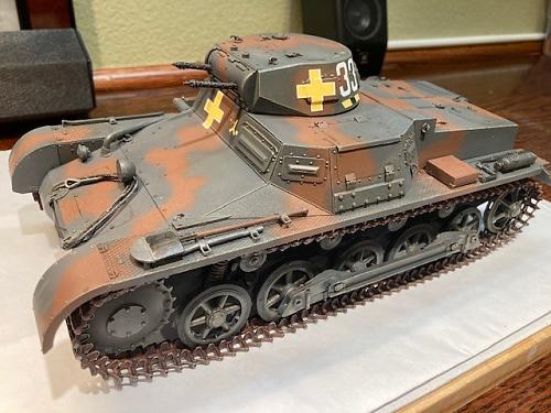

                                  Nice paint job! Regarding the pins, after breaking a few putting them in I found a trick. I used a hobby t-pin which was the same thickness as the pins, inserted it in the links to align them, then took the pin out carefully so the holes stayed aligned. The plastic pins slipped easily.
                                  None have broken in use, but I’m keeping spares around just in case!
