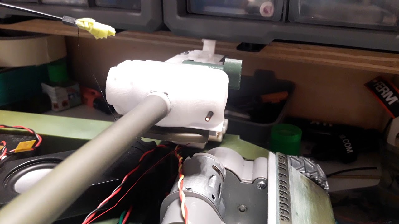

                  A little more done, all the little jobs that need doing and I've been putting off...
                  Getting the IR transmitter back into the mantlet. Space is tight, so I decided to put it above the post that holds the shield to the mantlet. Elevation of the gun is just allowing me to use the same slot as the post...
                  Connector for the little IR mushroom got moved to the commander's hatch. Not the neatest job I've ever done, but I'll tidy that up later.
                  A video on Youtube showed someone who made the spotlight work, and used the WiFi 6volt power to switch it on and off remotely. So... why not?
                  Now, today's Grand Prize Question; where does this go? I found it after disassembling the gun, and I found it on a few sites listed as "Heng Long Sparepart rubber for shooting unit sparepart"... but where does it go?

                    Its the hop-up bucking for the airsoft unit/barrel It keeps the bb from just falling out the barrel and provides the airseal around the bb so air doesnt just blow past it. In a more sophisticated or dedicated airsoft application it would also provide a backspin on the bb for longer range. You know, its been a while since Ive had a unit apart without binning everything inside it, but it goes at the end of the barrel inside the airsoft mechbox...

                      #70
                      Weeeeelll.... I think I have figured it out, with the viewing of about 30 videos on Youtube on the subject, with 1 (One) delivering a smidgen of useful info.
                      It goes like this... (excuse my awesome MS Paint skills...)
                      In this cross-section, the orange bit is a small plastic barrel which grabs the main aluminium barrel. At the back side there is a little lip that stops the ring/gasket (in red on the drawing) from sliding further back. The barrel should only barely touch the gasket. So it goes in about 10mm.
                      Which means the rear end of my Firefly barrel needs to be shorter... and the part where is gets fatter needs to be cut as well. Oh joy... machining without a lathe...

                          A deep breath, a really fine but sharp razor saw and a short prayer later...
                          First shifting the thick end up (as it turns out) 3.5mm. Slow cuts along the thin end of the barrel into the thick end, which I already scored all the way round at the right spot. So it's cut from the back, cut from the top, cut from the back again... until I was almost all the way around, and then a very fine keymaker's file did the rest.
                          The thin end that goes into the airsoft mech box I shortened in stages. Cut and sand, re-assemble, test fire, disassemble, cut again, re-assemble, test fire.
                          Did that until the gun fired fine, except by now the gasket had gotten a small tear and I was losing some power. But new gaskets have been ordered, and I probably need to fatten up the thin section juuuuust a tiny bit to make it more snug. That I will do with layers of CA, but only when the gasket is replaced.
                          But there is hope...
