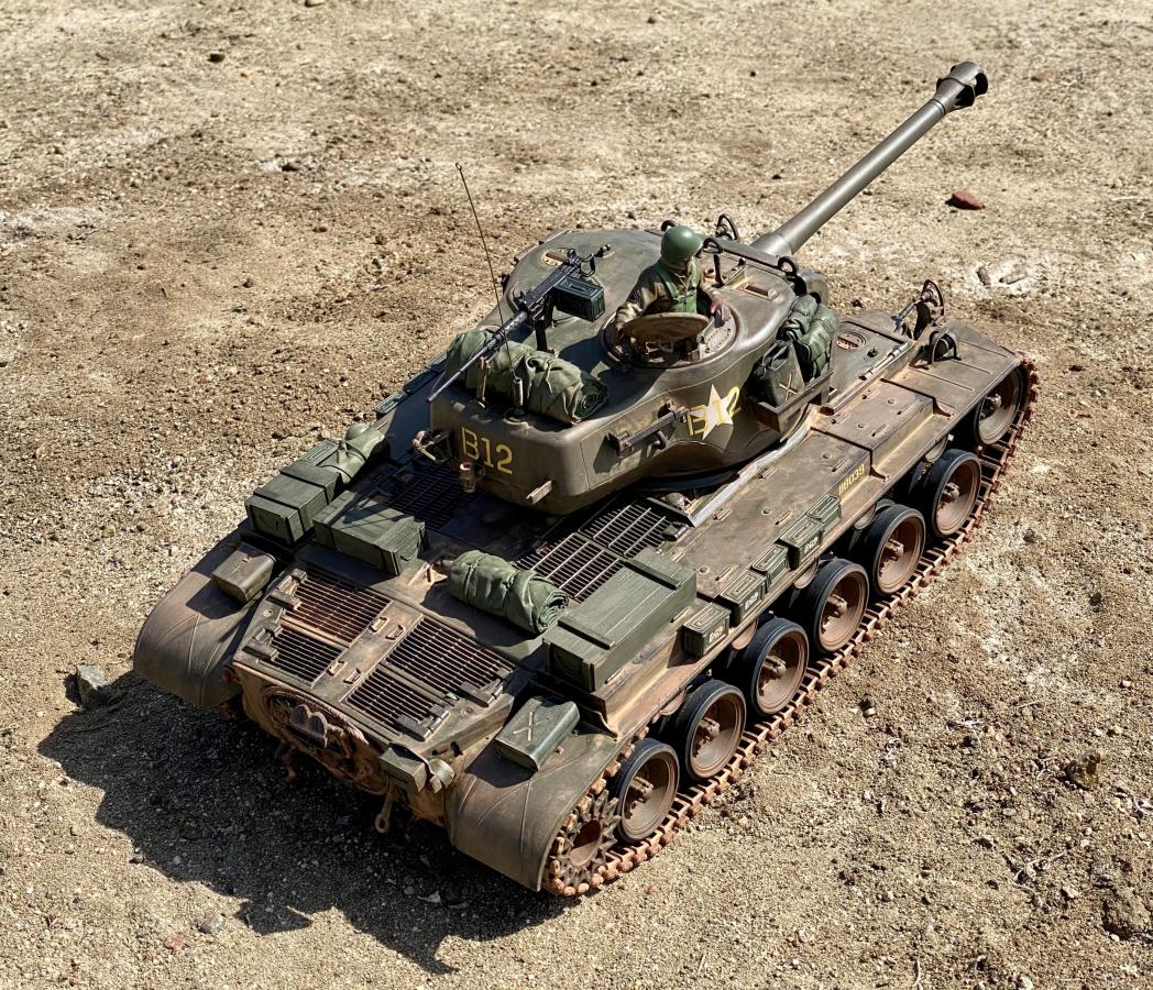

                    I've decided to enter the M4A3 into the Tank Of The Month competition over at rctankwarfare.co.uk, and I'd appreciate your vote (if you think I deserve it ofcourse... ) so I took some glamour shots this moring. Win or lose, I'm pretty chuffed with the result either way.

                      #90
                      Great job on the grates!
