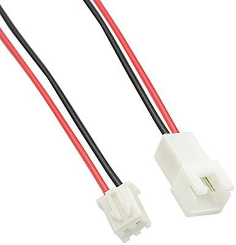

                        Congratulations on ordering right Panther! Interested to see what components yours has when you get it. My Panther G had a basic FM board with no sound, IR or smoke unit...very basic. The 6.0, 6.1 and 7.0 generations use a 2 pin JST XH connector for just about everything except for the motor connectors and LED lights. The 8-pin connector was eliminated. The turret rotation motor will plug right in to the newer boards. If using the older gearbox, you will need to replace the connectors with the Tamiya bullet connectors.
                        The biggest issue is with the BB unit and barrel elevation. For some reason, the older boards combined what is now two JST connectors into one three pin connector. This can be sorted out and made to work with some new JST connectors and some soldering. In my case I purchased a new 6.0 BB unit for my Panther. Since my Panther was so basic (and without sound) the BB unit did not have the little solenoid that triggers the gun sound. I could have added one, but did not know where to buy the solenoid in the USA. I soldered JST leads to the barrel elevation motor and all is well. Mostly, that is. My new BB unit may fire or spit two or three BBs out LOL...
                        • Barmonkey
                          • May 2021
                          • 54
                          • USA
                          The correct connectors are JST XH 2.54
                          Something like this

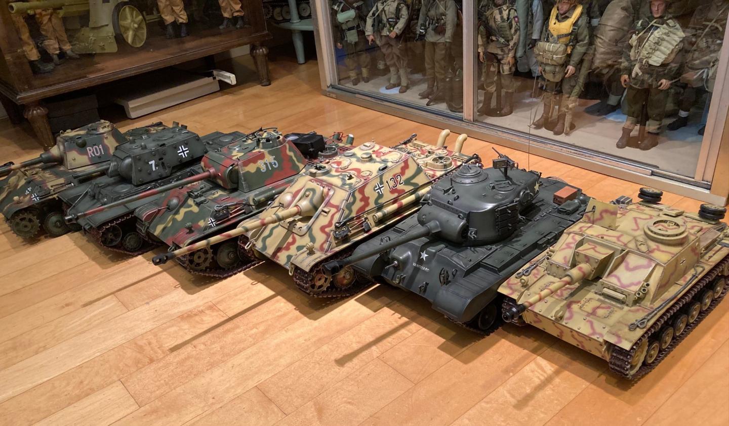

                                  #17
                                  A long line of static tanks that are in the need of the cable sets and speakers from China :-) The 6.0S main boards are already inside.

                                      My cables, speakers and wires arrived. I installed them from observing the other RTR tanks that I have. The binding process was simple. At this time, one of my static tanks is running. The headlights are on. The machine gun sound is on with red light flashing. The turret is turning and elevating. The gun fires. I took me three hours to get it done. I accidentally burned one main board by leaving the battery hooked in while connecting the wires and cables, but I am happy at this time. Thank you...Bob and Rubicon! So "thebates", if your tank already has the speaker and the zinc gearbox and you don't want to upgrade them, then it would cost you around $40. To change gearbox and speaker, another $40-$50. To have metal idler, sprocket and tracks, $100. And so on :-)
