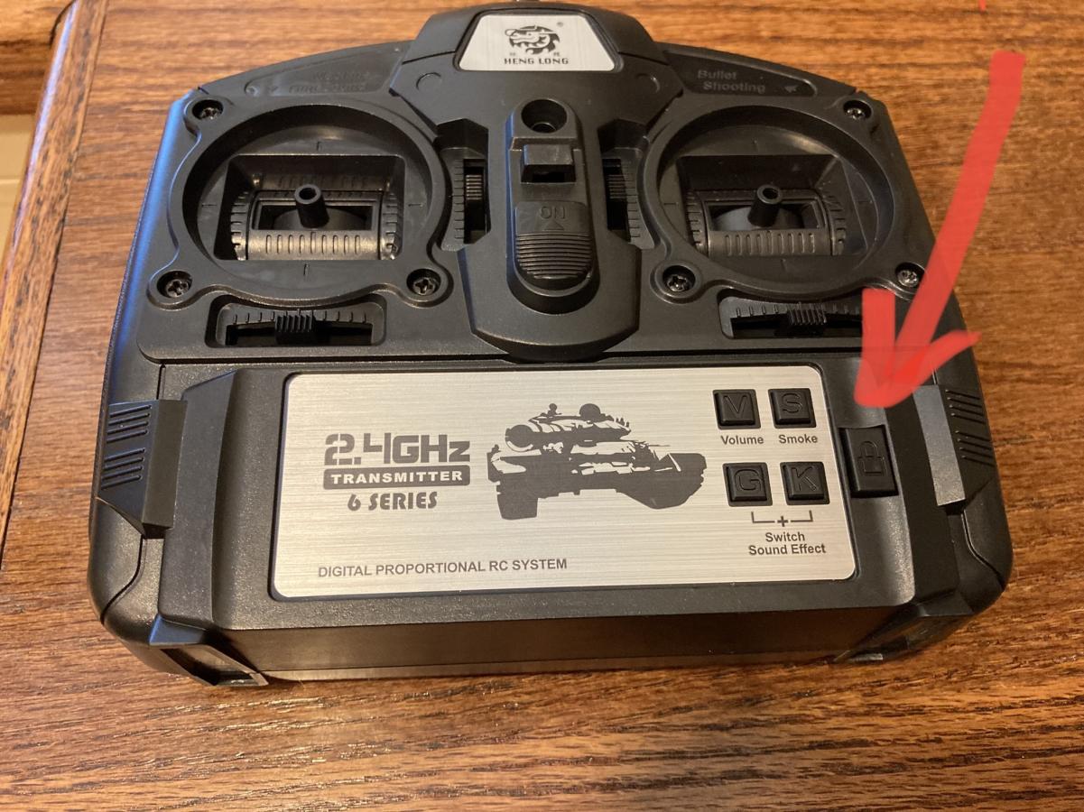

        This is what Bob taught me: Instead of turning the transmission on, then turn the tank on, then press the lock button, don't do that. You should turn transmission on, while pressing the lock button on the transmission, turn the tank on. It works much better than the way they printed in the manual. One thing about the static panther from Toucan, some inside parts might be bad. If you are lucky, all parts work. I was upgrading my panther and found out that the gun elevator did not work. I had to replace it.

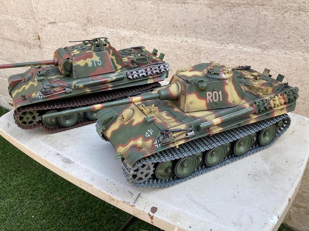

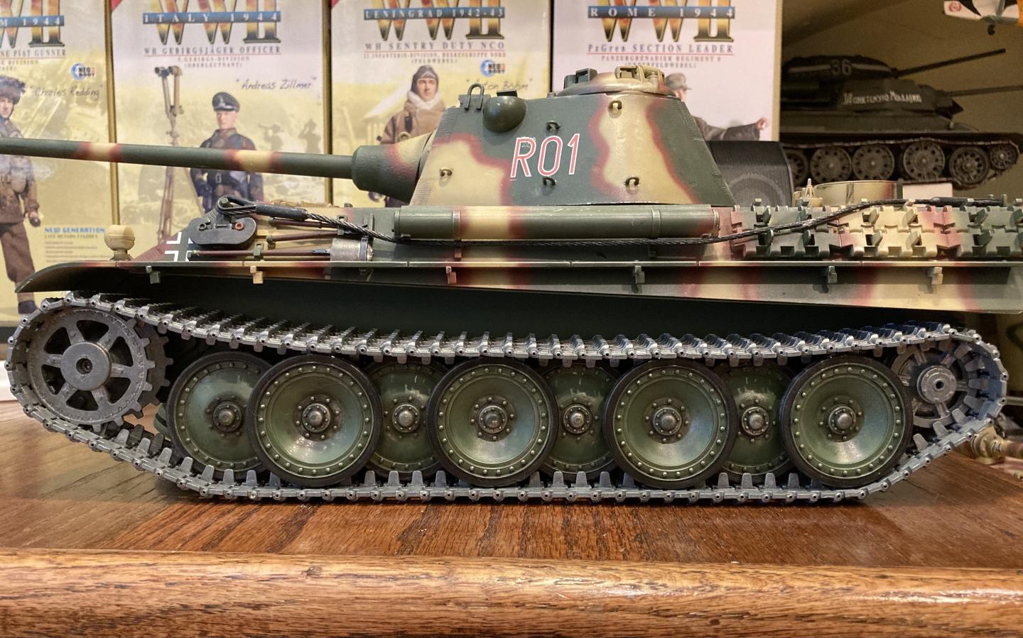

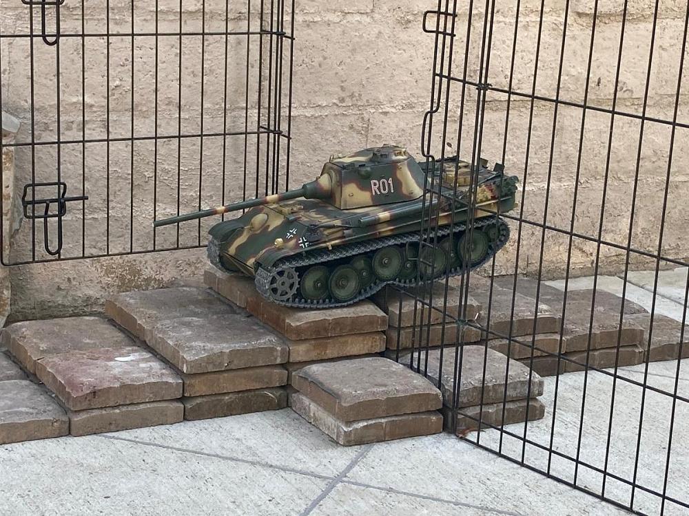

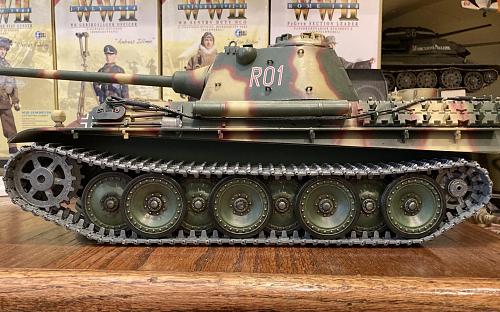

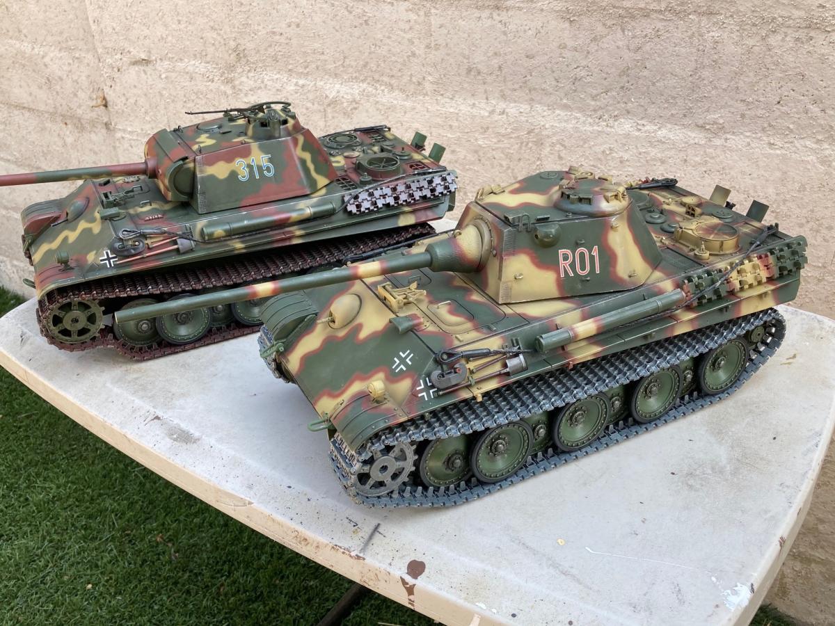

          My family of panthers

            For my Panther II, I was trying to save $. I bought the Torro upper hull, a HL plastic panther to use its lower hull, and HL metal running gears. Now I found that Motion RC has the RTR Torro in stock. I realized that I only save a slightly small amount of $ and I spent quite a bit of time working on it. Well, it's was a project to be learned. I still have the metal idlers that I want to install. I don't know how to take the plastic idler off the panther. If you know how, please let me know.

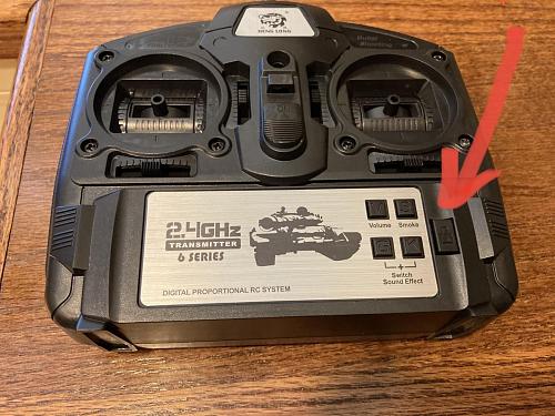

              Which button do we consider the "lock" button?
              I didn't get it from Toucan.

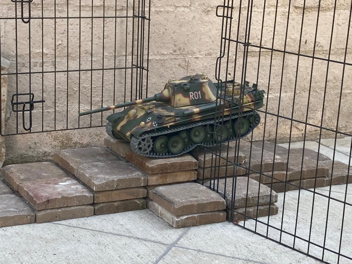

                  DavidN, regarding the idler, I had an older Panther. I'm not positive on yours, but for most HL tanks, a long thin phillips screwdriver that fits into the hole works. Also, sometimes there is a hubcap on an idler. If so for yours, they are just pressfit. You should see a small notch on the wheel at the hub. Just insert a tool and pop it off.

                    Wow! I did it Bob! I didn’t know there is a screw in that little hole. My panther II is set. Thank you!

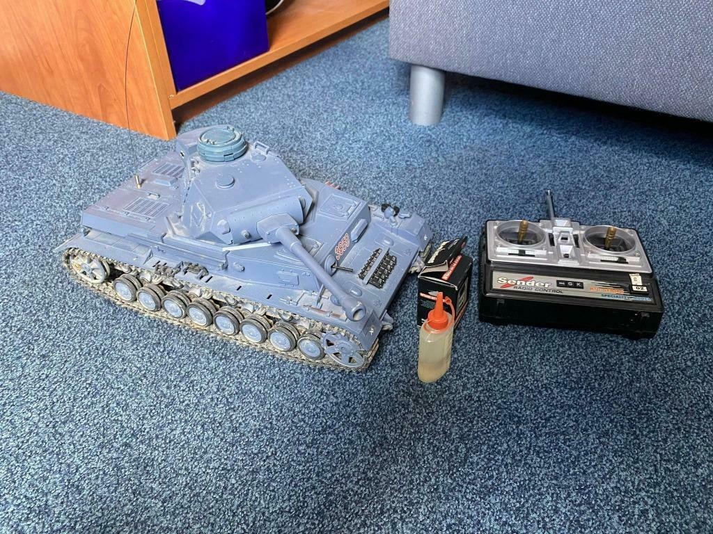

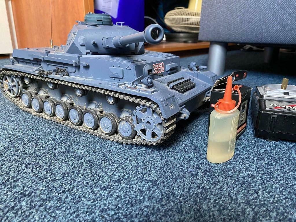

                      I'm eying this tank on a local sales site. Looks like a Panzer IV with an old crystal radio setup. Is it worth it to get dead-cheap and upgrade it to V6.0 or similar? Can it even be done with just a new control board, or does it mean also replacing motors and whatnot?

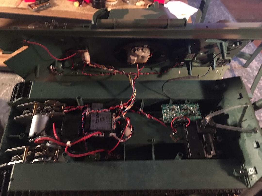

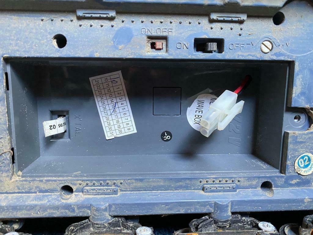

                        My static display model Panther G arrived yesterday. I was pleasantly surprised to see the hull packed with equipment when i opened it up. It was only supposed to have the plastic gearbox installed. Of course it's an old FM version but at least i have some hardware to work with. It has the zink gearbox so i don't need the replacement i ordered. I need to order an operating system for it. Sorry for fuzzy photo.

                          Rob1970, my opinion is to ask the owner to give you a picture of the inside so you can have a better idea. With the tracks worn out like that, you will probably need to replace the tracks, the gearboxes (if the ones inside are plastic), get a 6.0 main board and a cable set. Then you can bind it to your 6.0 transmitter to have it running.
                              Well, I might indeed go for it then, if I can have a peek at the innards. Even if stuff is too worn out it'll be good for parts or to make a non-fighting variant of some sorts for occasional fun.
                                As DavidN said, it'll need a control board and transmitter and a wire harness unless you do your own wire work. As far as gears and tracks, as long as the gear teeth aren't broken, you can replace those at your own convenience. The motors will be the same, only change if they don't work. Does he want $86? (It's the title of the photo.) That seems high. Add-ons could raise the total cost to around $150. If it was an unavailable model you could go for it, but compare that to Pz IV's on eBay.
                                  Nah, the site names all picture you download with a dollar sign and a number. He's actually asking around 55 dollars when I convert it from the Euros, and I can probably beat him down a notch or two to 45 dollar. As I said; with the price of just a receiver (I can do my own wiring... at least I should hope so...) it would be totally worth it, as a side project.
                                  On that note; my Sherman is a TK6.0S. Do I need to get a TK6.0S receiver to bind this project (if I go for it) to the Sherman's transmitter? Or will a TK6.0 do? How much cross-over is there between the sets?

                                    Old stock being sold as static minus the TX. They are getting more lazy then ever. They used to rip all the electrical guts out. Lost of the wires can be reused in you upgrading, so that’s a plus👍
                                    You will still want to replace the gearboxes as the Zinc are only slight stronger then the plastic gearboxes.
