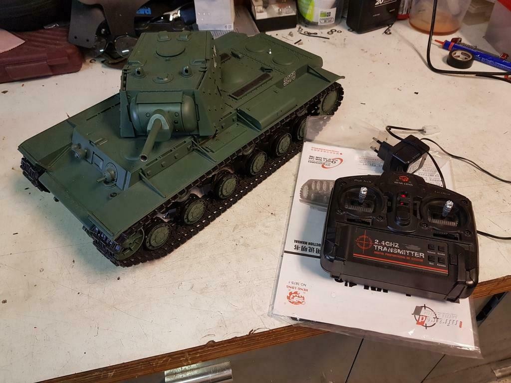

        Oh well... just picked up a KV-1 for peanuts... It's going to be a fun project on the side... Some plastic decor missing, and I think it's a 5.xx board? But hey, for the price I payed I am happy with it. Already have ordered a 6.0S board to upgrade it, along with the IR gubbins. Wiring I can do myself.

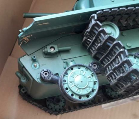

          My really cheap KV-1 arrived... and the postal service managed to do what many German tank failed at...
          Click image for larger version  Name:	Ouchie.png Views:	0 Size:	252.5 KB ID:	319028

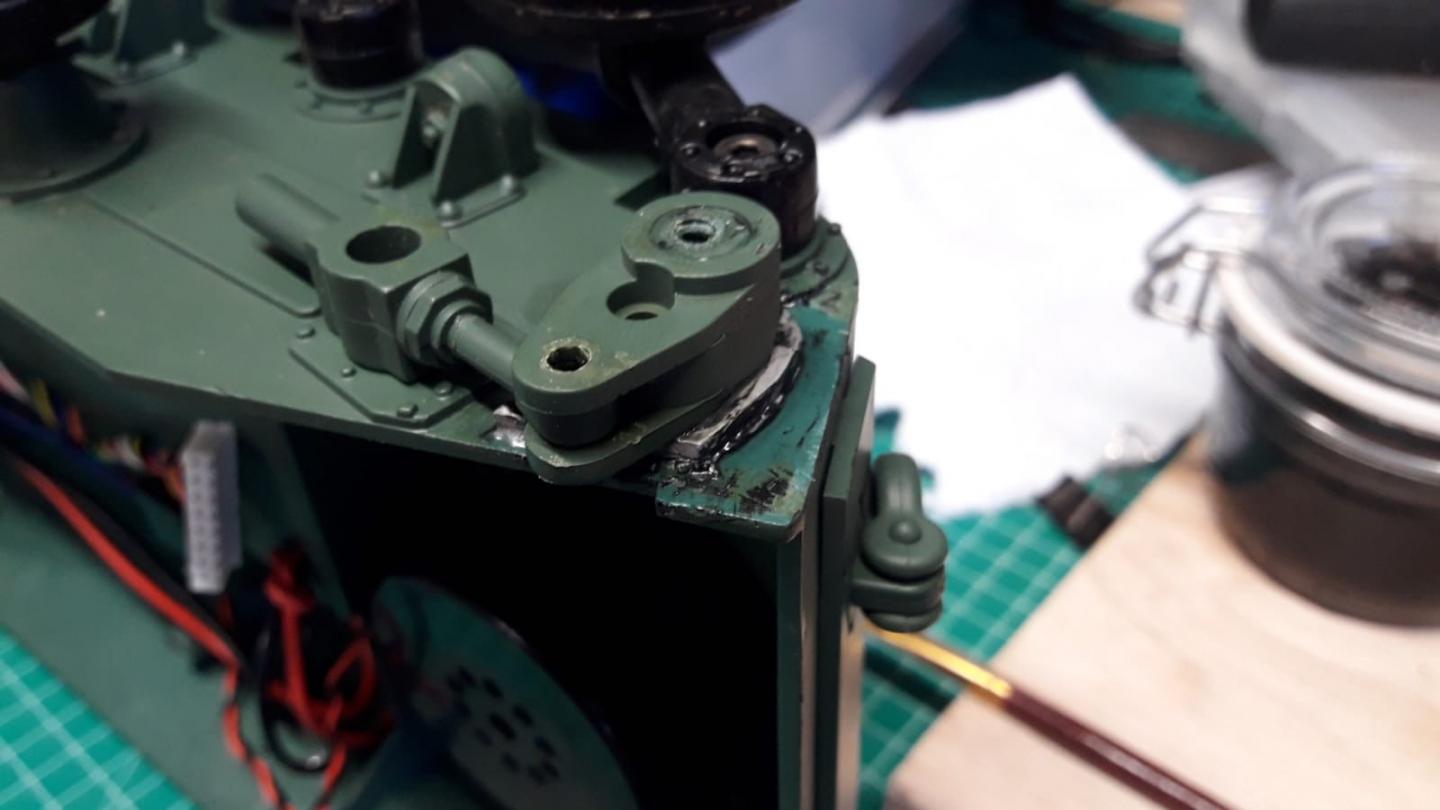

          Both front idler wheels snapped off, and a chunk off the fender. Wheels are being fixed, and we will call the fender battle damage. Altho MEK and ABS works great, might be fine..
          *sigh*
          *EDIT*
          Fixed!! It ain't pretty, but it works. Kinda like me. "In Soviet Russia, Comrade Tank Mekanik weld STRONK!!" Just need to put in that "bolt" that was glued into the tensioner. I had to saw that out. tho..

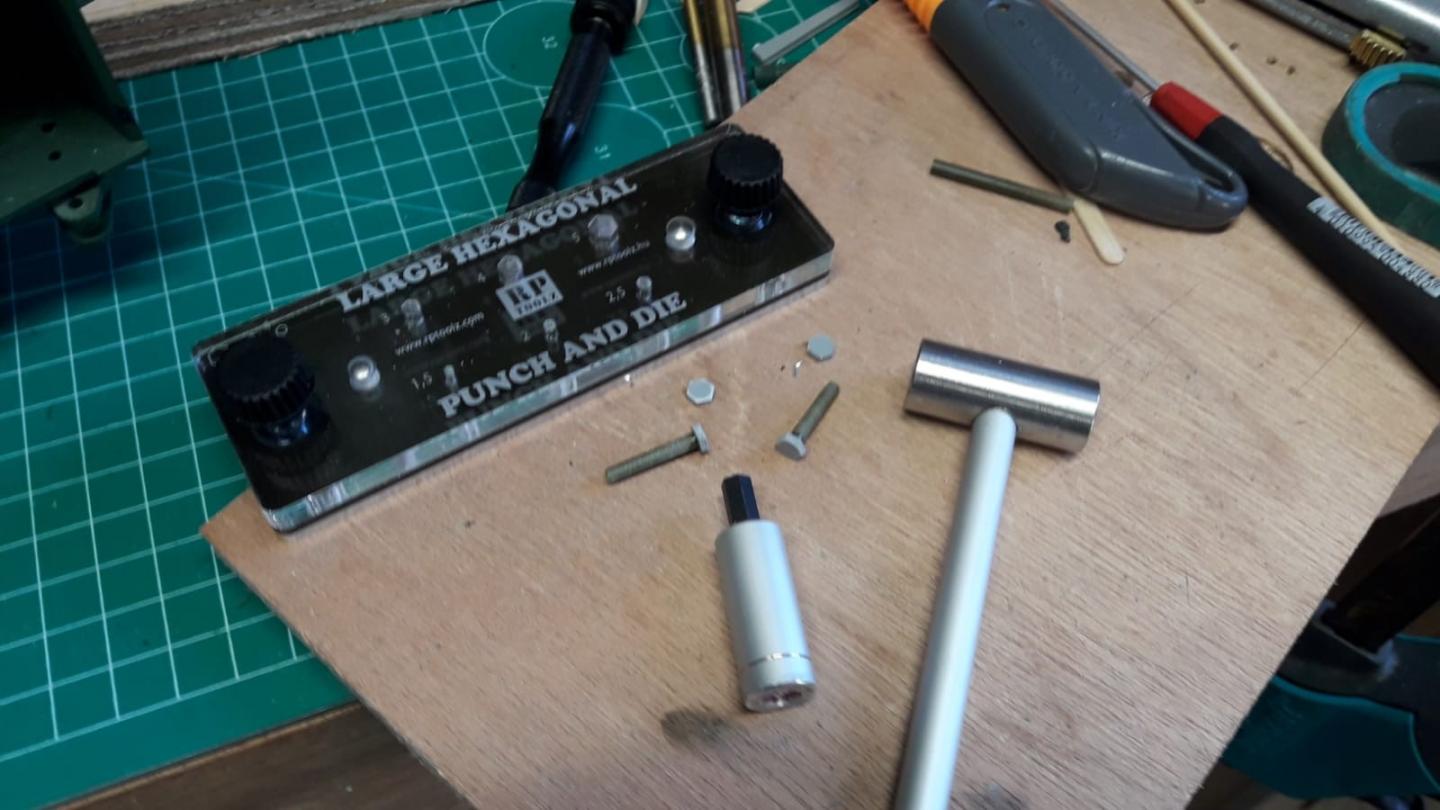

          ...but meet my new friend! Mister Nutter!! This is probably my new favourite tool. Awesome for scratchbuilding. Had to hunt around for one, they seemed either sold out, or going for a ridiculous price. But I managed to find one. Still wasn't cheap, but totally worth it.
          Click image for larger version  Name:	MisterNutter.jpeg Views:	0 Size:	112.7 KB ID:	319031
          Also; ain't that little hammer not the cutest ever!!

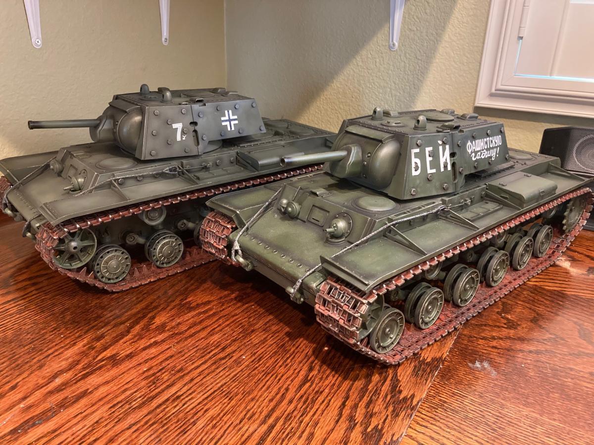

                My Kvs' works were quite simple: washed, dry brushed, rusted, and coated. One for the Russian and one captured for the German. I am waiting for the order on the metal tracks and ge Click image for larger version
ID:	319072 ars for replacement.

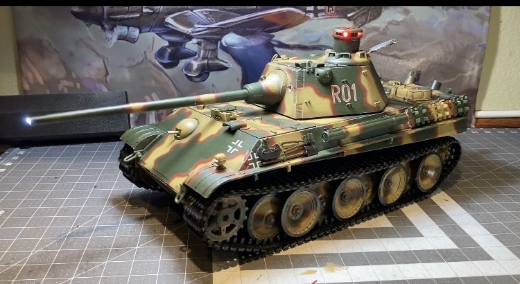

                        All electronics done. Started doing some old winter weathering on top deck and turret. Range has at least doubled with the addition of the Lego IR unit. With the exception of the smoke unit, which is the old puffer type, all the hardware and equipment is working well considering this was a static plastic version!

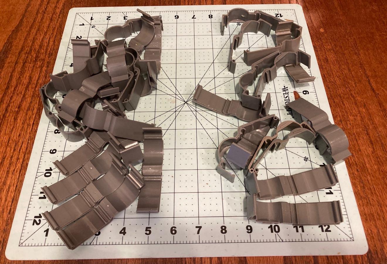

                          For member who had his static tanks upgraded, you can get these gearboxes cover from Toucan to protect your inside components from the grease at very reasonable prices. I have just received my orders:

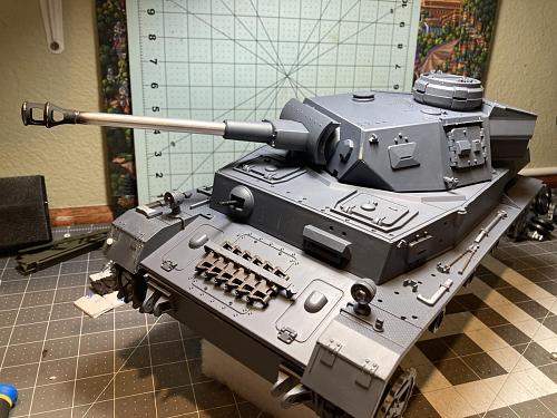

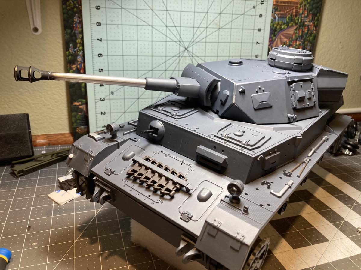

                            For $11.50 (cost of the metal Toro panzer IV barrel), I have just upgraded a HL panzer IV F2 to a panzer IV G :-)

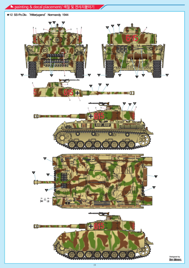

                              I am waiting for the side skirts set to arrive and turn it into this.....

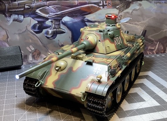

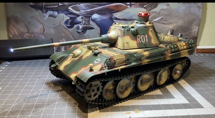

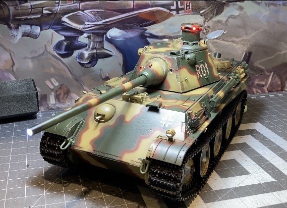

                                Top is from Toro with metal turret. Bottom is from HL with ultimate HL steel gearboxes, metal tracks, wheels, sprockets, and idlers. The tank now has LegoDEI IR emitter and receiver. The lighting includes launching light, aiming light, MG light and frontal light. It is ready for battle in January 2022 :-)

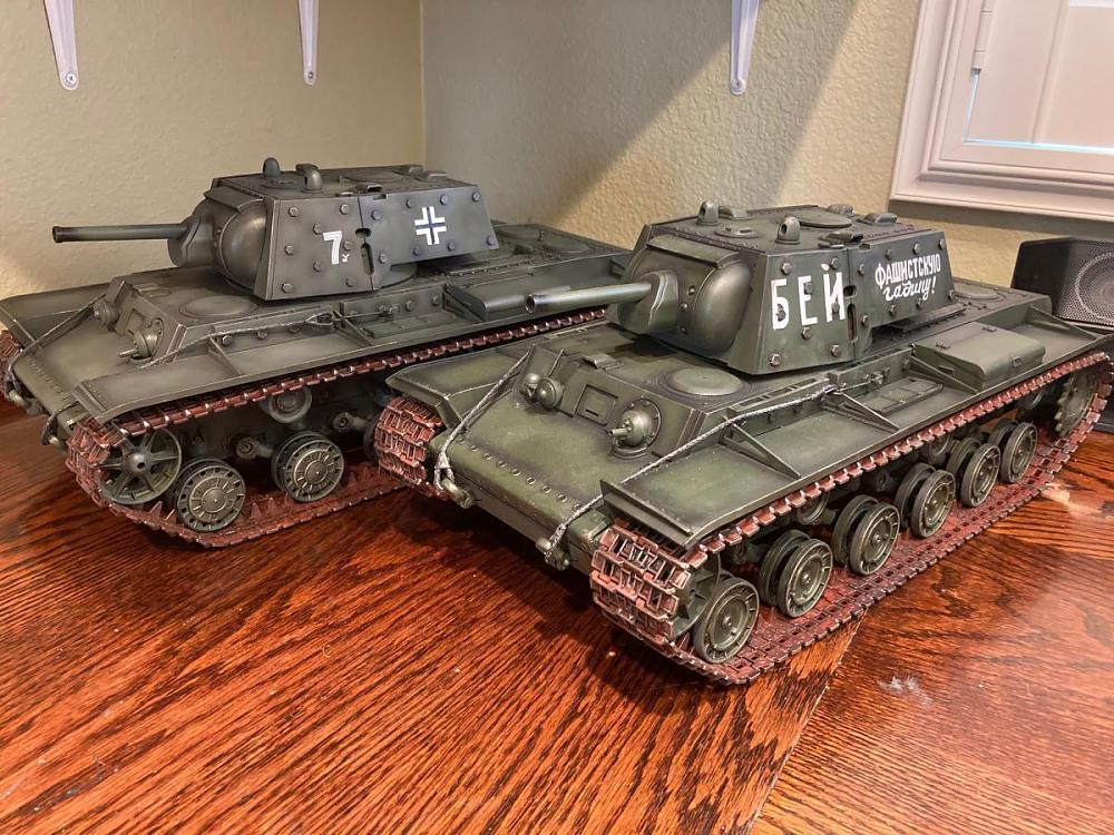

                                • #56
