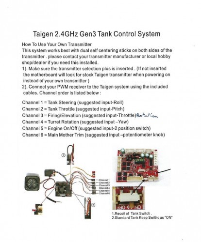

                  Another question, if you use a different TX, can anything be done to tone down the track recoil on a Torro tank?
                  I like to see a little movement when the cannon fires, but the Sturmtiger jumps way too much for a 70 ton tank.
                  Steve

                    Nothing much when using the v3 board, the only thing is ON/OFF in the Torro/Taigen track recoil, unlike the newer HL's.

                      #50
                      Sureshot Taigen/Torro has tiny on/off switch in motherboard slot area & is slid to the left (think so) to turn off; printed on/off very small. I hate track recoil so I used micro screw driver to move switch. Have T90 HL with adjustable track recoil set to lowest setting which is ok. I like the 6.0S motherboard.

                        Thanks for the info on the switch! I don't think that was in the manual.

                          #52
