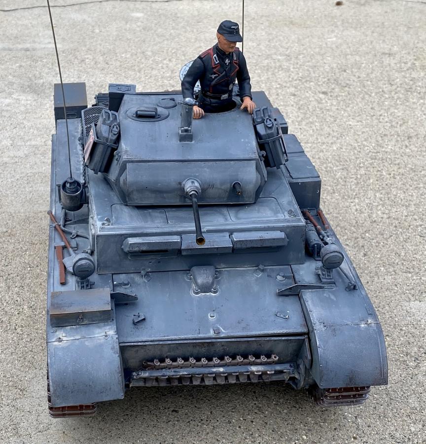

        Milestone achieved, and some observations....
        It's actually working! Now for the cosmetics; more details, weathering, etc.
        The conversion kit from 35rctank is a quality product. Everything works, the gearboxes are robust, the main board works without a hitch, the turret revolution is smooth anda suitable speed, and the recoil of the auto cannon is cool. His product interacts with the tank kit well.
        All that said, it's been a struggle that I wasn't sure would succeed. Primarily it's because of the suspension. Earlier I showed how the working torsion bars had to be modified. It weakened the arms severely. A couple broke and had to be reinforced. Although the road wheels are meant to turn, The axle design won't stand up to r/c use. And because of the nature of the overlapping road wheels, removing one means removing them all for access. Although the conversion manual wants the torsion bars glued in early, I fortunately never did because I had to remove them a number of times for adjustments. I can't fault 35rctank's conversion, he did the best with what he had to work with.
        Building this tank from two sets of instructions presented it's own challenges. The tank has hundreds of detail parts for the interior and exterior. For instance, one headlight assembly has seven parts. Three parts including PE for a strap buckle! One must follow their manual in strict order for everything to fit. However in this case the sequence has to be altered to accommodate the r/c conversion. It's necessary to make the lower and upper hulls separate Selecting which should be included or left off and when to add them led to some frustration.

        Notwithstanding the above, it runs. You'll see I chose a Panzer gray scheme. For one, I could never equal DavidN's job, but in actuality, I have too many "dunkelgelb" tanks! the Luchs was apparently operational for a number of months before the three color camo directive was issued. Notice the bottom half has some weathering while the top is still clean. That's a consequence of the issue I mentioned above. The bottom had to be dirtied up as the wheels were added, and the top had to be taken off so many times for construction access, I couldn't add on all the tiny detail parts and therefore couldn't paint until I was satisfied it would run reliably. I still haven't added the four piece clear periscope lenses on the turret!
        Would I do this again? No, not really. But I learned a whole lot from the process, so it was a positive though frustrating experience.

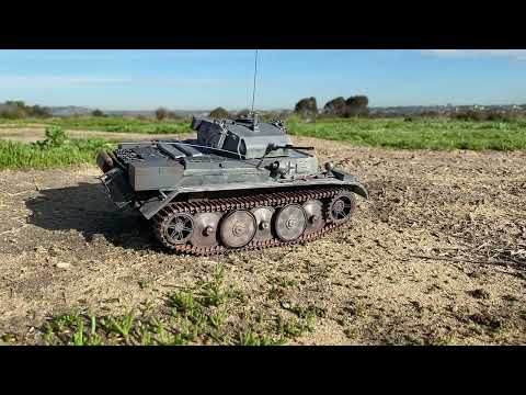

          Here's a quick video clip, low production value, just to show how it works:

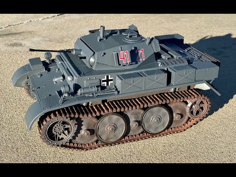

                            Another short clip. Still having some trouble with the interface between the gear train and the sprocket. It slips. Hey, it just needs more glue!

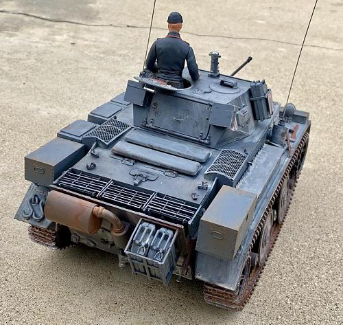

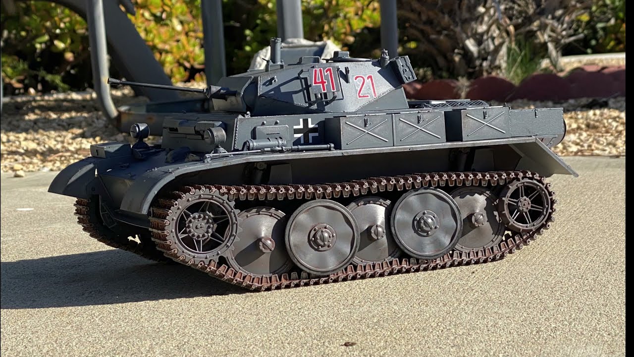

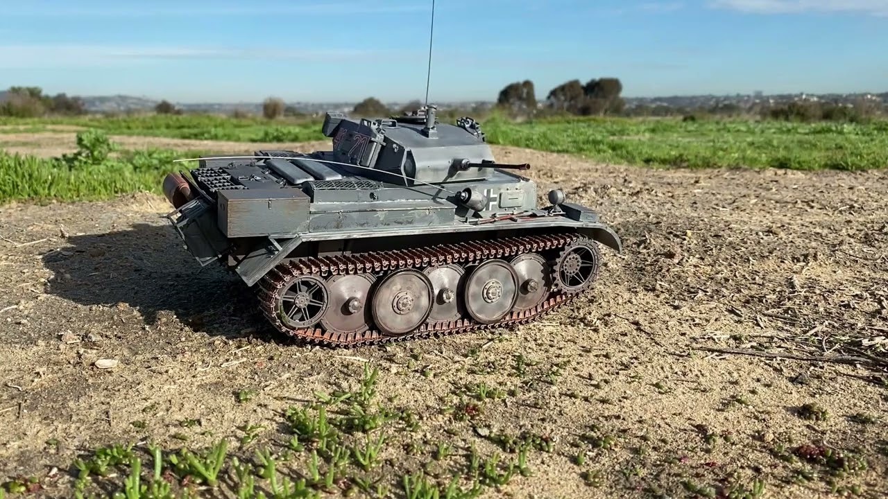

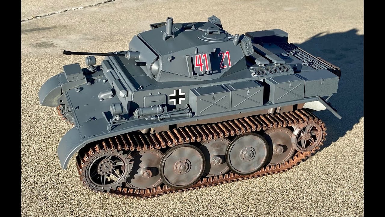

                            Twenty six tanks, and not done yet!

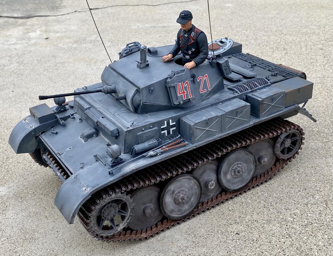

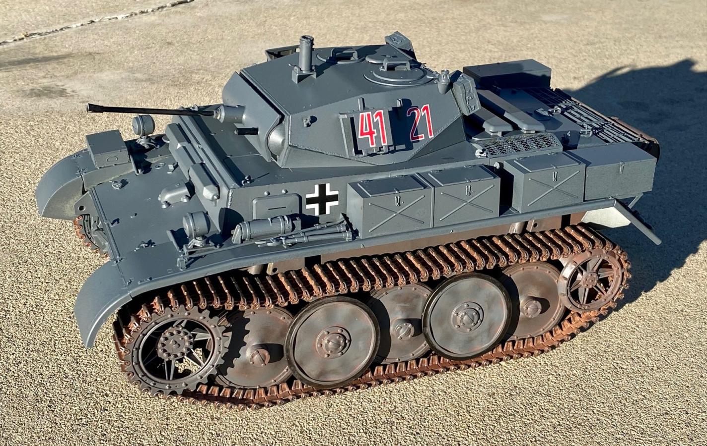

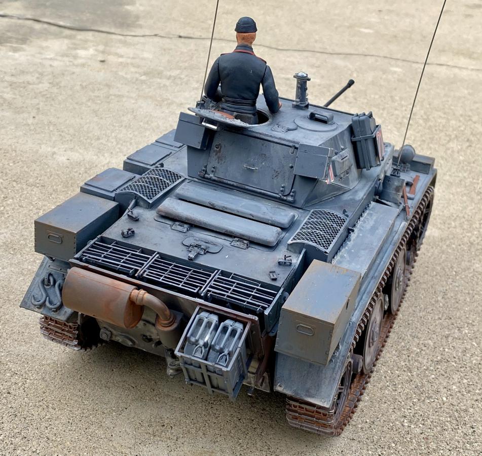

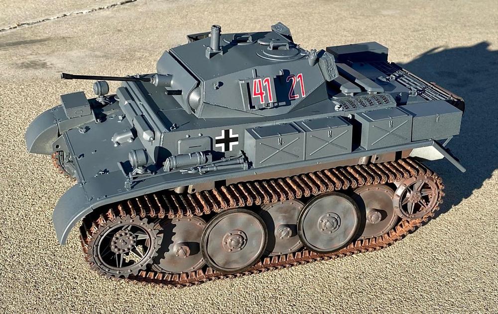

                            • #74

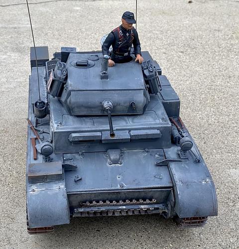

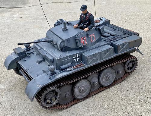

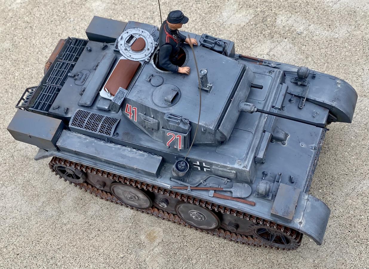

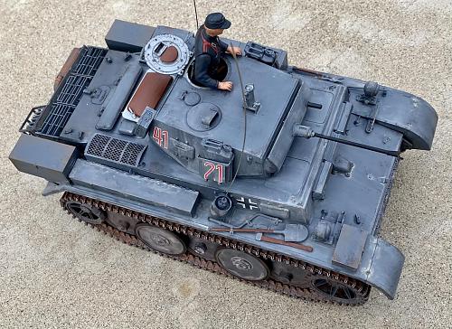

                              Here are some stills of the finished....um...finish:
Name:	PzKpfw II L 20.jpg
Name:	PzKpfw II L 21.jpg
Name:	PzKpfw II L 22.jpg
Name:	PzKpfw II L 19.jpg

                              • #75
                                Bob
                                Great job on the paint and weathering
                                • #76
                                  Great job! Did they really carry gas on the sides and near the muffler like that? Seems like inviting disaster....
                                  • #77
                                    I guess it was preferable rather than inside! I don't think there was much excess space there.

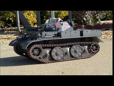

                                      I removed the short clip from Youtube and uploaded a three minute video of it scooting around.

                                      • #79
                                        The video is great for members to view. I have the tank with me. Hearing the engine and the rapid fires from the tank when it is in front of me is so awesome. I tried to watch Bob's video from my Apple computer and my iPhone. The sounds did not feel right for me. I guess that big speaker 35RCtank really served its purpose. Lucky for me that I bought this tank and was able to work with Bob to accomplish the same result .
                                        • #80
                                          There is a noise that occurs when the throttle is high which sound like a grinding or whining. I listened to a real one on youtube and that noise is present there too. It's a "feature" not a "bug"!
