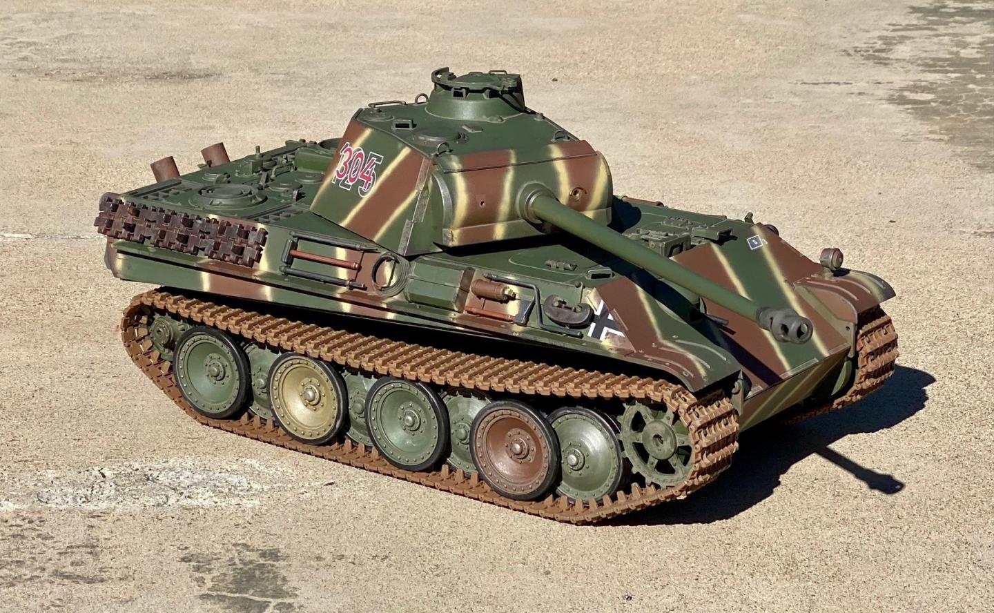

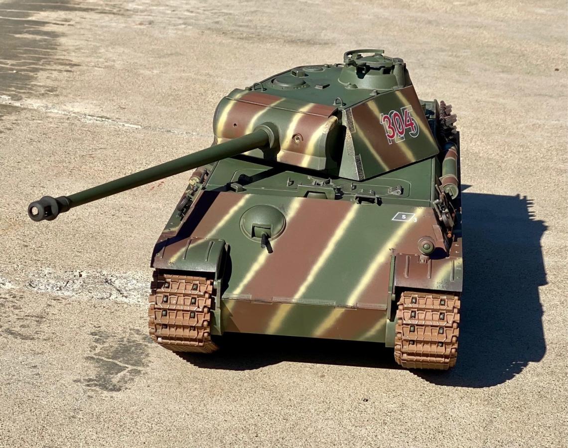

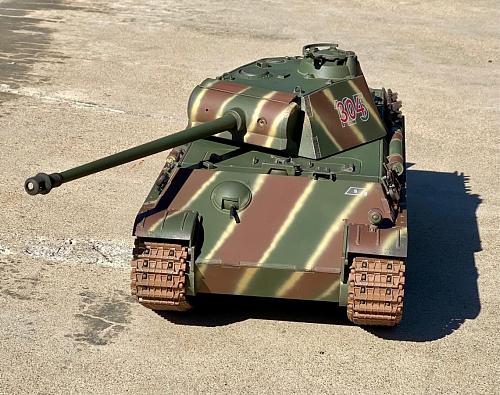

                            90% done. I opted for a historical camo scheme. B7W photo was taken after a battle near Muncheberg in March 1945.

                            The camo was supposed to be hard edged between colors, but as in the b&w photo, examination looks like it was done with a sloshy paint brush. No masking tape there! You can see that the tanks had individual variations. And other photos show that the top surfaces weren't camo'ed.
                            Mine hasn't been in the dirt yet.

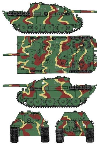

                                I finished putting the side skirts on my jagdpanther. Before I was planning to paint a similar scheme like yours. But it is too easy .

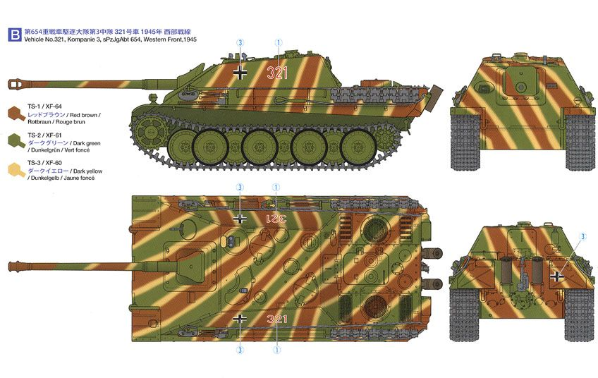

                                  I am just kidding :-) I already have planned on applying this scheme
