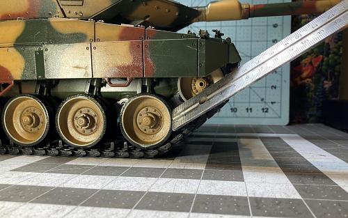

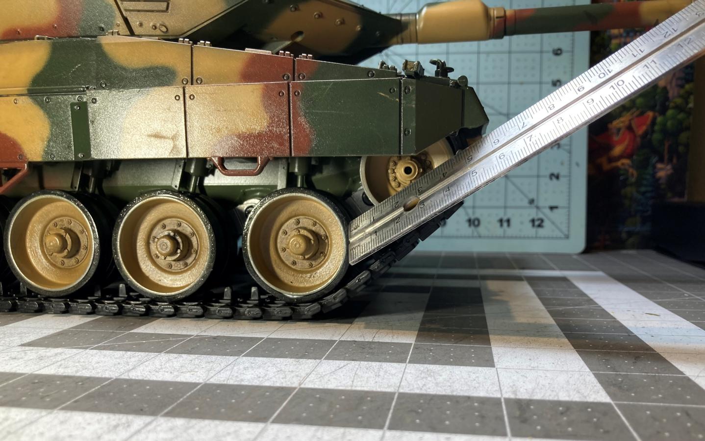

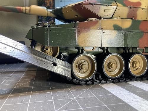

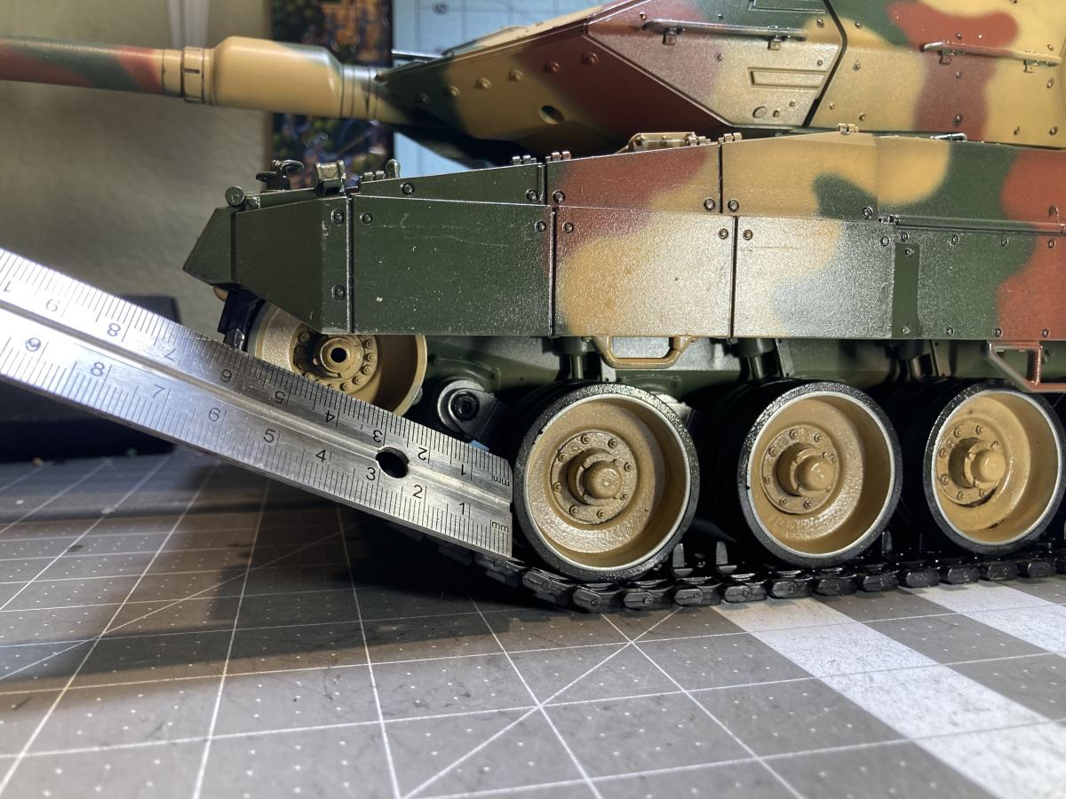

              Can one of you kindly post a picture of the space between the idler and the 1st wheel on both sides of your Leopard II? I have a HL Leopard II and I would like to see these areas for comparison. In my tank, on the right side, the space between the idler and the 1st wheel is about 12mm. But on the left side, it is almost double at 24mm.

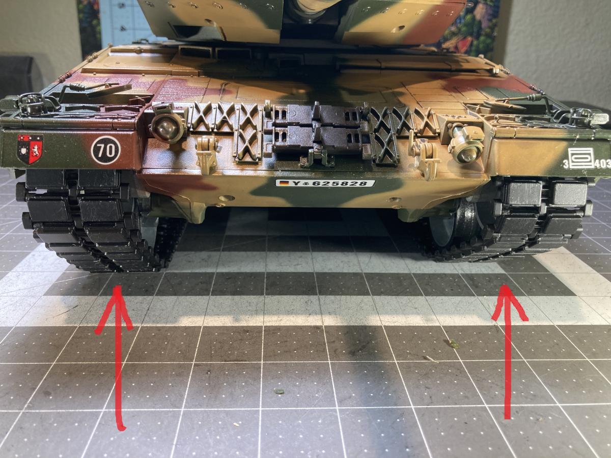

                This makes the right front track is more in front than the left front track. Is this normal? Would it affect the movement and direction of the tank when it gets to a slope?

                    Yes you are correct there is a difference between the two sides. It is this way even on the real tank. It has to do with the way the suspension system is lied out.
                    One side will have a slight steeper track approach angle then the other. So as long as you are not having any de-tracking issues you are fine.

                        David,
                        Similar L & R spacing on my Taigen's.

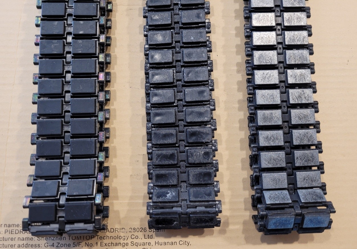

                                    Rubicon99 It seems to take forever, first I was told by Tami these were discontinued when I tried to source some back in June, BUT the 2 sets I ordered from AAF finally showed up today. They look and feel good. I quickly shed Leo #1 of the DKLM and put the Tami's on, they were the exact length I needed, no adjustment on tension. I ran her for a full charge and these are by far the best Leo 2 tracks out of the 3 sets.
                                    There was nothing really wrong with the OEM Taigen's, aside from the weight and fake double link, and the fact I didn't like shinny pads, they did not give me any issue. Then I got the DKLM because the Tami's were "discontinued" at the time, these look pretty good, a bit more elaborate looking, but because of how the pads are retained (friction & grooves), the pads would sometimes work outboard and ride on the sprocket, causing track jumps but never threw once. These can go on the Abrams to shave some stress.
                                    The Tami's are just so smooth running and quiet, very pleased. Thanks Rubcon.
                                    L->R (Tami, DKLM, Taigen)

                                      Glad to hear you finally got a set and that they are working out well for you👍👍
