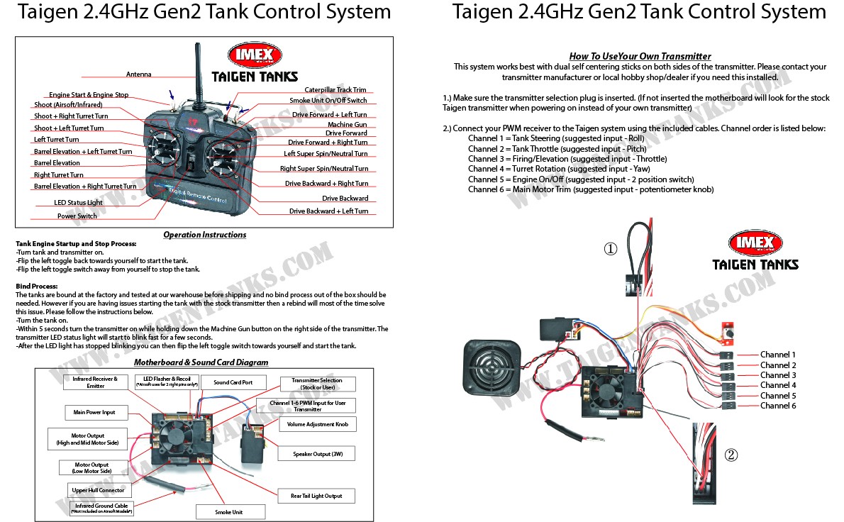

    I was under the impression that those wire packages that came with the Toro/Taigen tanks are for the owner to hook them up and switch over to the hobby grade transmitter. If that is true, does anyone know the link for the steps to switch over. Or I might just need to contact MotionRC and ask since I bought the tanks from them. Thank you!

    Here you go, know this - your smoke unit is ON (Hot) by default so you may want to wire in a manual On/Off, and the MG cannot be activated since Taigen uses some undocumented hard-coded mix on CH 5.

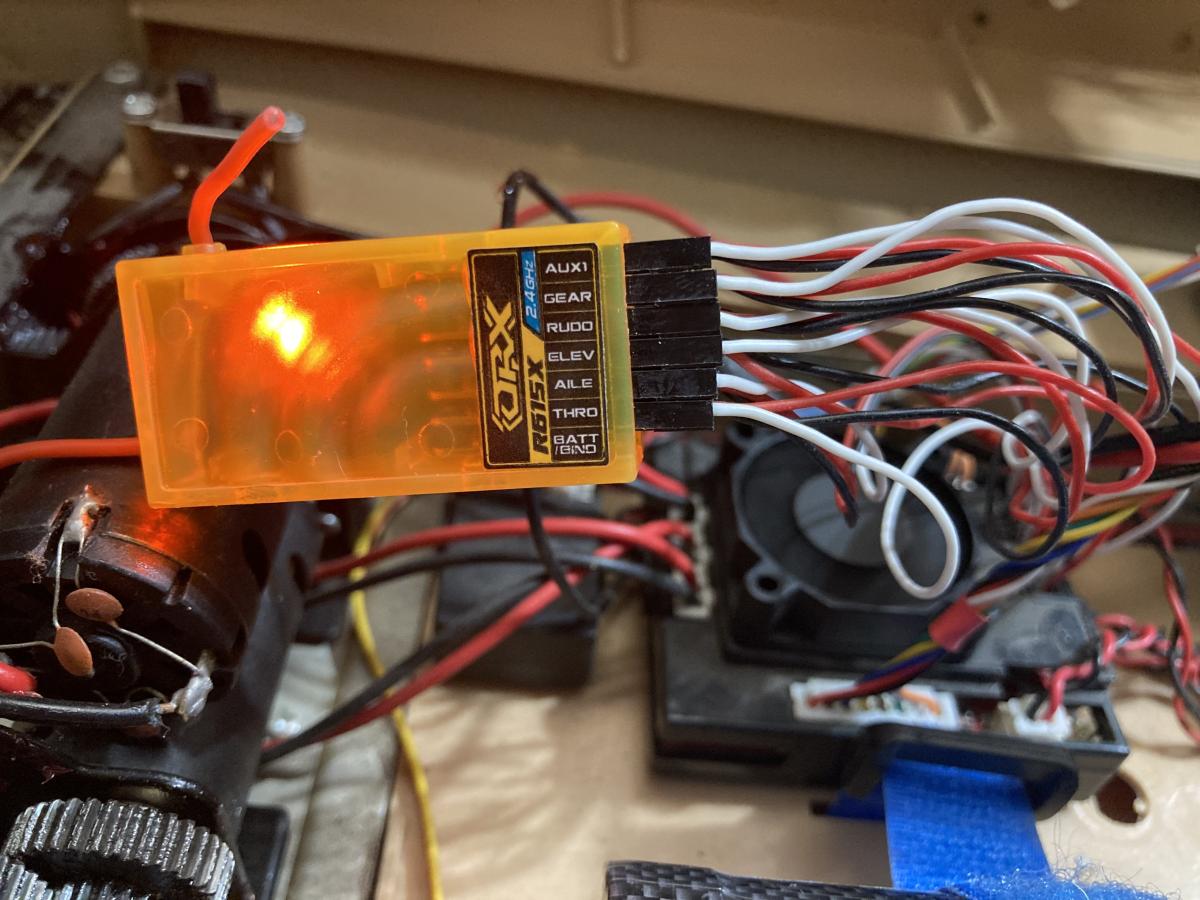

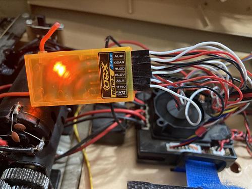

                            I got the receiver. I bound it with my DX9. I plugged the receiver into all 6 Chanels of the Taigen tank. I turned the Tx on. Then I turned the tank on. The fan inside the tank activated. The light in the receiver flashed, but the tank did not start. I moved both controllers all around and nothing happened. Is there anything that I need to do have the tank engine started
                            • sclui56
                              • Mar 2021
                              • 415
                              • LAX
                              David, not sure about the setup on your Tx, but I usually use a 2-pos toggle for CH 5, ON/OFF

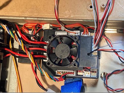

                                I also use the position switch for channel 5. From 1-4 are for the thro, rudo, elev and aile. So do you just turn the switch for channel 5 and the tank engine would start?

                                • sclui56
                                  • Mar 2021
                                  • 415
                                  • LAX
                                  #17
                                  That's basically how mine is setup. Stating the obvious - you did insert the selector plug that shorts the 2 pins, right?
                                  If you have a spare servo, use that to test out your channel assignment, start with CH 5 assignment.

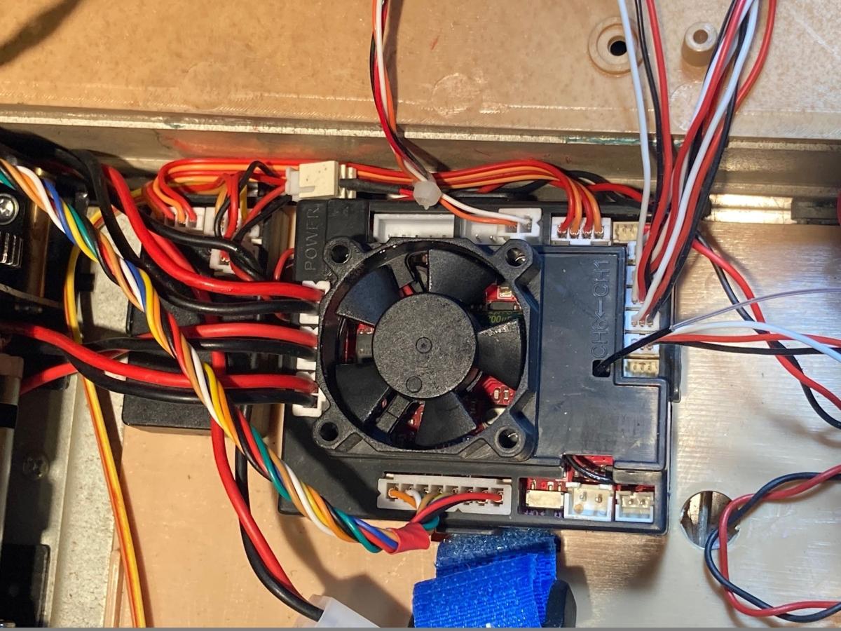

                                      #19
                                      Sorry! I did not know about that. Can you show me where to plug in to short it?

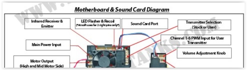

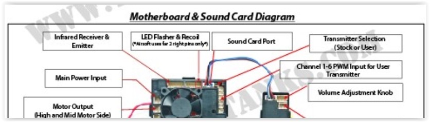

                                      • sclui56
                                        • Mar 2021
                                        • 415
                                        • LAX
                                        #20
                                        David, it is to the right of the sound card port in this orientation.
