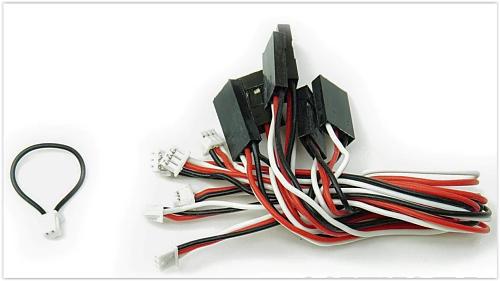

      David, it looks like an old-style bind plug where the single wire is looped, it comes with every Torro/Taigen, in the same bag as the 6 Rx-Servo bridge wires. You gotta have at least some with all the Taigen's.

        Thank you so so much! I didn't realize about that little plug. It was in a different box. My tank runs now with the Spectrum DX controlling it. I took out the smoker plug. You are the best . I will order 9 more orange receivers for the rest of my Torro/Taigen tanks.

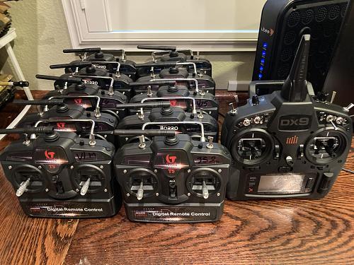

                Hope you got the module faster than I got the receivers. The 6 channel receivers finally arrived. I have replaced the use of my Toro/Taigen transmitters for just 1 DX9 spektrum .
                Any input on what to do with these transmitters?
                Regarding the machine gun to function, what should I do?

                  DavidN A member over on RCU actually sent me 2 of the correct sound modules for free so I am kind of sorted in the T34 (had to beef-up the suspension as it's one of the least robust ones from Taigen). Glad you got all your Rx's in, using 1 single Tx certainly beats feeding all the OEM ones! I still have the same problem with the HL's using individual Tx's, haven't figured that out short of changing MFU's. BTW, just did the magnets on the KV-2 last night, not bad once you made the 1st cut. That's another thing I missed on HL's - quick release.
                  As for Taigen Tx's. I started storing them all in 1 box with unused accessories+manuals, may be someone will need replacement later? Still trying to find solution for MG's, the one company that sells on HK stopped supplying the ones for the tanks several months back, seems like they are focusing on higher profit ones for planes. It surprised me to no end that no one seems to know the hard-coded mix off CH 5 used by Taigen, even IMEX didn't appear to know. Can't really ask directly as Taigen/Torro does not have direct internet presence. Hopefully we can get the "mix" from Taigen at some point.

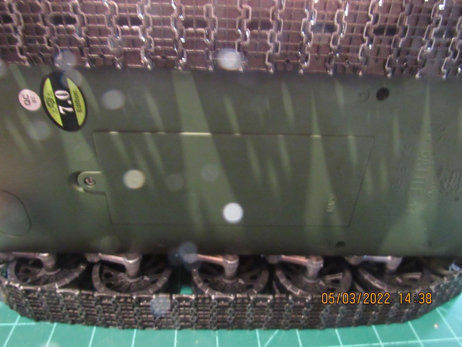

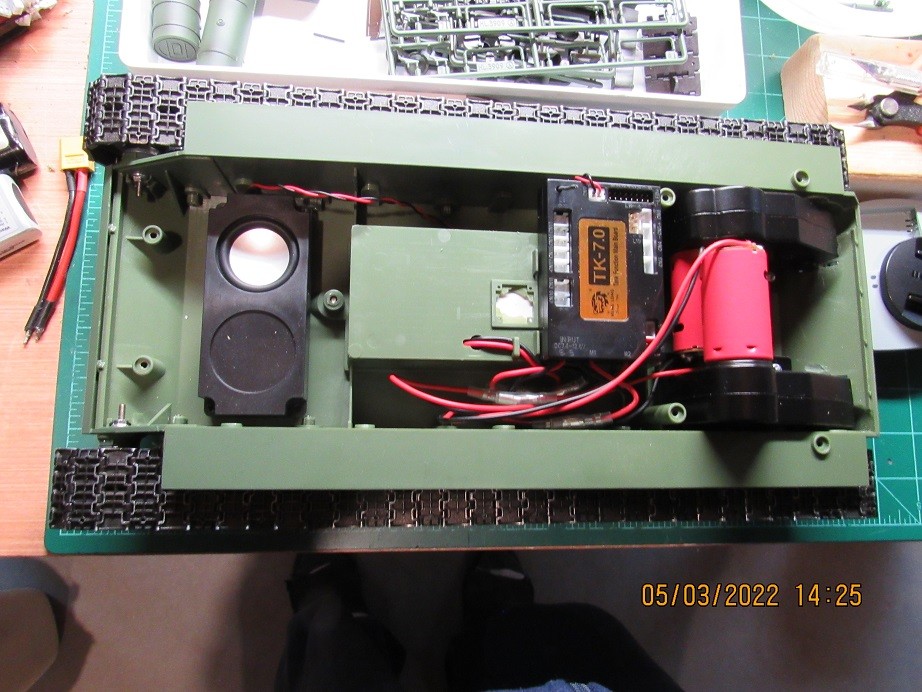

                                I am in the process of converting a Heng Long T-34/85 to full metal. I foolishly assume that the Taigen is the same dimension and thus interchangeable. I was wrong. The Taigen track is too short for the Heng Long.
ID:	345389Click image for larger version
                                Before the track, I install the Heng Xin gearbox with 390 motor which works perfectly with the HL tracks. But the gearbox install takes some work. I use Taigen sprocket and idler wheel.

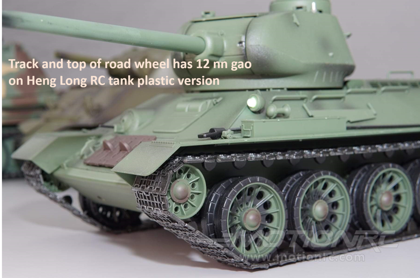

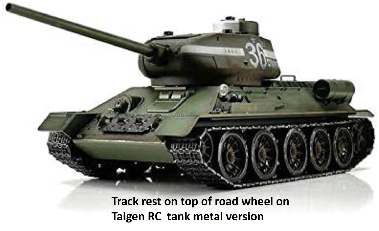

                                        I made a mistake. The shorter Taigen and Torro metal track length are actually the correct one for heavier, metal chassis T-34/85 1:16 scale RC tank. See the real life tank, Heng Long and Torro tank pictures below. I will post my result when I finish my upgrade.
