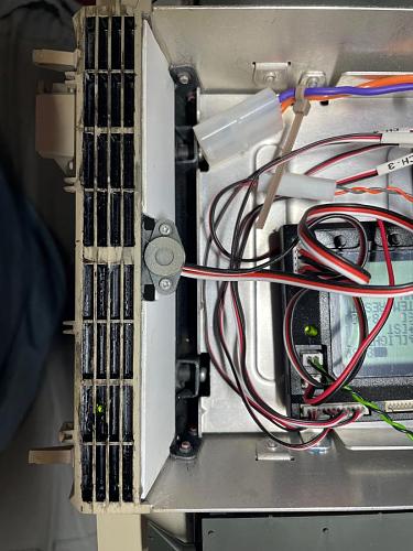

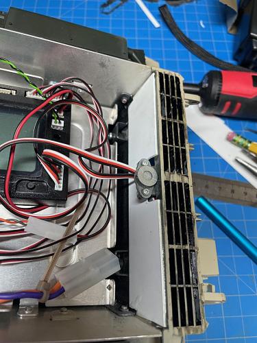

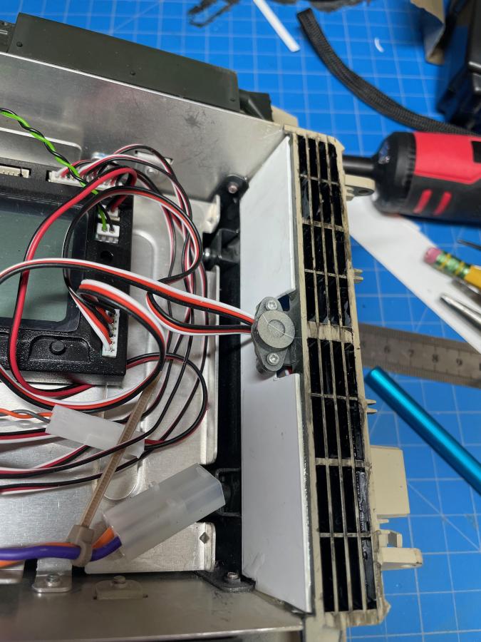

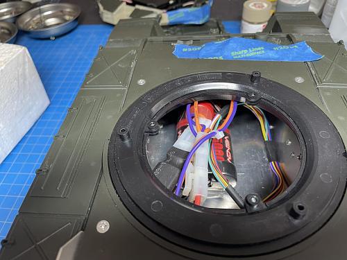

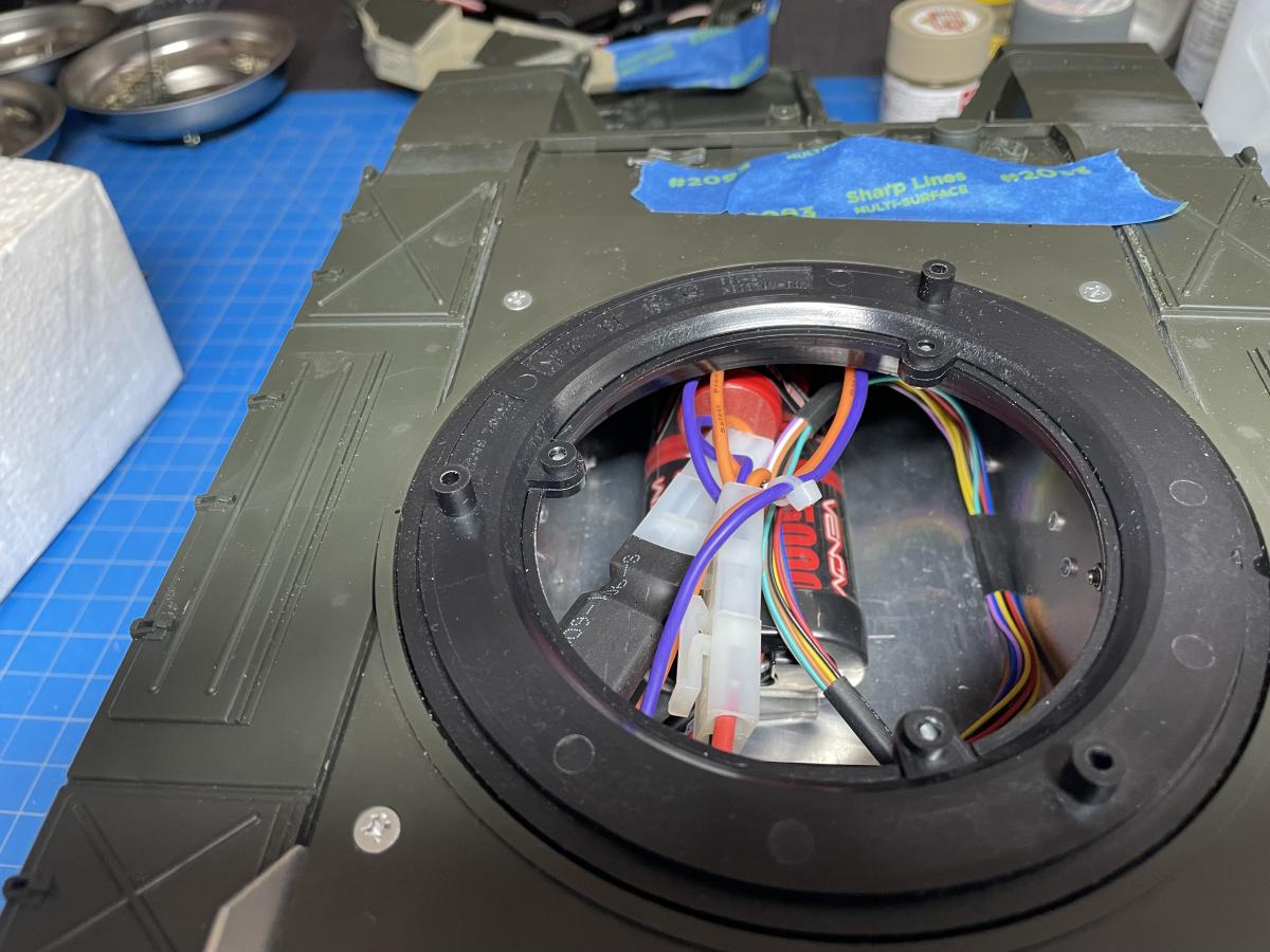

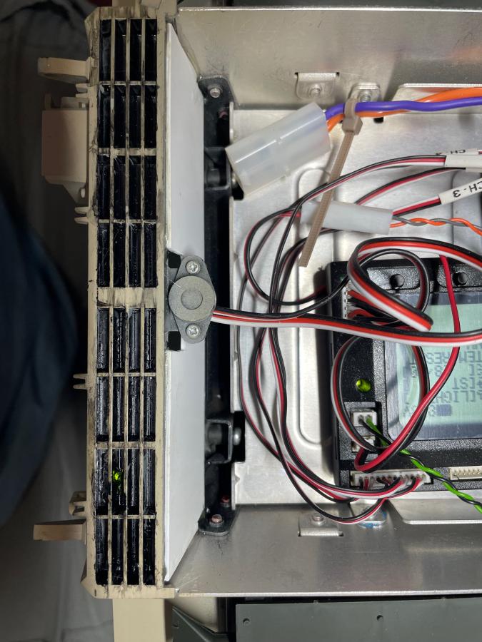

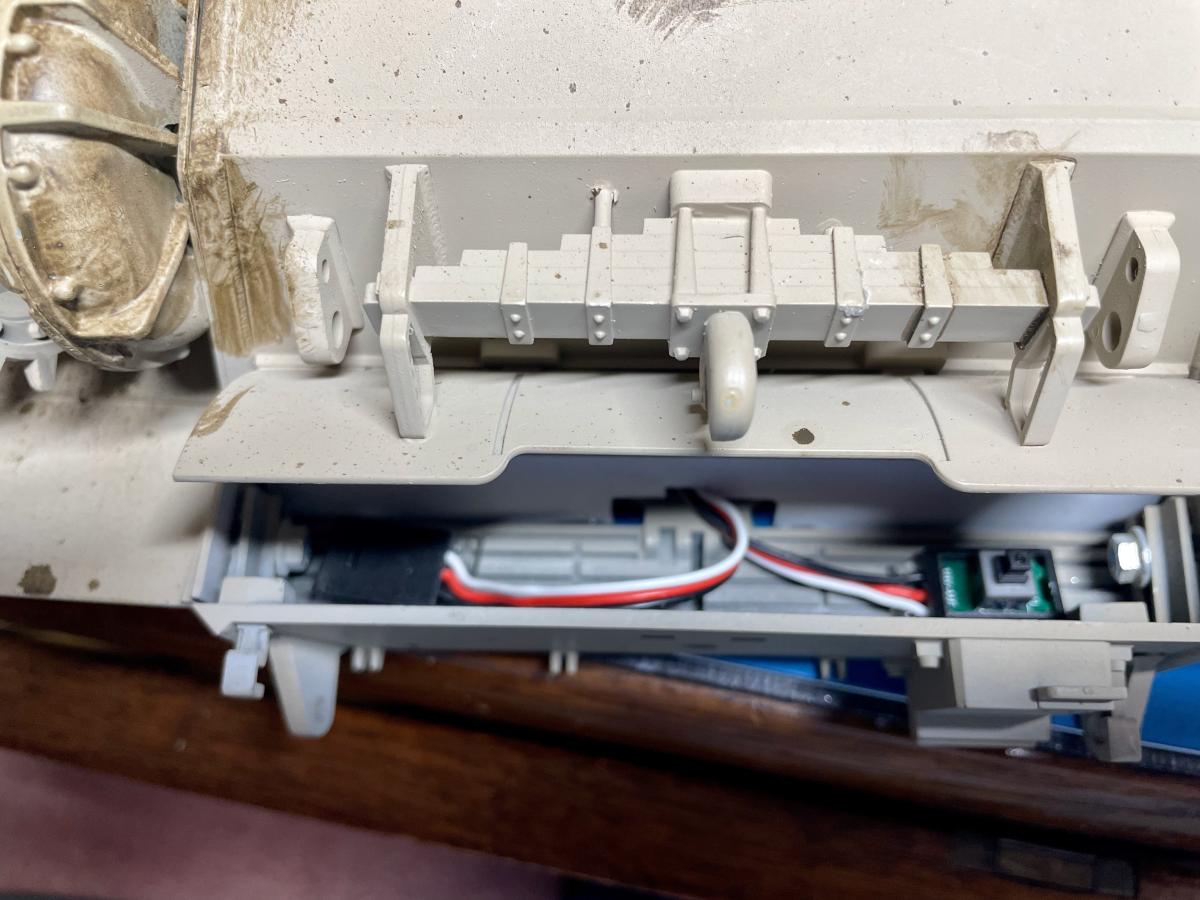

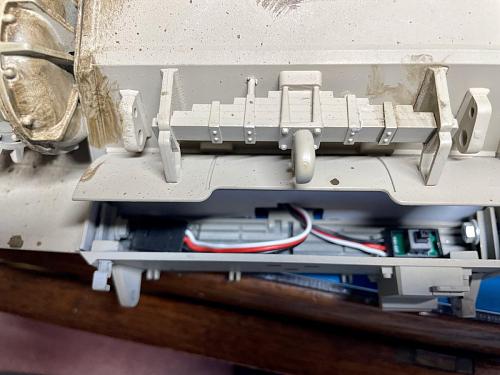

    I have made a couple of mods to the Centurion. After seeing Rubicon99' tank I decided to add the on off switch under the rear vent. I also place the on off LED indicator under this vent, drilled a hole so it is visible. While working in that area I noticed there is a very large opening that may allow dirt to enter the tank. Using sheet styrene and rubber cement I closed off that area. Also following Rubicon99's recommendations I placed a 8.4V hump back battery as far forward as I could. I installed a after market Tagan small speaker. Since the battery is not easy to remove I added a Remote Recharging Jack Cable from East Coast Armory. The remote jack can either reach to the removal rear deck or out the drivers hatch. Click image for larger version
Name:	Centurion Battery.jpg
ID:	356178Click image for larger version
Name:	Centurion dust guard.jpg
ID:	356179Click image for larger version
Name:	Centurion with indicator light.jpg
ID:	356180Click image for larger version
Name:	Centurion switches.jpg

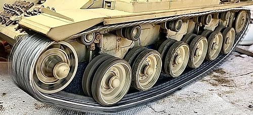

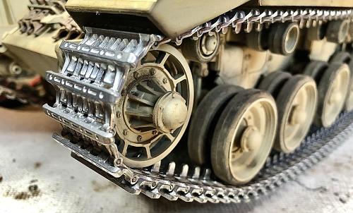

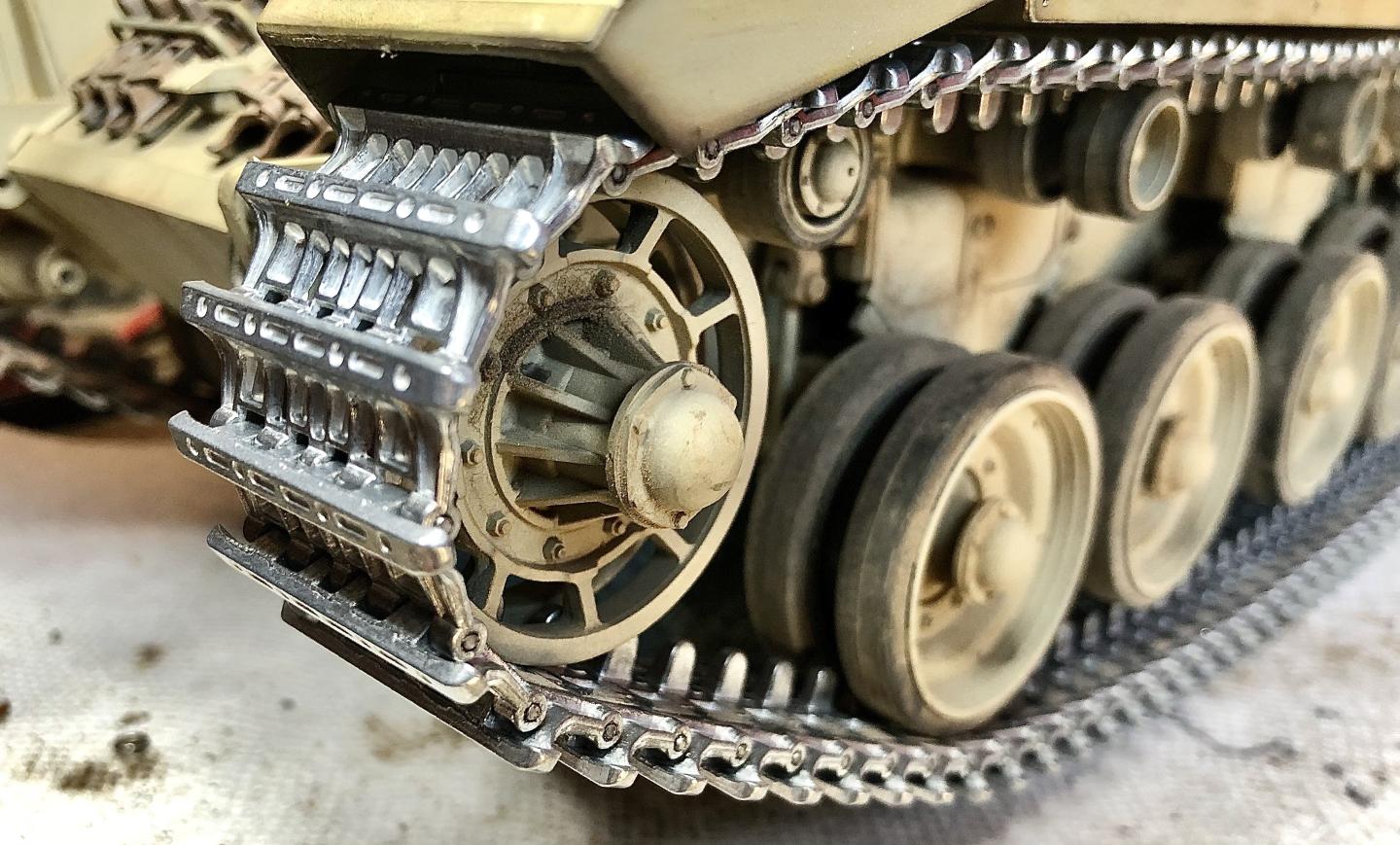

  • Rubicon99

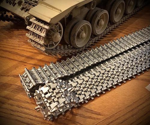

    Well testing of the DKLM metal tracks did not go so well. They have issues clearing dirt/sand and getting small pebbles jammed in sprocket wholes that cause the track to override the sprockets. This happens frequently and is not something that the tank can self right. It is also an NOT an issue the Tamiya tracks had.
    Second issues is the guide teeth hit the center “axle” area of the return rollers cause a very unpleasant grinding sound as the tank moves forward and an even worse grinding sound as the tank moves backwards. The “hit” is so bad that it even loosened two return rollers and required some repair work to them.
    At this time I would not recommend the DKLM metal aftermarket Centurion tracks to anyone that drives their tank in soft soils (dirt, sand, light mud).

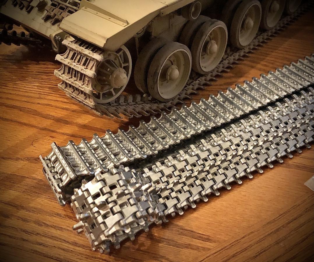

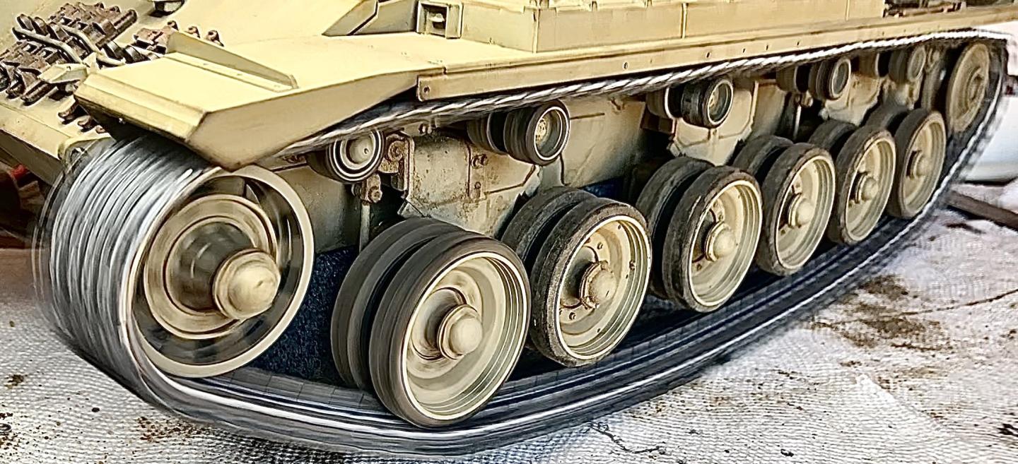

  • Rubicon99

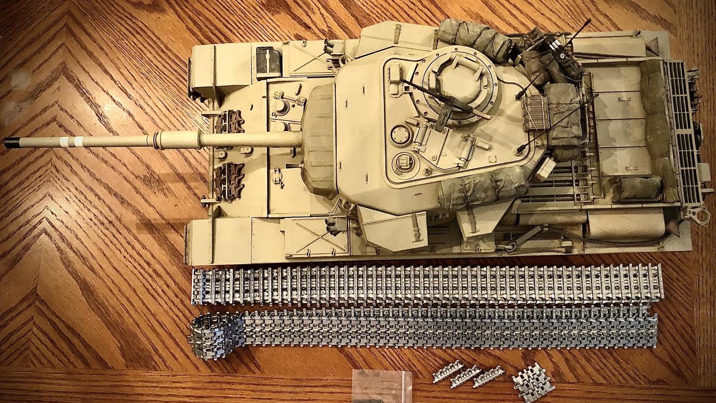

    Non weathered loose test fit on tank. Also a short video of the tracks running during fit testing is up on my Instagram @ fsttanks.
ID:	351477Click image for larger version

  • sclui56
    The metal DLKM tracks have arrived and will be installed shortly. They will be tested on my tank trials course and in the next IR tank battle day in San Diego on July 31.
    Excellent, hope to get some feedback on whether you find the idler+support are sufficient for the heavier tracks.

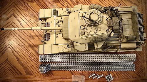

  • Rubicon99

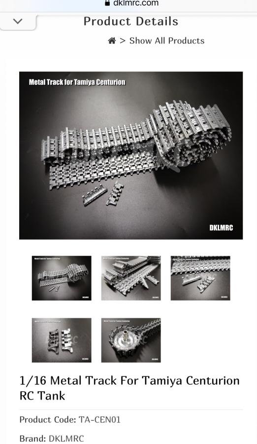

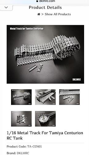

    Click image for larger version Name:	CD3414EC-9D25-4946-9929-0D717EC27307.jpeg Views:	0 Size:	59.7 KB ID:	349486 Just an update on the metal tracks from DKLM. Sadly there appears to be a set back. DKLM website clearly indicates “in stock” but apparently they are not available which is a bit misleading. They are only available for pre order and you must pay in full including shipping up front ~$200.
    DKLM indicates this WELL below the item listing of “in stock” that the tracks will not be available until mid July which really means these day more like mid August....LoL. Then factor in two weeks before they even ship them and then the “black whole” that is China Post and maybe we will see the tracks sometime in Oct 2022.
    Sorry about the bad news, I was looking forward to doing a full test and review on them as I know a number of you were looking at them as well and waiting to see what I thought.
    I would recommend NOT ordering them at this time unless you want your $200 tied up for an extended period.
    Hmm, sounds like the stock that is in is the stock of metal they intend casting the the track links from, lol. The good news is the stock Tamiya track is holding up well so far, so no rush on the metal ones. Thanks for the update.

    The tracks are available now on DLKMs website. They have 11 in stock at the time of this post. EXPENSIVE when shipping is added, but DLKM tracks are usually worth every penny.
