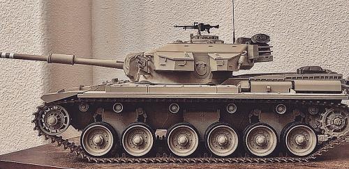

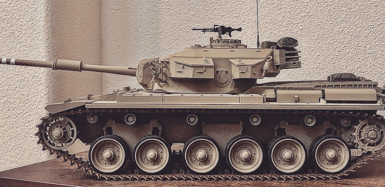

    Tamiya 1/16 Centurion tank.
    Finished most of the base weathering. Went with a light dirty look as the tank will become naturally weathered with dust, dirt, dried mud and grime rather quickly. Which in turn tends to hide applied weathering.
    The first test drive video of the tank in dirt is also now up on my Instagram @ fsttanks.

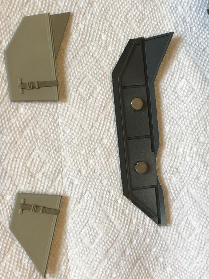

    One final step before I closed up the turret cargo bins. I added small magnets to the inside lids. This is to accommodate later accessories and have the ability to mix and match new items at will. Click image for larger version

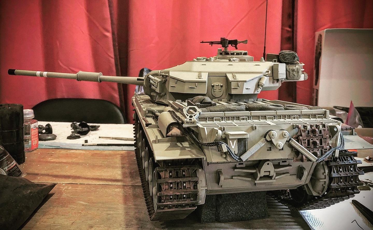

  • Rubicon99
    Tamiya 1/16 Centurion.
    BASIC tan paint on and some “dry fitted” kit test placement. Next up is detailing parts, weathering and then trials course testing.
