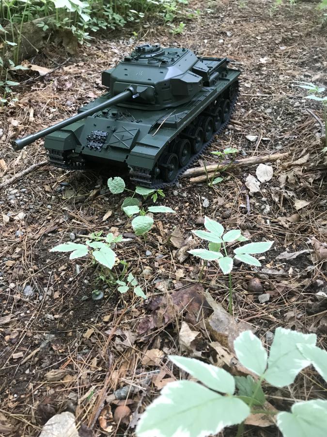

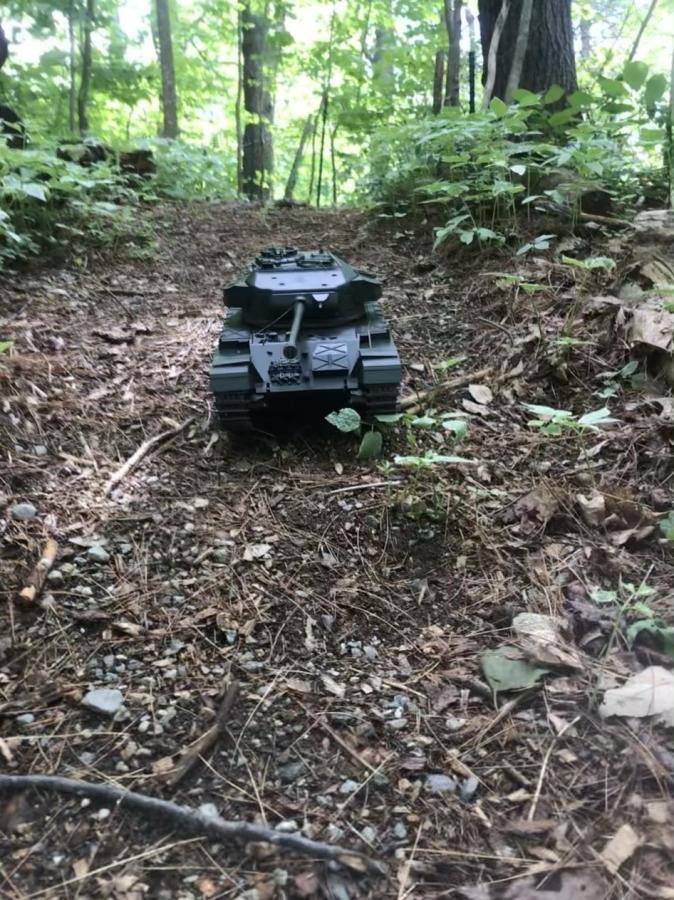

    Much detail work still to do but as soon as I had it running I had to take it out for a test run. It did very well on a bit over 3 scale miles of woodland path. The track didn't pick up much debris so clean up was quick. A marked difference compared to my challenger 2, which tends to badly clog its tracks. Once I get the skirts on this, we will see if it grabs and holds more stuff. It did pick up several confused aphids, no doubt wondering why something green wasn't edible.
    👏👏👏👏👏👍👍👍👍👍 Great to see another Centurion built and out in the wild!!!

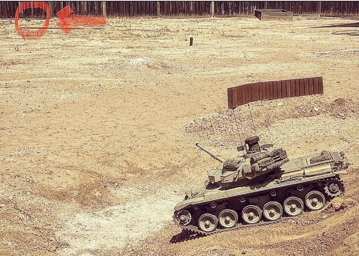

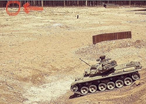

    Got some range time in with the new RichJohnson “L7 105mm” machined aluminum main gun I recently installed. The gun fit is better then the stock barrel (less wobbly) and this is much more accurate in all aspects of firing.
    Shown here the Tamiya Centurion with new “L7 105mm” gun is firing at a target tank ~ 50ft (~16m). Click image for larger version

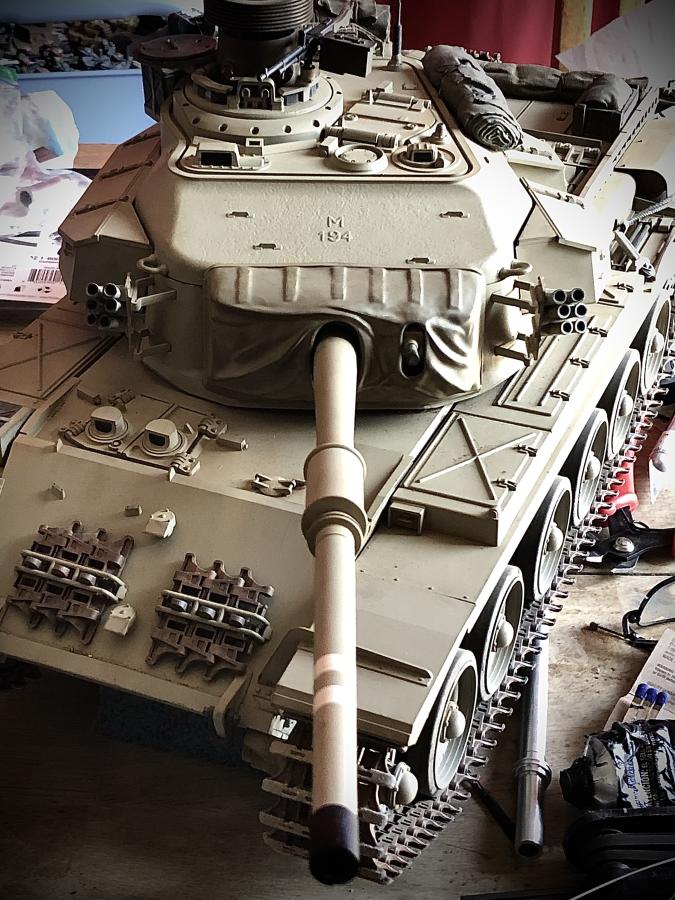

    Paint, weathering and IR bulb added to new barrel. Its ready to hit the field. Click image for larger version  Name:	68FA9B02-E043-4213-91E3-8A75A809CB19.jpeg Views:	4 Size:	125.5 KB ID:	345385

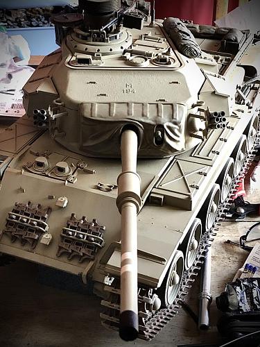

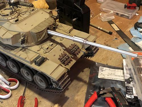

    UPDATE.

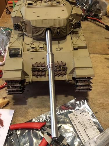

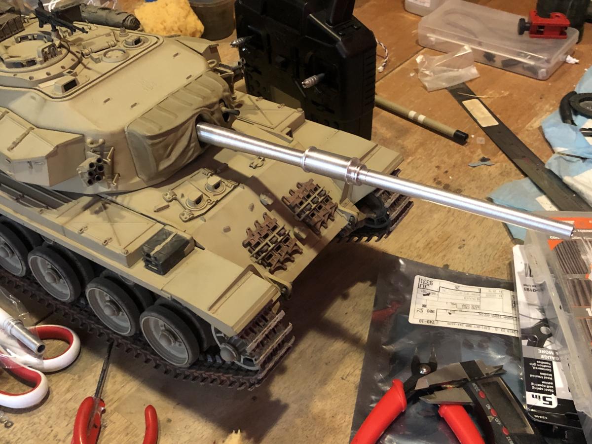

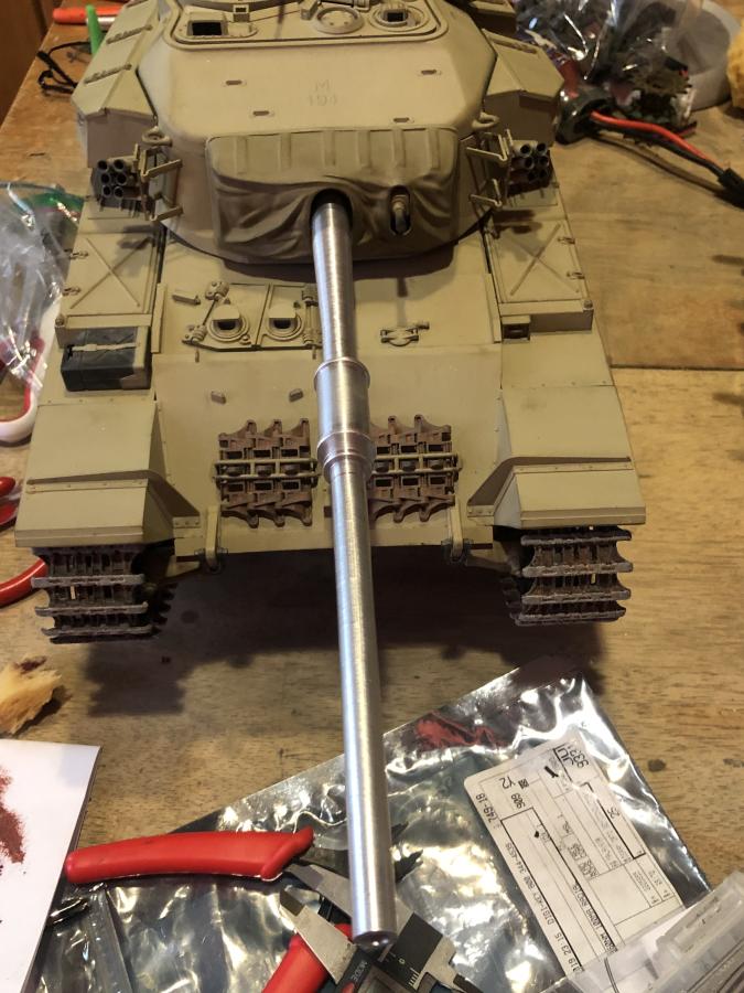

    Installed the RichJohnson “L7 105mm” main gun. This is a machines aluminum barrel and much better looking then my “stop gap” hand build L7 barrel. Still needs to be painted and the IR bulb installed.
    Here are a few photos. I also posted a short video of the barrel undergoing a basic function test on my Instagram @ Fsttanks
