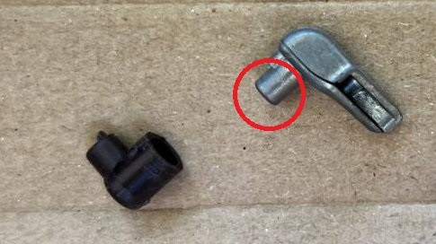

    The “black plastic” on my H-L’s are painted fiber optic.
    Must be the luck of the draw, the ones in my KV-2 are solid black plastic.
    Edited - I went back and looked again, 1 is painted clear like you said, but the other one is solid black plastic. Guess they didn't think it needed it since there was no LED in the rear MG.

      David, I agree the pricing is nuts, and they charge $5 for 2 pieces - how do I know? I had to replace the rear broken one on the JS-2. I have some Plastruct acrylic coming from Amazon (linked above), will let you know.

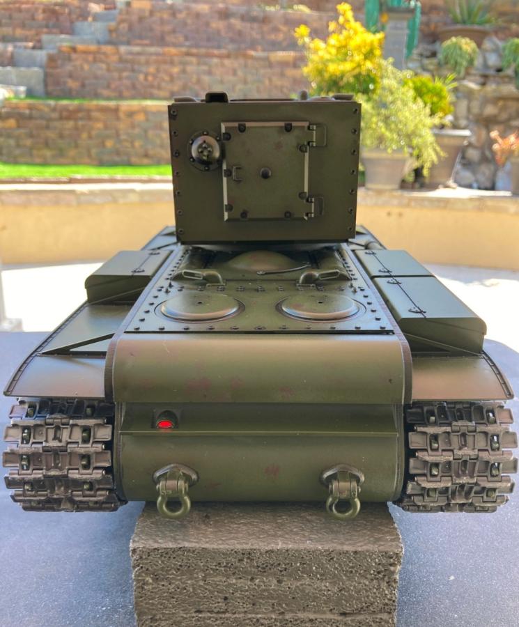

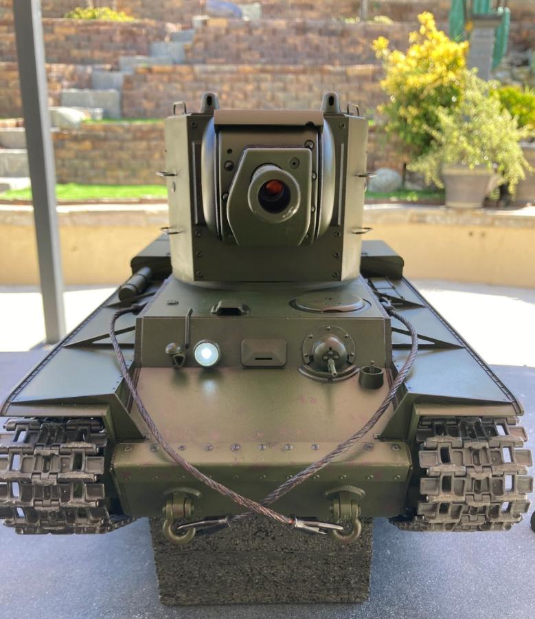

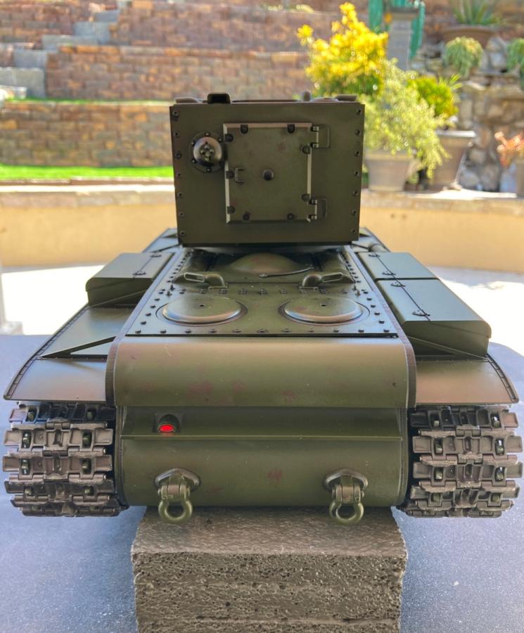

              Your Tami KV actually has the tail light, right? I originally used LED6 but ended up going with LED3 (always on). BTW, I used 5mm LED's, and with the cavity in the HL KV-2, all I did was slip a clear silicone tube (excess from smoke units) over the bulb and the assembly fits inside perfectly.
              Thank you for letting me know about the lights. My KV-2 has both front light and taillight. I had to play around with the transmitter in order to turn them on.

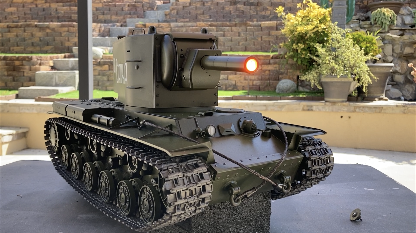

                #27

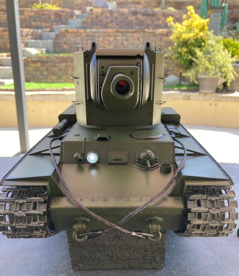

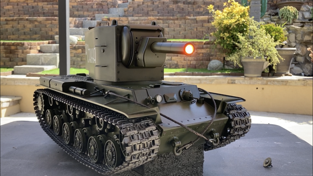

                And of course the flashing one in the barrel.

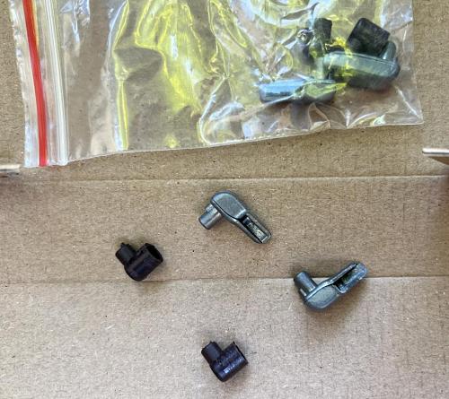

                    Speaking of right angles, I wonder if this smoker's elbows might work? A bit of brass tubing thru the deck for the new exhaust fittings and then into the black elbow?
                    Well, I was changing out the 380's to Tamiya's today and the left bank has about half the clearance of that elbow you showed in terms of space between the bottom of the deck and the top of the 380 housing. We need to get a bit creative somehow on the left bank.

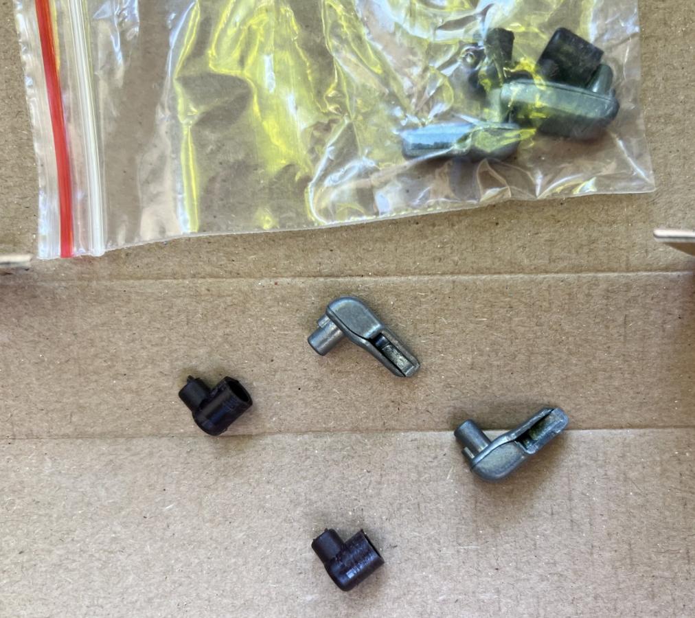

                        Bob,
                        There's plenty of space to relocate the smoker and will know soon enough how we can actually fit the exhaust. They landed in JFK on Monday and are handed off to USPS. BTW, I have been using these smokers and they are even better than the fan-driven ones:

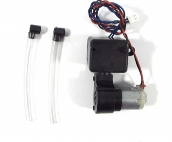

                        https://www.aliexpress.com/item/1005...21ef1802k4Zex6
                        EDIT - Bob, they showed up today, just PM me your delivery info and I will get those sent when I go to the office tomorrow.

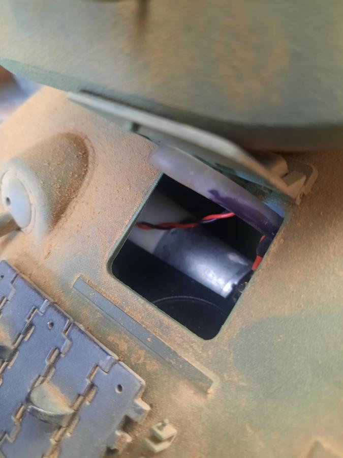

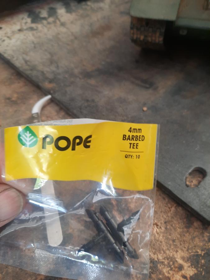

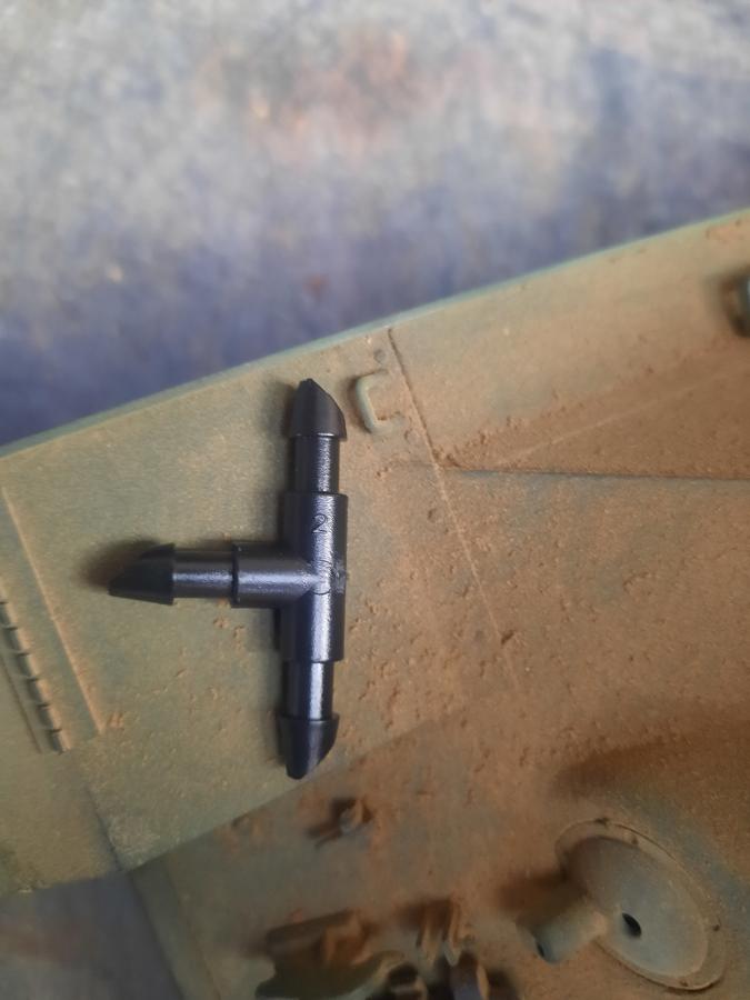

                                    Just realized I might have the answer for your exhaust plumbing problem, I used the same smoke unit for the t34 and ran into problems with room in the back of the hull. So I joined the 2 exhausts with some tube and one of these t joiners and put the smoker in the front. Cause I only use one outlet for smoke I use the other as a filler port Click image for larger version
ID:	339935Click image for larger version
ID:	339936Click image for larger version
ID:	339937 the small tube is the filler port

                                      Sappo, thanks. the problem is not easily solved by using a Tee, it has to do with how close the bottom intake tip of the left exhaust sits above the top of the left motor, a perpendicular (right angle) connector will render the top deck not sitting flush, and a silicone tube will just get pinched. I understand your solution in the T34, I was able to work around that much easier in the T34, but the KV is a bit tight even though there is more space inside.
                                      BTW, I was hoping Bob would answer your tensioner question, I don't have the 1 so don;t really know.
