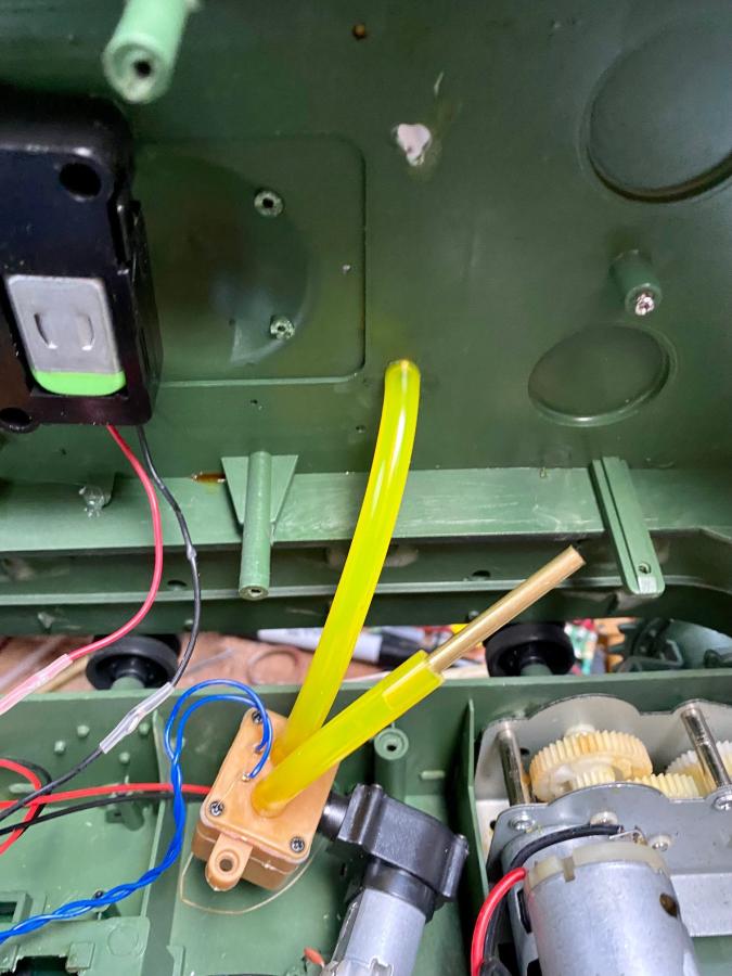

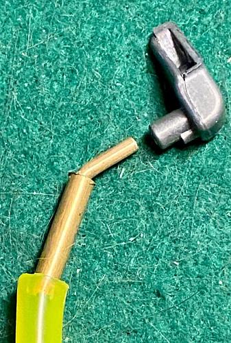

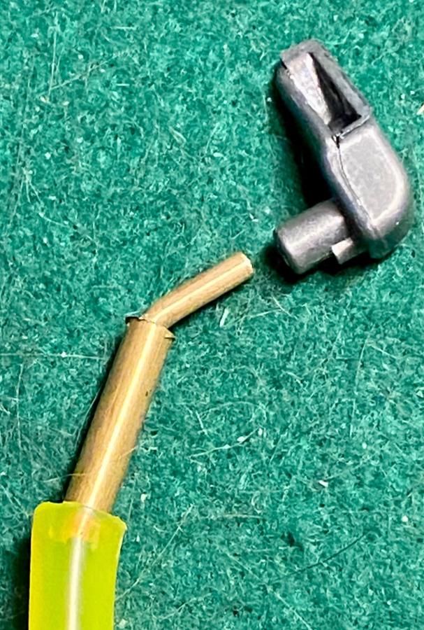

          Stephen, this is what I came up with:
          A small diameter brass tube fits into the vent.
          Make a 45 degree bend in the tube Just put two metal rods inside and bend it all. It reduces the tendency to kink the tube.
          Put a larger brass tube over the smaller one.
          Put the fuel tubing over the brass.
          I did this much per the photo to see if the smoke would go through. It did, using an old piston smoker. Of course, more smoke came out the other vent, the one without the brass.
          HOWEVER! It still doesn't completely clear the motor can.
          To actually make this work, some of the fitting will need to be cut off, basically the part that sticks out under the deck. It would have to be cut flush, or nearly so.
          I won't do this yet, for two reasons. First, I want to check that the fan operated smoker I have on order will also blow the smoke through the small pipe. Second, if I could find a rubber tube with a small enough diameter, I could put that into the fitting and snake it down to where I can insert it into the larger fuel tubing.

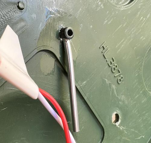

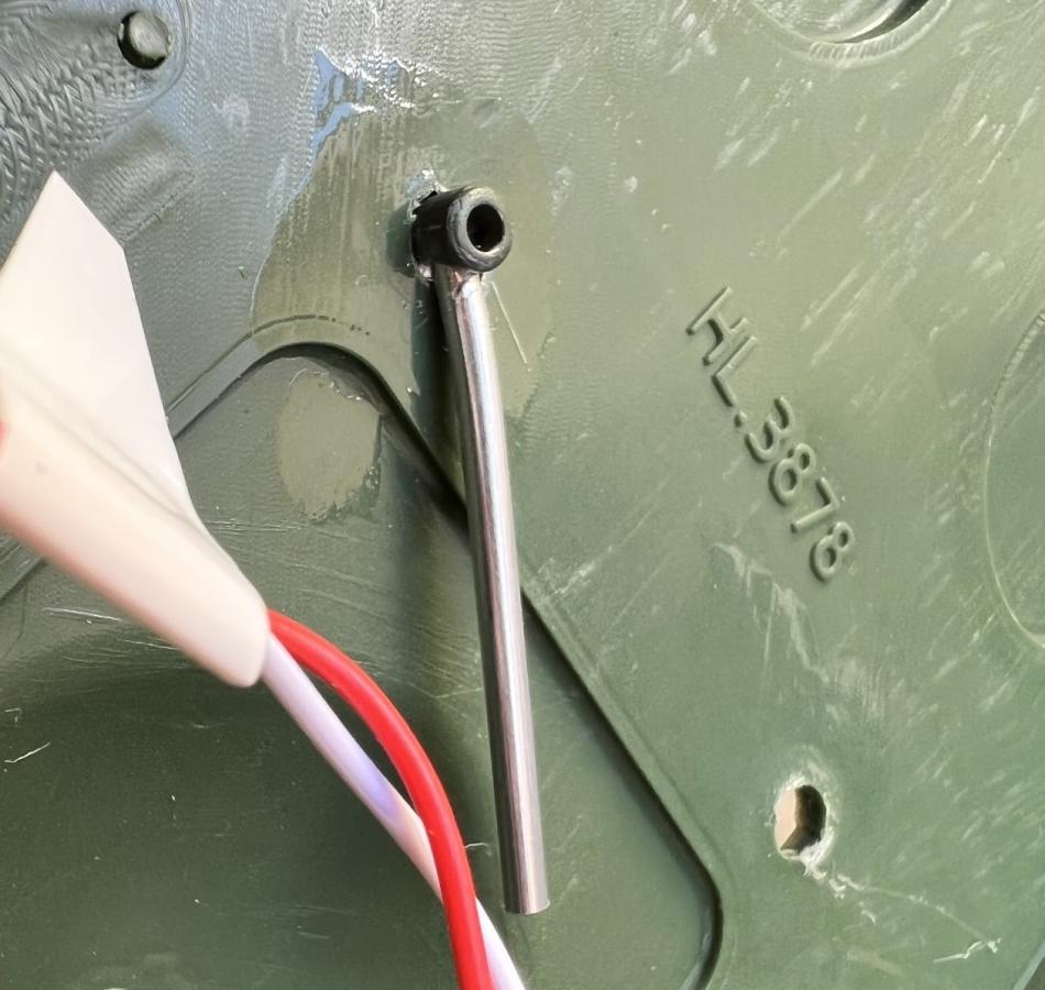

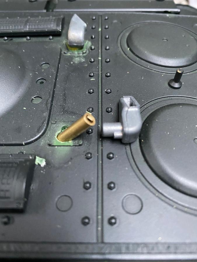

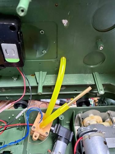

                  I did that diagonal drilling you mentioned, and that tube clears the motor just fine. I'll be cutting into the vent at an angle so the brass tube will fit. I connected both tubes to the smoker and ran it up. Smoke coming out of the top looks spectacular! Well worth the tinkering.
                  Before I start drilling the vent, let me know if your setup clears the motor. I'll alter my plan accordingly.
                  Click image for larger version  Name:	IMG_2256.jpg Views:	0 Size:	67.9 KB ID:	340265

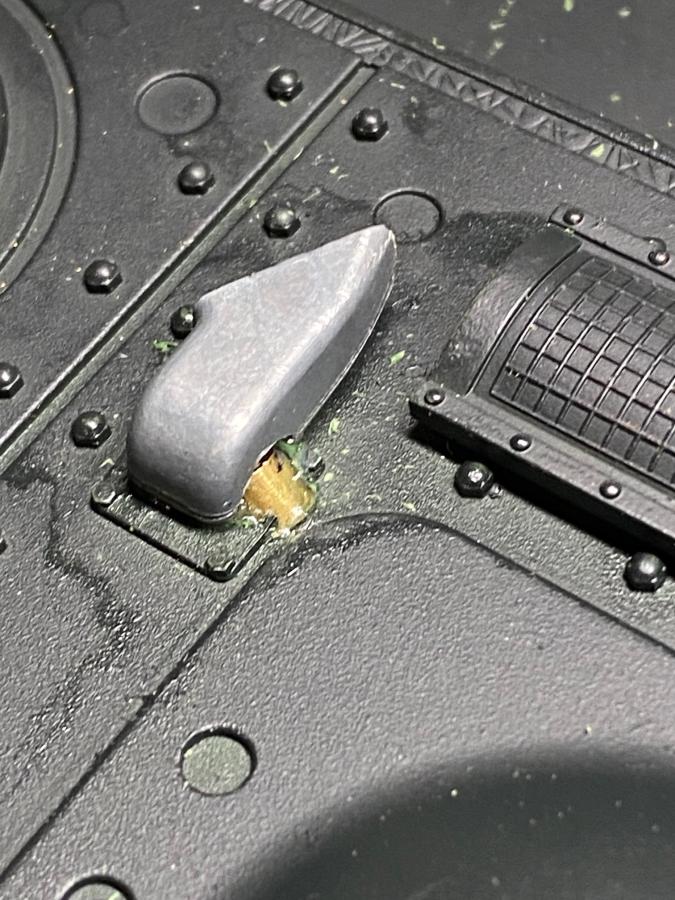

                  Also, I'm using silicone fuel tubing and I did something for the other vent. I drilled the deck to have the tubing fit through and pressed the vent directly into it. After seeing your photo, I put the right angle fitting into the deck hole, and the tubing onto the fitting.
                  Click image for larger version  Name:	IMG_2255.jpg Views:	0 Size:	72.3 KB ID:	340266
                  When this is done, the vents and tubes will be permanently attached, with the tubing just pressed onto the smoker.

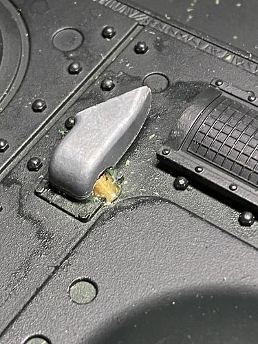

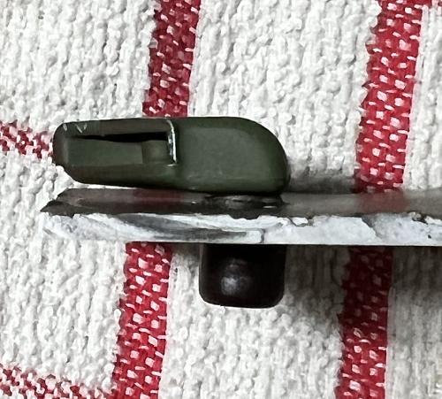

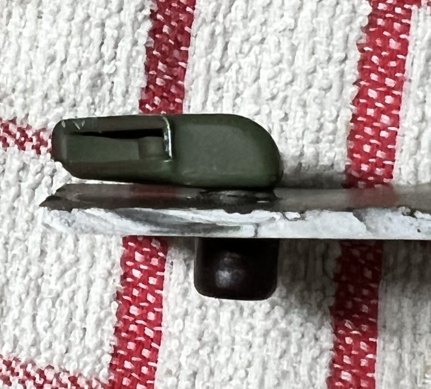

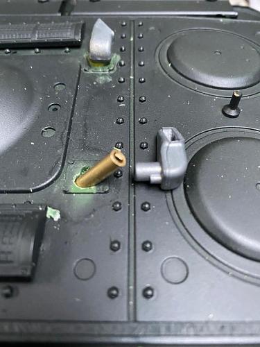

                      Here's what I did. That brass tube you saw sticking out from the deck? I drilled and routed the vent to accept the tube. I have to plug the original venthole, and seal around the join so no smoke leaks out, but smoke billows out of both vents! you see a small amount of the tube, but with dirt and weathering it'll be pretty inconspicuous.

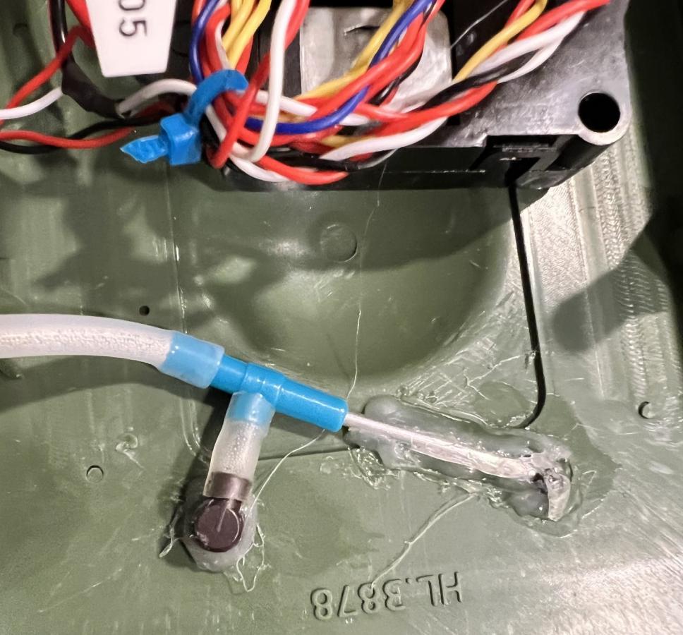

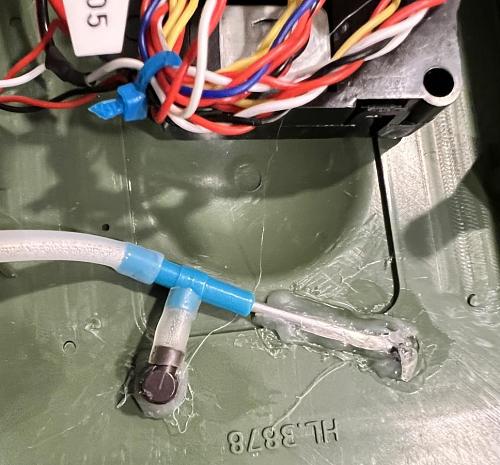

                        First of all, congrats to the new arrival! The kicking one... BTW, I ended up staying with the original route on the left side, i.e. use 3/32 aluminum tube perpendicular to the exhaust. Please excuse the hot glue mess, I wanted to be sure before making it more permanent.
                        There's really not much space on the left, I used hot glue to block the original input tip at the bottom, I had to make to nearly flush, otherwise, even a blop would cause a lift of the deck, so close to the left motor can.
                        Click image for larger version  Name:	IMG_0124[89811].jpg Views:	0 Size:	114.3 KB ID:	340288
                        If you look at the video in the link below, the left has less volume, as expected due to the input size. https://drive.google.com/file/d/1-MQ...ew?usp=sharing

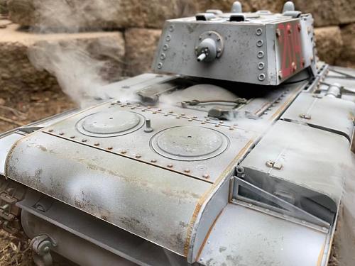

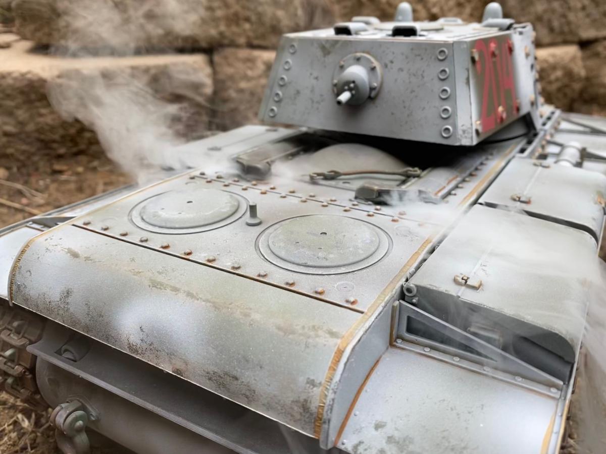

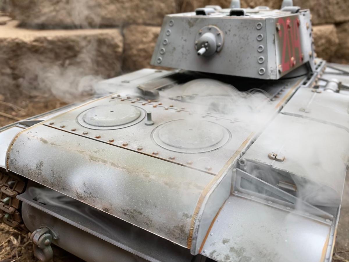

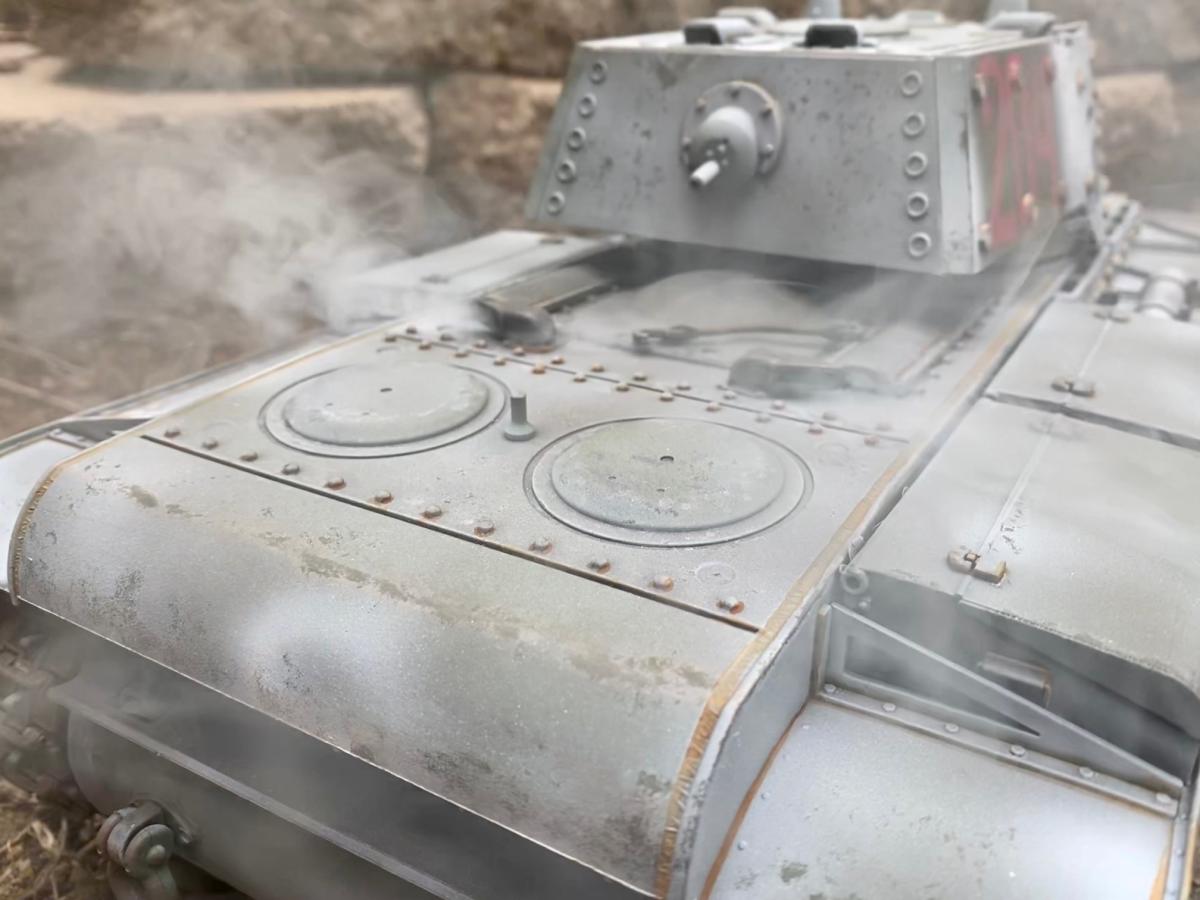

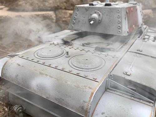

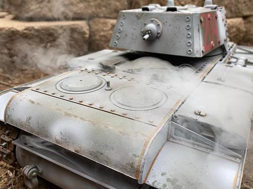

                                Oops, I was cleaning up my Youtube videos, deleted this one. Instead, here are some photos of the smoke output from the deck vents. I'm using a stock Heng Long smoker, the one with two sets of wires, "mega steam" smoke fluid, and I positioned the smoke box so that gravity brought the fluid down reliably. I'm guessing a substantial part of the smoke problem is that the fluid just doesn't drip down well if there are bends in the tubes and fixtures.
