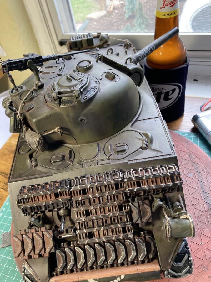

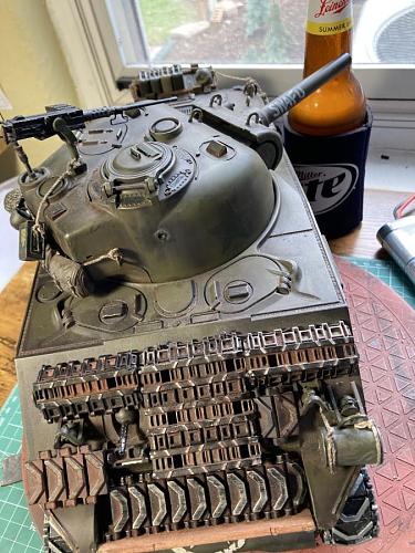

    Hello guys. I finally had some time to play with tanks. I spent two beers working on the 105.
    1- Dremeled out the center exhaust deflector slots. Also drilled a hole through the top exhaust nipple and plugged the lower port. Using mega - steam. Thank you SoCal. Much better smoke when wanted.
    2- Unplugged LED 3 and 4 for head and tail lights. I never liked having them on.
    Now for the questions and another beer. (Leinenkugel's Summer Shandy, because it's 93 outside)

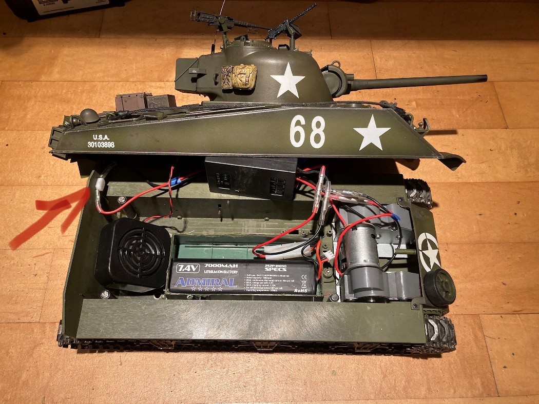

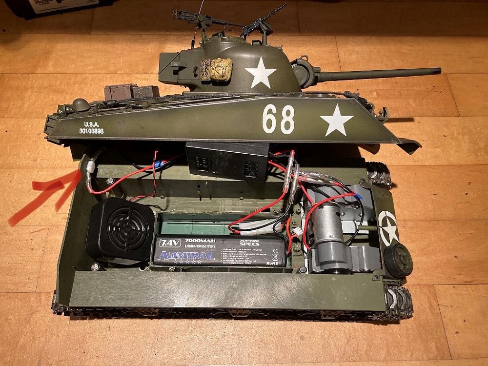

    Here is my M4 105. I cut the battery compartment and put the battery in from the top. I no longer need to flip the tank over to open it from the bottom. I also use magnets to easily open the upper hull. The on and off button can be pressed from the outside at the rear (red arrow). This was Bob's idea. I don't like the smoke feature so I took it out.

      Actually, it is no longer a M4/105. It is now a M4/75.
