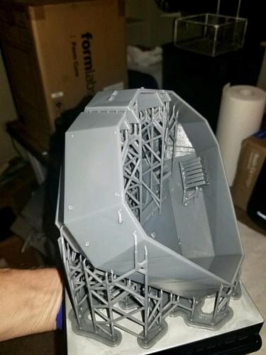

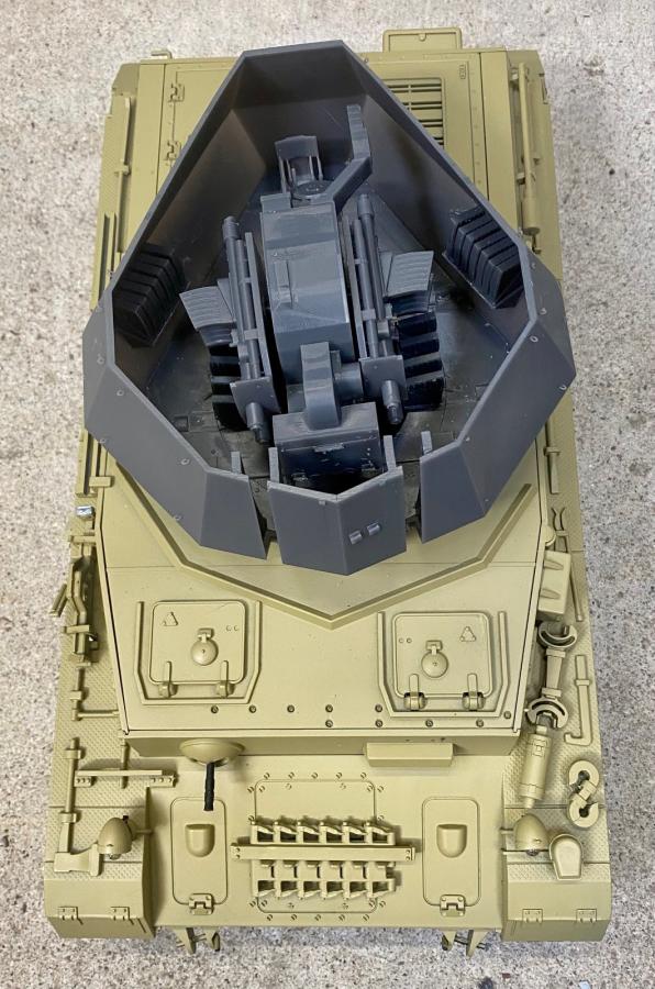

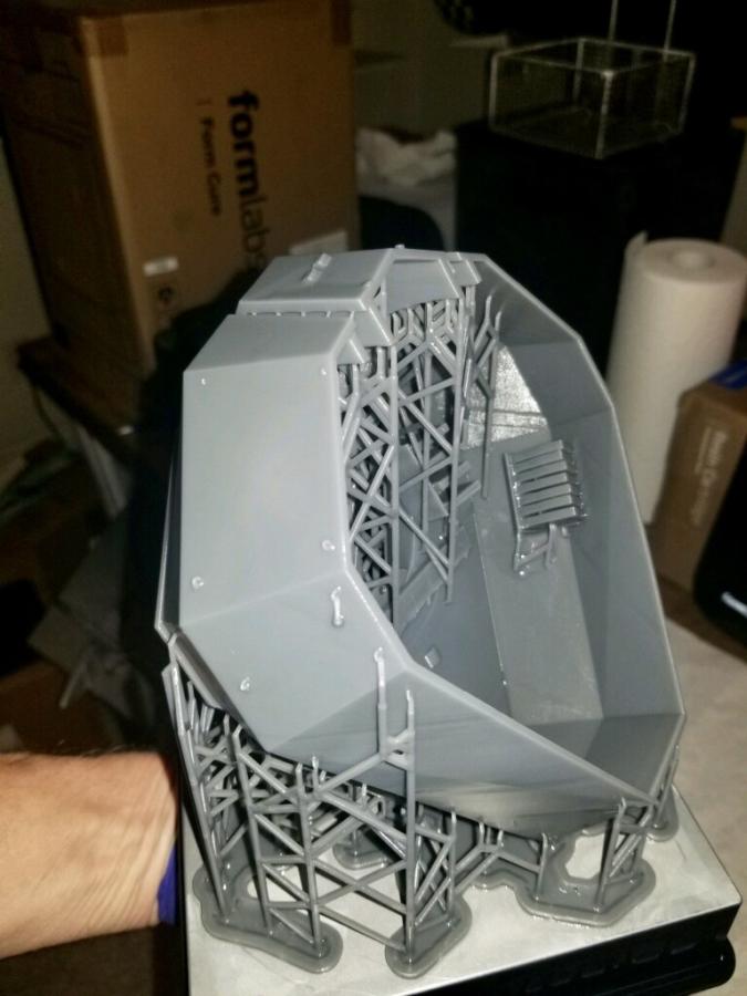

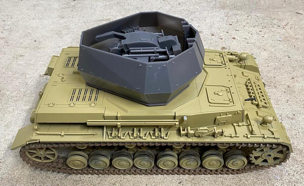

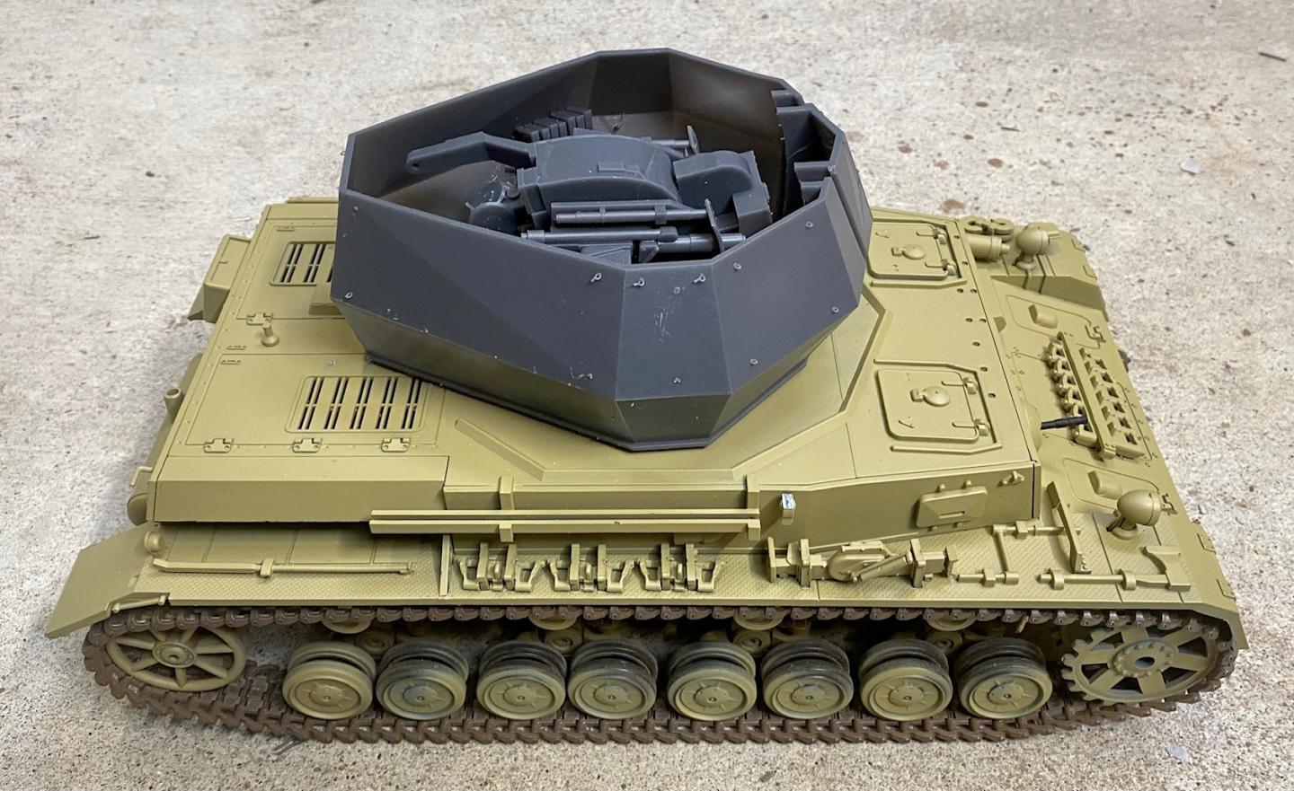

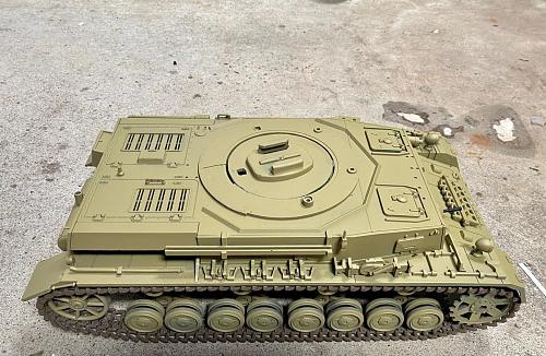

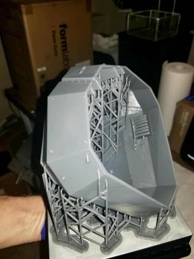

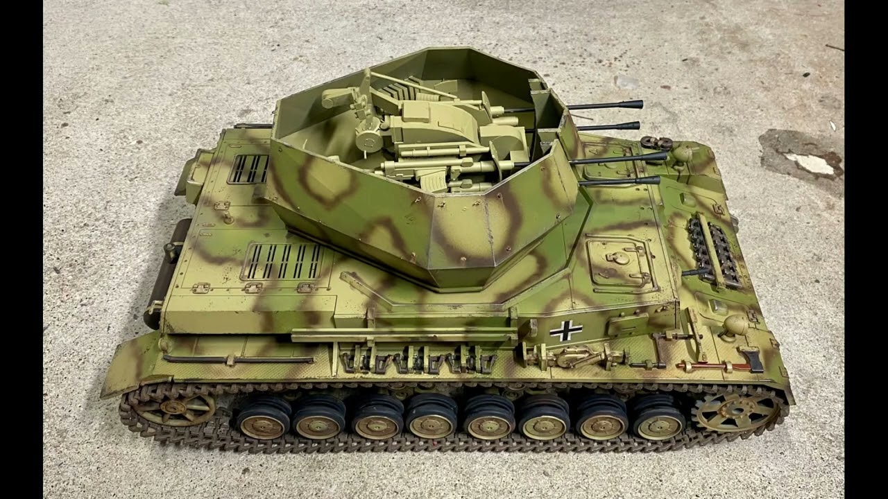

    My intrepid printer buddy has manufactured the 3DP parts I need to convert a Heng Long Panzer IV to a Wirbelwind. Now it's up to me to see how much customizing I can accomplish. Rotation and elevation is straightforward. I'm planning (hoping) to insert LED bulbs in the barrels. I'd use the machine gun circuit to activate them. I may even use spare HL IR bulbs that I removed for stronger ones from other tanks. That way I could fire the mg circuit for 5 seconds which will cause the main IR to fire, but at a shorter range. Or nothing may work, and it'll be just a showpiece! We'll see.

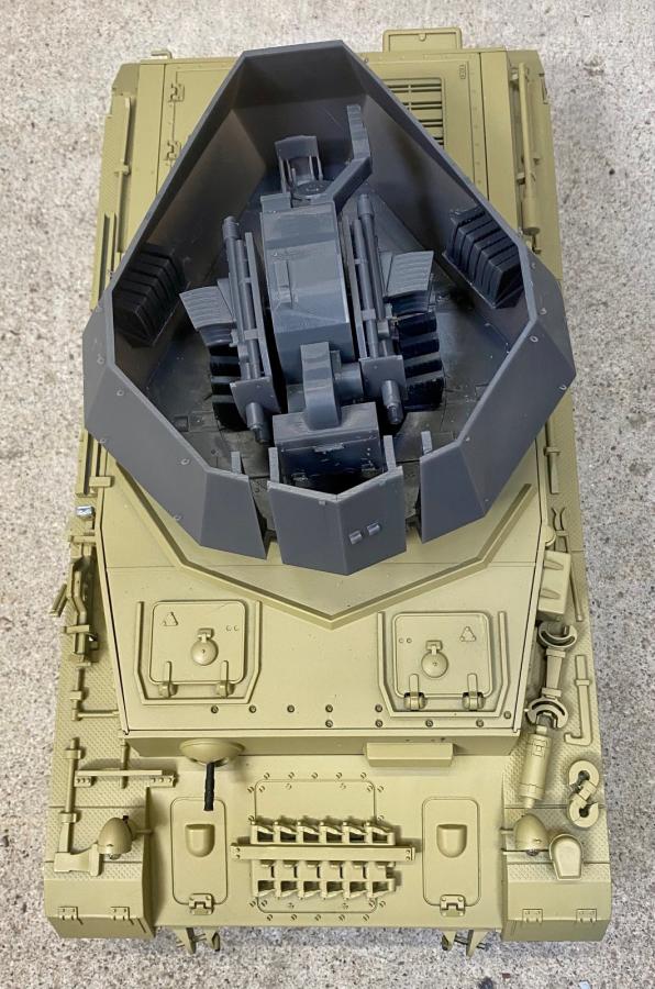

      Pretty large...

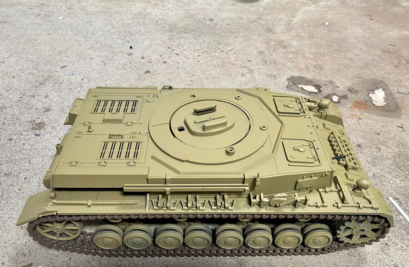

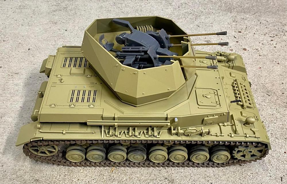

        Another step. Turret painted with base color, barrels installed. Barrels are brass rods, At some point I'd like to substitute tubes with LED's inside so the rods are just press-fitted.

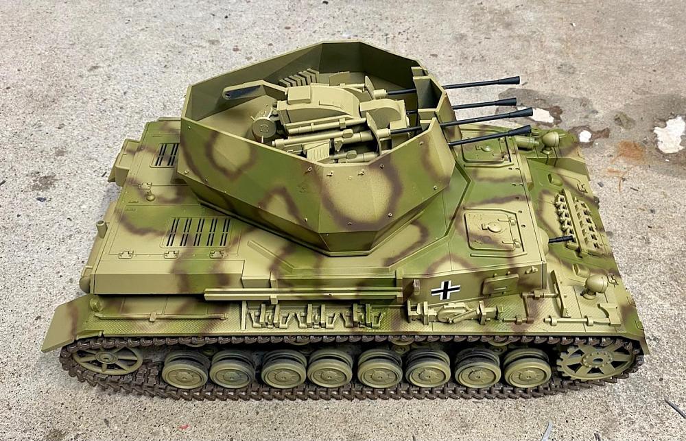

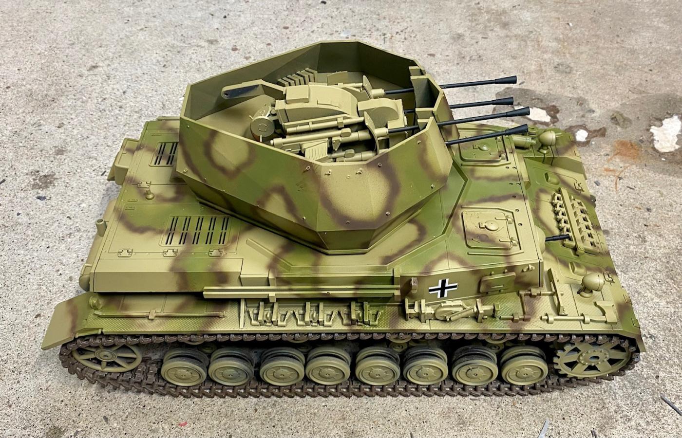

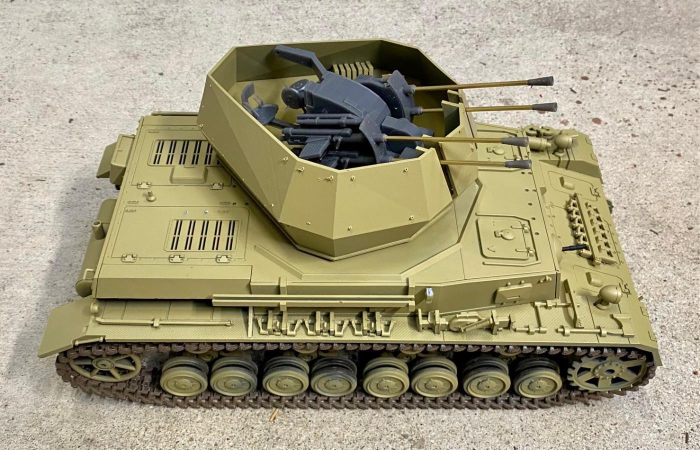

                            Camo. My airbrush was a b*tch today.
                            Twenty six tanks, and not done yet!

                                Looks great. Love the camo - it’s almost exactly how I was envisioning it should look when I saw it in just dunkelgelb the other night.

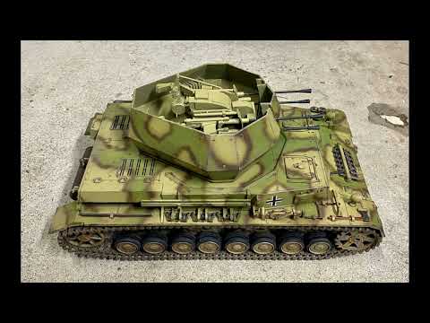

                                  Loaded a new clip for you on Youtube. Back on Post 5 I linked a progress video. I've since deleted it in favor of this finished version, showing the tank outdoors. Same intro, but the second half has been changed.

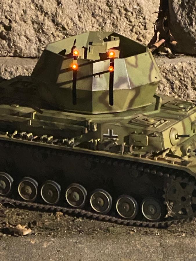

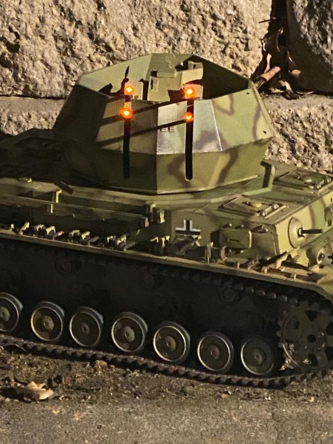

                                    I finally installed four LED's. They're connected to the machine gun circuit, so they flash simultaneously. The photo is taken under some house lighting outside at night. The LEDs are "pico", 1.3mm in size, with hair thin wire leads. Very faint in daylight. I'm happy I was able to do it at all! There's a little surprise hidden between the two left barrels; an IR emitter bulb!
