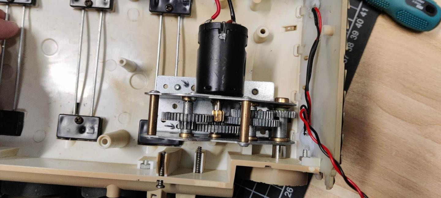

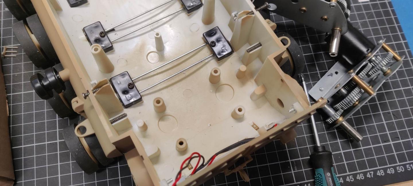

                                      Someone I know in Asia got one already.
                                      He tried to fit HL tranys in. They do not fit at all. Here is his assessment photos.
                                      Probably going to have to make a false support base in the bottom of the hull and then drill out and bolt through the bottom of the hull to upgrade the tranys.

                                        Aside from the issues with having to try and install aftermarket gearboxes there is another obvious issue. The longest drive shafts available are 59mm. Even with these the shafts will be to short to achieve proper sprocket to track alinement. I suspect TD saw this during development and it is way they ended up not using a HL style of gearbox and would also not comment officially saying HL style of gearboxes would be directed drop in or easily fit when asked numerous times.
                                        DKLM had this same issue with their first M60 and had to add a lengthening spacer between the shaft and sprocket hub to enable the use of HL/Taigen gearboxes. Even with this the DKLM M60 had track to sprocket issues because the sprockets do not fit as tightly as they should and wobbled.
                                        The solution some end users had to do was to have longer one piece shafts custom made, but this is not an option for the majority of folks that will be wanting to upgrade the gearboxes in the TD M60.
