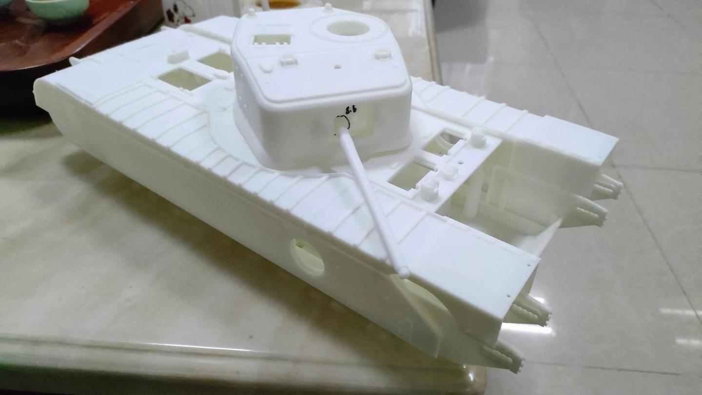

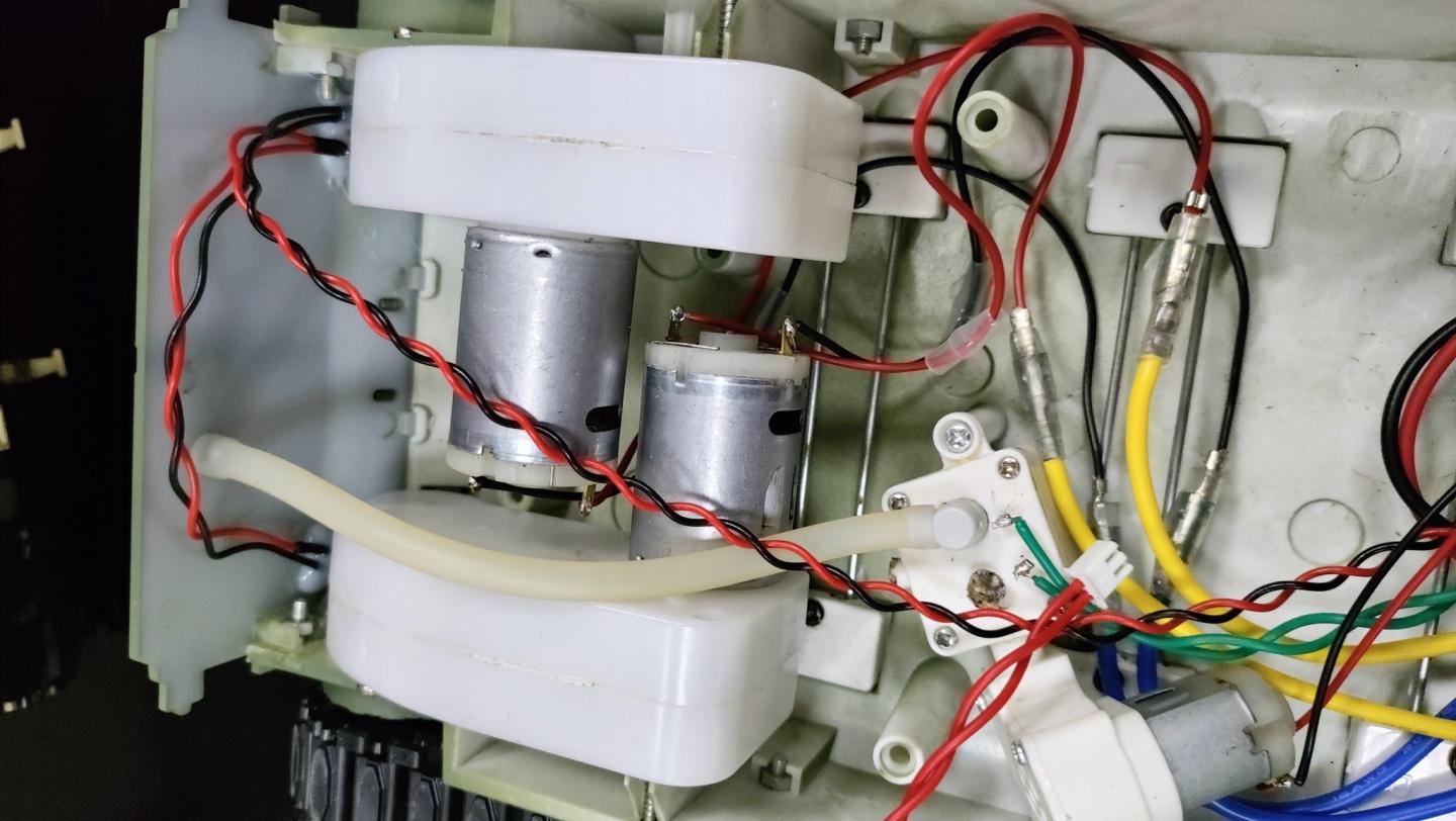

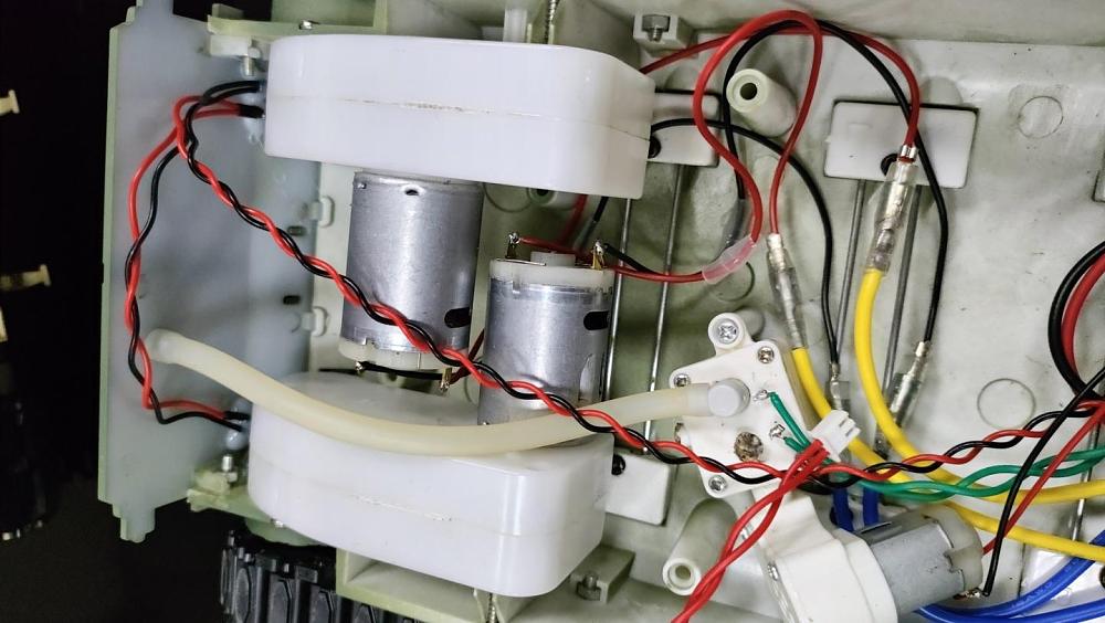

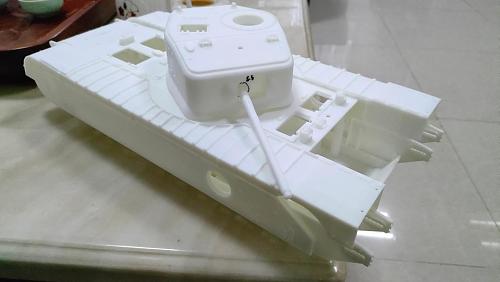

This is clearly just one of the prototype lower hulls🤞🤞 because if it is not I see a few issues.Originally posted by Delta_19 View PostMore pressure changed his tune.
We have plastic gearboxes, plastic suspension arms, torsion bar suspension and, adjustable idlers.
still no idea what the IR battle system is and he also states that more metal parts will come out in "phase 2"
One it is 3D printed and 3D printed lower tank hulls are known to be rather weak compared to the nylon type plastic hulls of HL tanks or toy market segment tanks.
Two there is NO battery box or access point for the battery which means taking the upper hull off to access the battery. Yet seeing he is using what appears to be HL like body & screw posts would indicate the hulls are screwed together? He might be using some type of latching method or magnets not seen in the photos, but that would be a poor idea given that this is a “toy” tank intended for kids. Giving a young child access to the internal workings of a “toy” is a recipe for....... well things to go wrong.

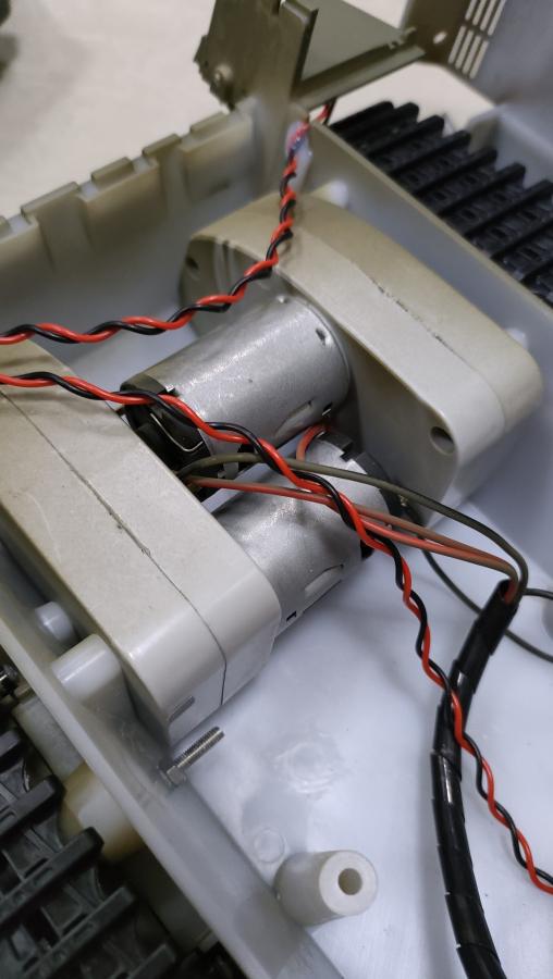

Third are the gearboxes. I recognize them and they have never been quality ..... parts. Let us hope the production tanks keep the mounting points for the HL transmission as Mr W has said would be included so the shown gearboxes can be replaced upon opening the box.
Like any tank there will be needed aftermarket changes to make these more durable and nothing I am seeing can’t be overcome and improved upon once we get these in our hands.

Based on the photos of his upper hull there is no battery access hatch, it is clearly a one piece hull. Any hatch in the rear would only open up to the gearboxes and or smoke systems and not provide enough space to easily remove or insert a battery. Remember this is in his words a “toy” intended for children. In which case the battery access needs to be simple like HL or the newer Tamiya tanks.Originally posted by Delta_19 View PostAs for the battery access it could be a hatch on the top or rear.

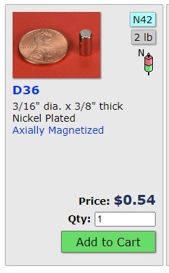

I'm not sure what he means by a charging head on the power switch. In any event after 25 years in the r/c hobby, I'd be reluctant to charge a LiIon battery in a vehicle, especially without using a balance tap. And knowing that the constant tightening and loosening of screws will eventually break the plastic posts, I think magnets will have to be the solution. I'm going to try this shape. It should fit into the posts after I drill out 3/16" holes. I'll test it on my Heng Long tanks and let you know.
I'm ordering these from "K&J Magnetics" online. Lots of goodies there!The more screws it takes to reassemble a tank, the more likely it is you left something out!
I'm ordering these from "Evan Design" online. Lots of goodies there!
