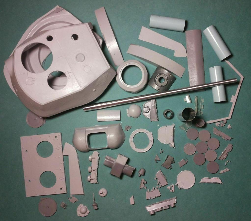

        tank-me, I bumped this thread because of your post regarding the KV-85. Somewhere back then (2022) there was a conversion KV-85 turret to put on a Heng Long KV-1. I'm making a poor man's version with a KV body and a t-34/85 turret I have lying around. I can't find a file for the real turret. Any tips? This was in my picture folder. Ring any bells?

          Yup, that's the Jukenburg kit. It's still available https://mk-modellbau.de/main_bigware...9&items_id=635. As far as an IS turret...hmmmm...I know of a 3D printed one at Thingiverse, but it's for an IS-2 and it's not very detailed (IE: bad). I'm not sure if the other files I have for the IS-2 early and late has the early turret or not. I can check after work.

            The files that Inkor produces does include the early turret. The only real difference between the early turret and the 85mm version is the mantlet from what I can see.
