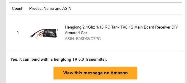

    Awhile back I bought a TK 6.1s from Toucan's Amazon store. I know they are no longer being made, but last night they were still being listed as available for purchase so I attempted to buy another. About an hour later I received an email from Toucan through Amazon:
    "尊敬的 Kenneth:
    感谢您的惠顾。
    在完成您的订单时,
    亚马逊卖家toucanhobby遇到意外问题。
    来自卖家 toucanhobby 的消息:

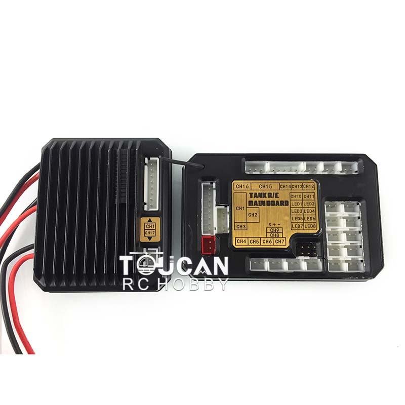

    Hello, Kenneth We are very sorry, you bought a TK6.1S Main Board from our store is out of stock, but we have a mainboard with the same function as the Henglong mainboard, which is also applicable to the Henglong tank. As shown in the figure, its price is $50, we can send this mainboard to you to replace the TK6.1S Main Board. We will refund you the difference between the two. Is it OK? Looking forward to your reply. Sincerely, Orange"
    Click image for larger version  Name:	CS-RC61-MAINBOARD.jpg Views:	0 Size:	71.9 KB ID:	362744
    Has anyone seen this board before? Does anyone own this? Use it? I see no model # nor manufacture markings to identify. I would like to hunt down the pinout and investigate further.

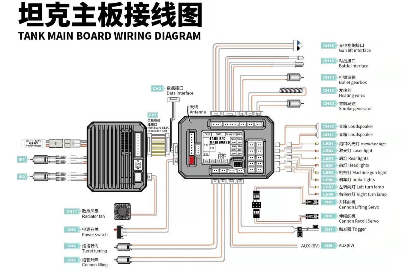

          I don't have any info about the radio and I've never owned one, but sometimes I collect info about other boards just in case. As an FYI the pinouts are like this:

                          This's CS TK 16S from Canchou company. It's spec as Heng long 6.1S and can control with Heng Long 6.0 or 6.0S radio. The sound from 2 speackers are so lound. And I reccommend Mabuchi 380-4270 (add 104 capacitor on) to run with 2S, 3S lipo battery. https://www.youtube.com/watch?v=UkS6VRqNHBk

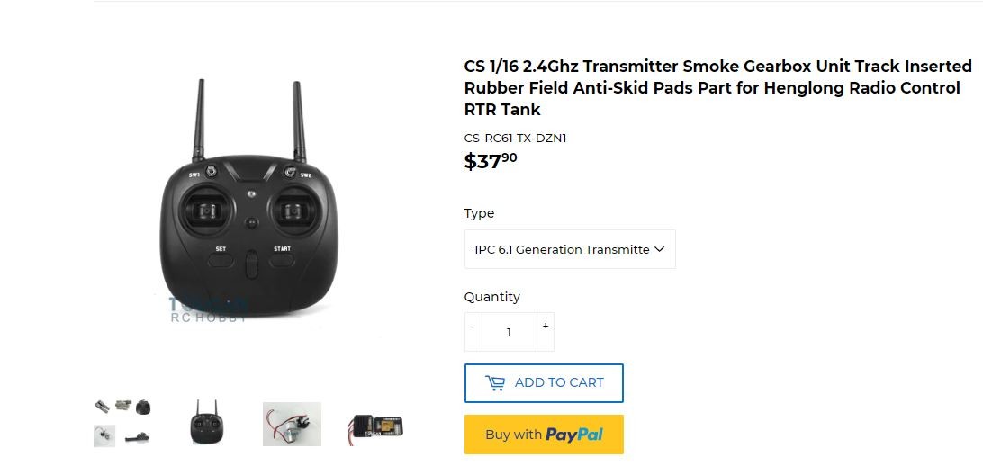

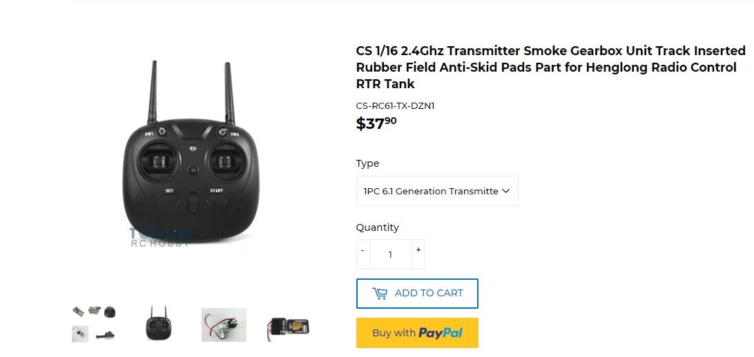

                                    Thanx Clay. Im not sure what to belive at this point. I have one Toucan rep telling me it will bind, and another saying it wont. The remote one rep is telling me I must use is this one:
                                    However a little voice in my head is telling me someone at Toucan is trying to milk me for another $40. The price point of the MFU is too compelling to ignore.

                                      If your concern in Post 12 is, does a 6.0 TX bind to a 6.1 RX, absolutely yes. It runs both 6.0 & 6.1, I do it all the time. A 6.0 will NOT run 7.0 & 7.1's and vice versa. The two versions are not compatible. If you're asking if that two-part board would work with a 6.0 TX, I'd be skeptical. If you look at your 6.0/6.1 manual, you'll see that many of the channel numbers are not the same. For instance "turret turning" on the mystery board is CH4, and "Cannon lifting" CH5. For a 6.1 RX, it's CN3 & C$ 4 respectively. I also don't see the V S G K buttons on the mystery TX, or the MG & Cannon buttons on top.
                                      • Zippersnapper
                                        Insane Unknown
                                        • Mar 2021
                                        • 502
                                        • SW Texas
                                        #20
