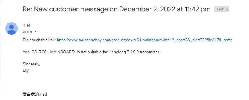

      Are you planning on buying a CANSHUO MAINBOARD​ ?
        I did. One of my radios should bind with it.

          Sweet. Please post results when you get. I received yet another email from Toucan claiming it wont bind:
