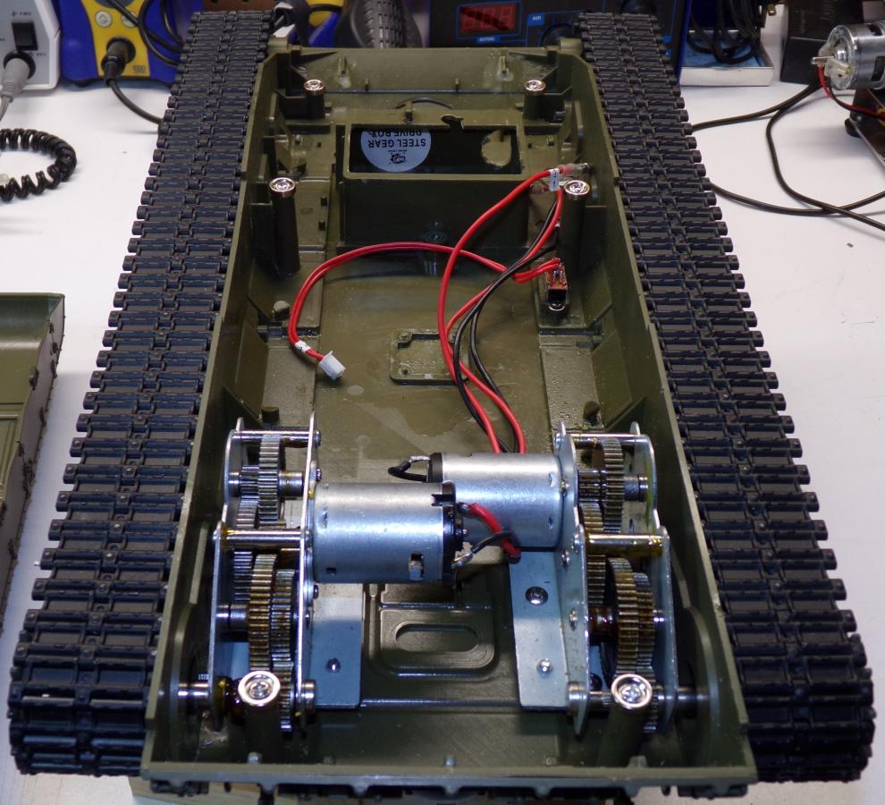

      The Russian T-90 & T-72 takes a battery half as long as all the other Heng Long RC tanks. That is why I would want to install a battery that has more mAh than the 1800mAh that comes with the tank. Especially if I want to install the all metal threads and wheels. Can only fit a 2S (two cell) battery.

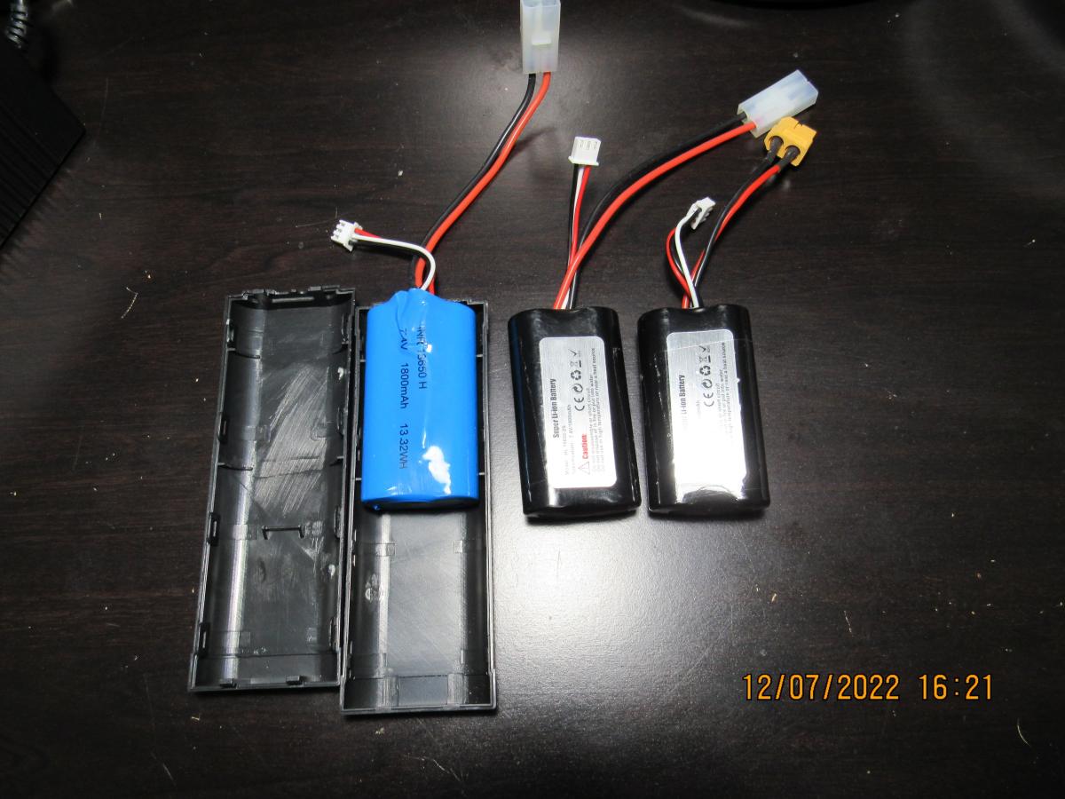

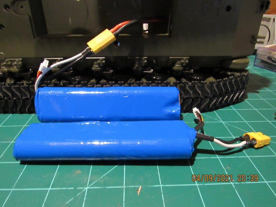

          I use home built battery packs for my tanks. Half of them are 2S 26650 and half are 2S2P 18650. The only commercial packs are 3x 2S 18650 that came with the tank purchases in the last 1.5 year.
          Click image for larger version  Name:	IMG_5125.jpg Views:	0 Size:	116.9 KB ID:	363134
          The first one came with German Leopard 2A6 was encased in a plastic hard shell to simulate the NiMH pack. The later one with T34 and Sherman are in common wrap package. HL rate them all as 1800 mAh. But the way I use them, they are only 800 to 1100 mAh as measured by the B6 iMAX charger which allows them to run the tanks with heavy tracks at full top speed for about half an hour. Typical normal on-off operation run time is much longer.
          I charge the pack to no more than 8.2 volts and the HL MFU stops when voltage drop to about 6 volts. Over the years, I learn that I can recharge the Li-Ion pack to several hundred cycles by avoiding overcharge and overdischarge them.
          Using the same methodology, my home built packs are rated at 4800 and 5600 mAh. They can run the HL at full speed for 2 or 3 hours. The key to the long run time is to use premium Li-Ion cells such as the Panasonic or Sanyo NCR18650. I use EBL cells and get similar results. I have not use NiMH or NiCd pack for many years and cannot comment on their performance. I like the Li-Ion pack much better.
            Click on this and go to 11 minutes into the video: https://www.youtube.com/watch?v=2_jTy1Yaj1A
            Then you will see what I'm talking about.

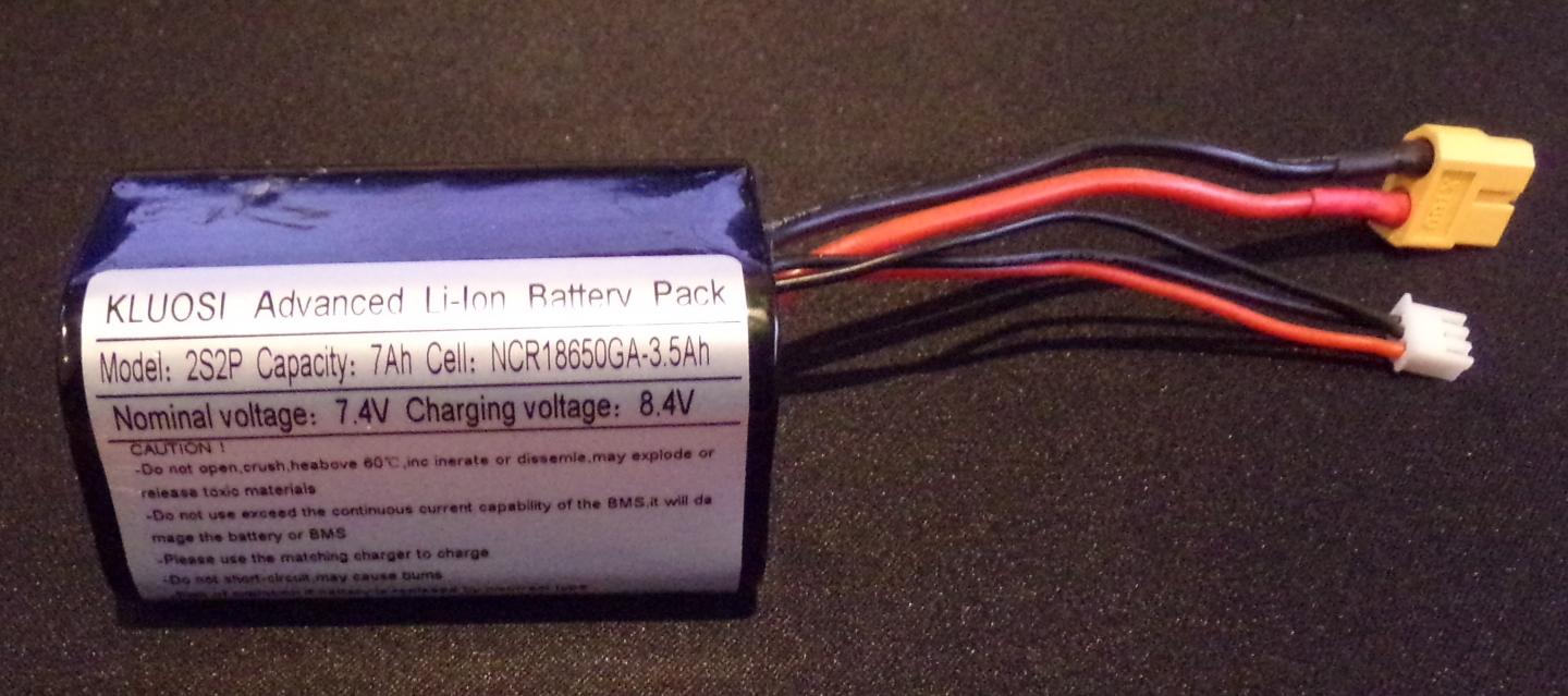

                              I received the "Kluosi Uav Lithium-ion Battery (7.4 V / 8.4v3.5ah 2s1p)​" on 12/16, or 3 weeks after I ordered. It is faster than their 2 months estimate. The 3 weeks time is typical of many sellers on AliExpress. It is quite acceptable. It is wrapped in a foam sheet and shipped in a small carton box so the packaging is very good. The battery pack looks the same as the HL pack with a XT-60 power connector and the XH balance charge plug. All these sound pretty good. But the main question is whether this the 3500 mAh battery that the seller promised.
                              Before I accepted the package, it has been sitting in the freezing temperatures of Chicago for 3 days. When I top off the battery charge as received, I found something unusual. The iMAX B6 charger was set at 8.2 volts cutoff. The battery dropped to 8,05 immediately when I stopped the charging. Is it the cold soak effect? I proceeded to the discharge process to find out the effective battery capacity.
                              I set the discharge current to 0.7A to simulate the HL tank. 2.7 hours later, the discharge stop when the battery drops to 6.2 volts and the capacity reads 1799 mAh. While it is not the 3500 mAh that the seller advertised, I am not disappointed. I saw the battery sustained more than 0.7A for 2.7 hours which means it will run a HL for at least that long. It is good to see that this battery never dropped below 0.7A all the way to the end. I am convinced that this battery pack uses premium cells. At under $10 per pack, it is the best deal to run HL T-90 and T-72 bar none.
                              I will let the battery sits overnight at indoor temperatures. When I test again tomorrow, I expect to see more consistent numbers tomorrow. Stay tuned.
                              I ordered 2 of the 2S2P 18650 packs that tank_me uses with modified HL chassis. At $16 per pack, it is much cheaper than I can buy premium cells. I hope to be able to reconfigure it to my DIY HL pack for most other HL tanks. I expect that I need to do only minor surgery to the 3-wire XH balance charge plug. If successful, I will post my process here.
                              Click image for larger version  Name:	IMG_4961.jpg Views:	0 Size:	161.9 KB ID:	364111

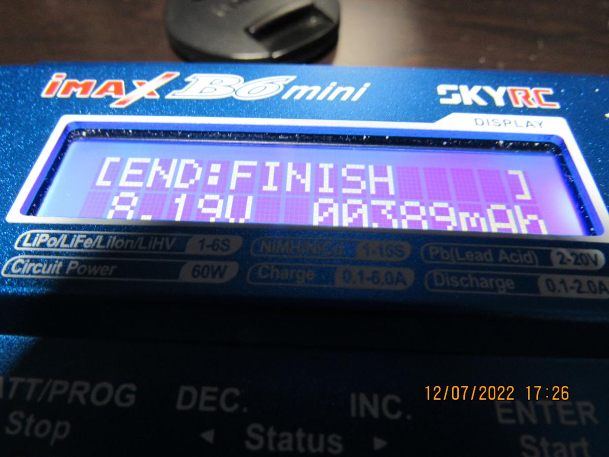

                                      No! You must match the chemistry of the battery to the charger setting. I have the SkyRC iMAX B6. I had an off-brand B6 before. The programming on the off-brand B6 was all messed up. The name brand B6 may cost a little more, but is assured to be working properly.
                                      When the charge is full on the Li-Ion pack, I switch to measure mode. The individual Li-Ion cells are 4.10 and 4.09 volts respectively.
                                      The SkyRC iMAX B6 also has fully functional programming mode, but the off-brand does not. Setting Li-Ion pack charge to 4.10 volts per cell is a good idea to get long battery life. So far, I use the default SkyRC program for all my charging.
                                      Click image for larger version  Name:	IMG_5127.jpg Views:	0 Size:	105.0 KB ID:	364232
                                      This is the top off picture after I received the pack.
                                      • cmdrcody
