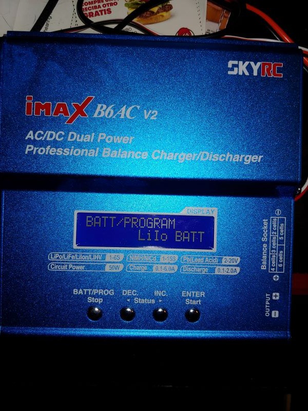

        I use SkyRC program default settings and did not change anything.
        If not defective, your SkyRC charger should default to 8.2 volts for 2S Li-Ion battery. Can you follow the SkyRC instructions for your charger? No need to make international calls. You can email or chat on line with SkyRC support if you have any questions after reading the instructions.
        Can you show a picture of your SkyRC iMAX B6 charger? We can help you to determine if you had been sold a knock-off. ​

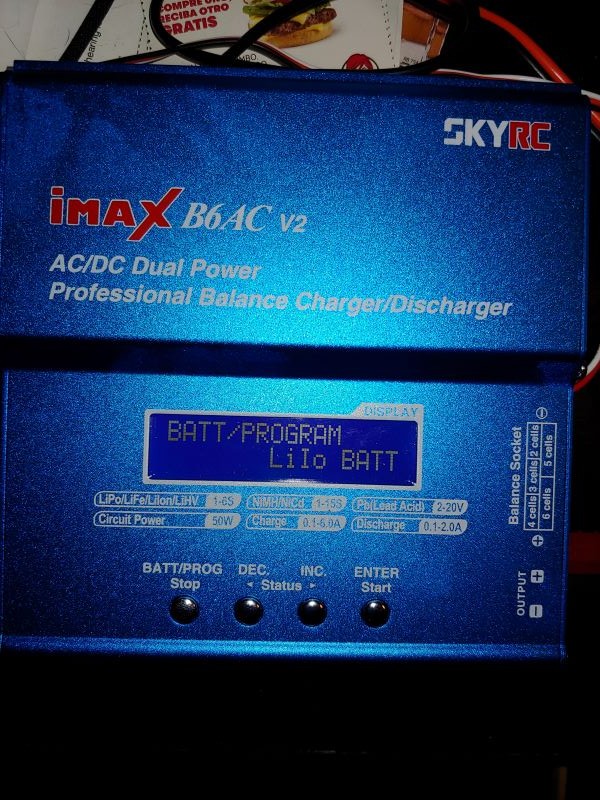

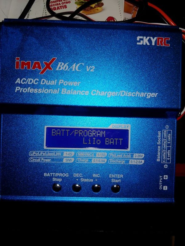

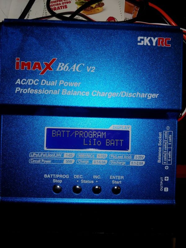

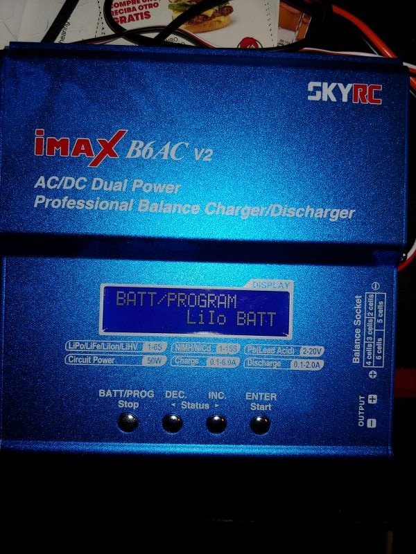

          Here ya go:
          And it did come with the manual and all the accessory battery connecting cables. Also ordered and received the battery temperature probe.
          Click image for larger version  Name:	1217221428.jpg Views:	0 Size:	157.1 KB ID:	364267

            You are ready to contact SkyRC. They are 13 hours ahead of you if you want to chat online. If you use email, it doesn't matter. Let us know how it goes.
            I got the mini version instead because I like that it had a cooling fan for the discharge resistor. I built a 60 watts supply for it from an auto battery charger. It was a while ago, the charger came with only the Dean's plug. I built my own XT-60 and Tamiya plug adapters.

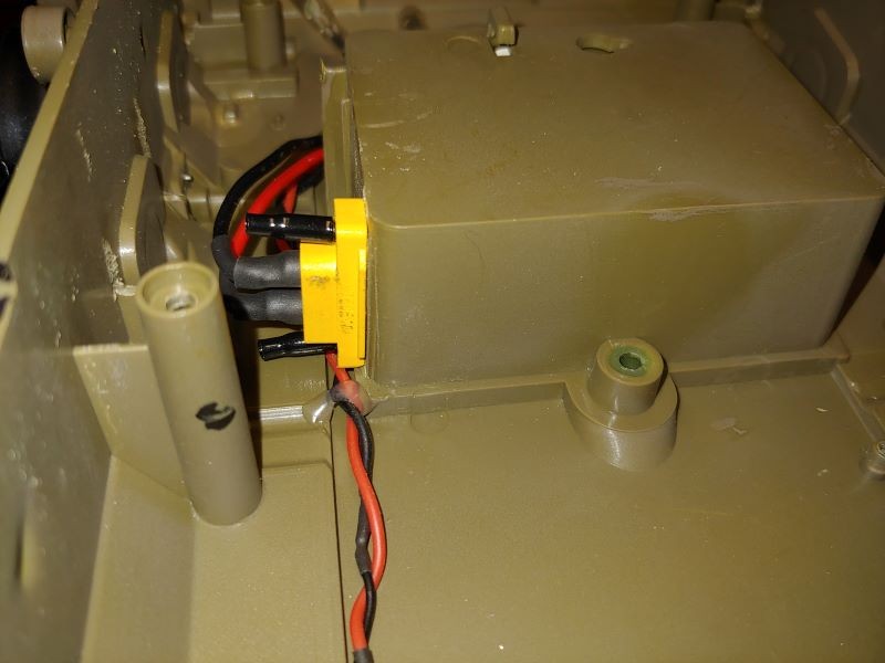

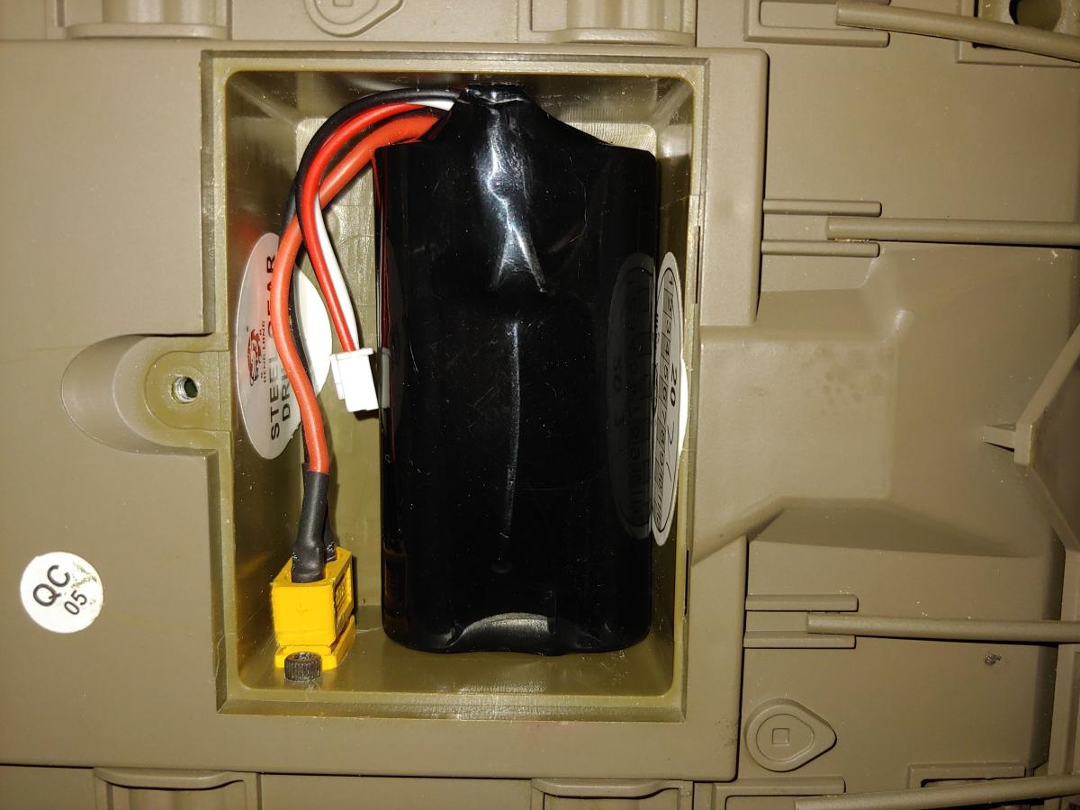

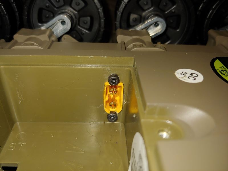

                I have made a modification in the T90 tank battery compartment to give more room and make it easier to plug in & out my batteries that have the XT60 female connectors. I carefully installed a XT60 male screw-held connector into the left top rear to the compartment and used the same OEM wires that were on the OEM connector soldered into it. Since I replaced the blown OEM speaker with two smaller (and better) speakers to the rear of the chassis in front of the gear boxes, I had the extra room to make this modification.

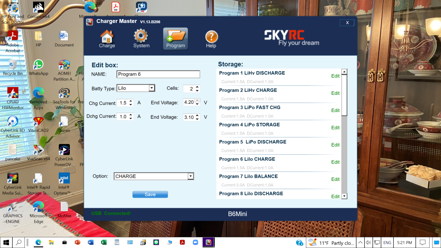

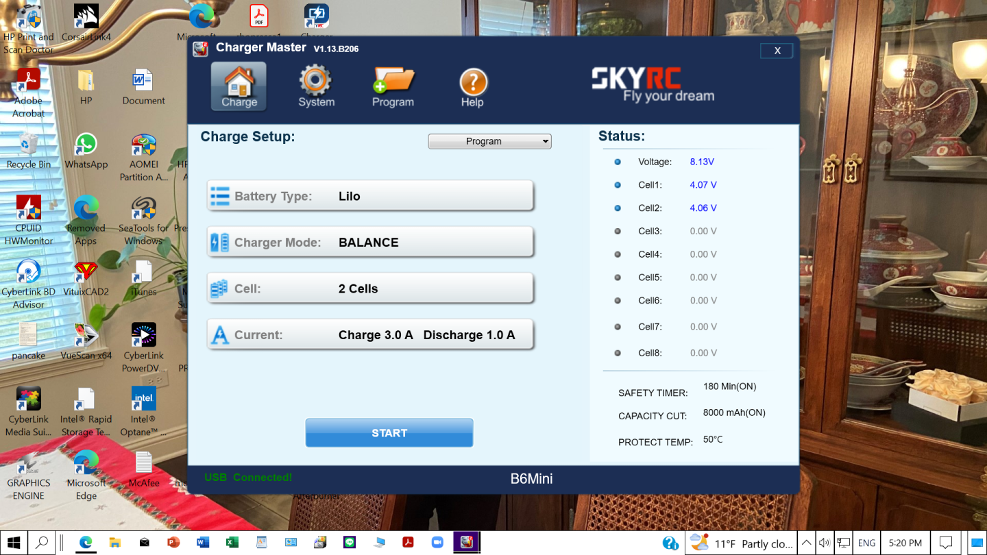

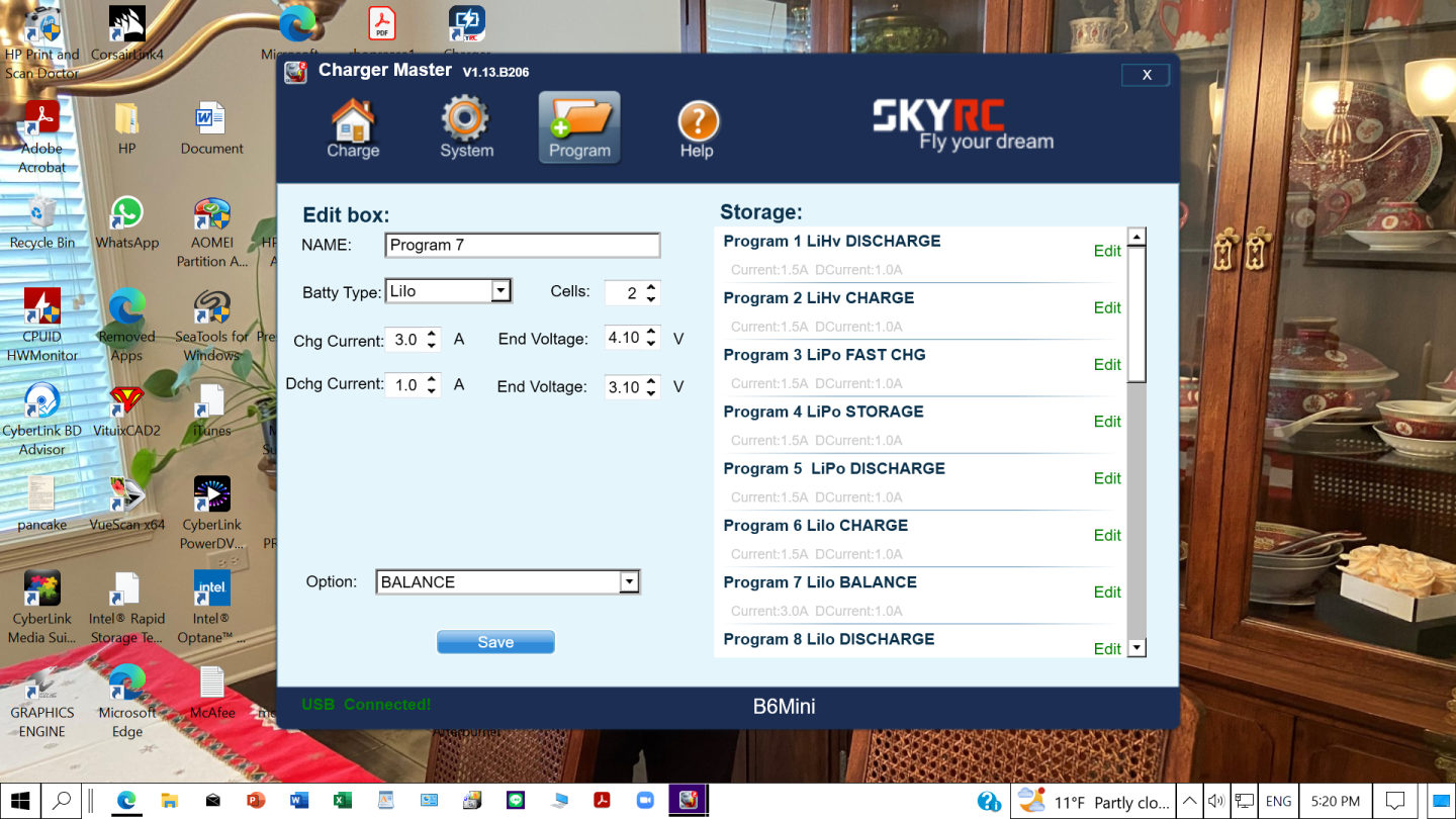

                  Most of the time, I just charge the single battery pack using the loaded program. Yes, I use the 'Charge Master' program when I have a bunch of packs or want to do some testing of a new brand. I have the B6 iMAX mini which has 20 preloaded, but editable, programs. Program #6, 7 and 8 are for Lithium Ion batteries.
                  Click image for larger version  Name:	Screenshot (8).png Views:	0 Size:	1.02 MB ID:	364994

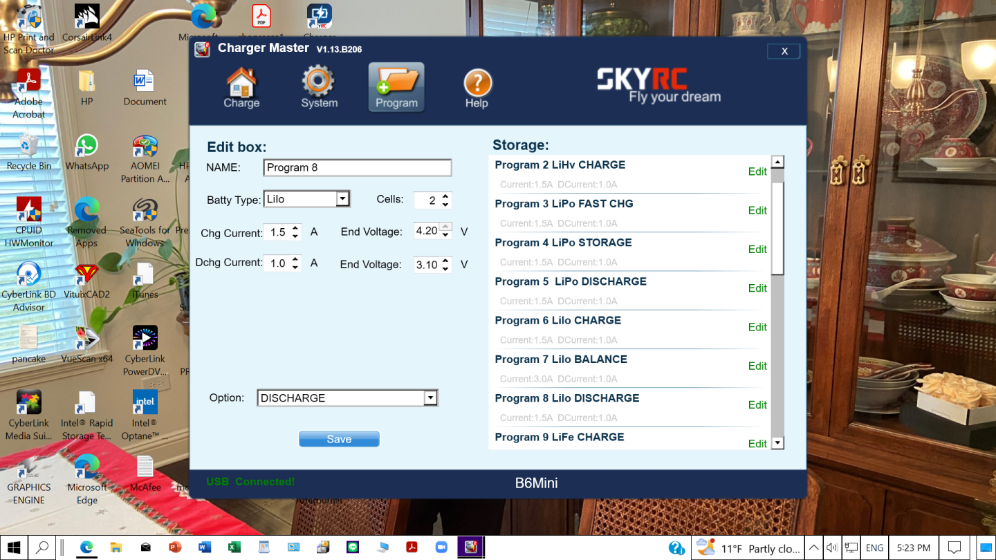

                  I use an edited Program mostly for 2S1p or 2S2P balance charge. I changed the end voltage to 8.2 volts or 4.1V per cell. Program #6 and 8, the default end voltage is 4.2 volts per cell.
                  Click image for larger version  Name:	Screenshot (5).png Views:	0 Size:	1.00 MB ID:	364995Click image for larger version  Name:	Screenshot (6).png Views:	0 Size:	1.02 MB ID:	364997Click image for larger version  Name:	Screenshot (7).png Views:	0 Size:	1.02 MB ID:	364996

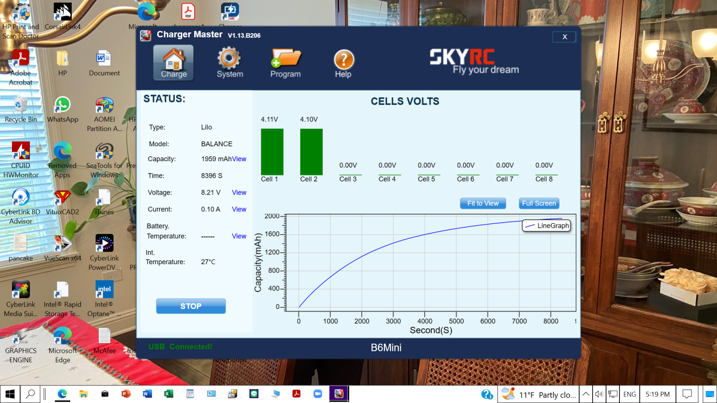

                  A typical balance charge process is like this: For this one, I started with a partially charged pack from storage.
                  Click image for larger version  Name:	Screenshot (4).png Views:	0 Size:	1.01 MB ID:	364998
                  If your battery charge end voltage is 7.2 volts for 2S Li-Ion packs and not editable, your charger is NOT working properly. Hope this helps.
