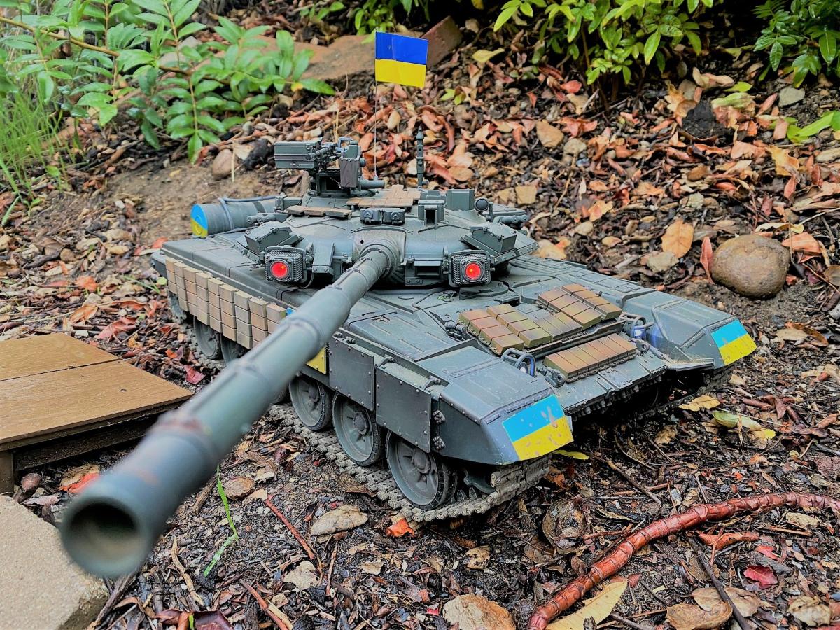

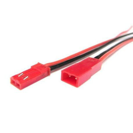

      I have a pair of extra “IR” turret lights (from Aliexpress) on my T-72. As there are no rear lights, I’ve simply spliced them together and wired them to a plug into socket LED3 (just check the polarity - marked on the MFU case), and I can switch them on and off from the remote using ‘G’ and control stick 1. My MFU is a 7.1, but I’m sure the function is the same as the 7.0. The plug is the black or red 2-pin JST (Dupont?) type. These can be bought ready-wired. Works for me, anyway…

        A word of advice for the crimpers...a lot of them are crappy. You may ruin a bunch of the silver connectors before you get the hang of it. There are vids on YouTube showing the best crimping methods for JST/Dupont connectors. I've had a lot of the wires pull out of the JST or Dupont connector pins so I typically put a tiny bit of solder on mine and only use the crimper to bend the "wings" of the pin over. Just my process as I'm proficient with a soldering iron.

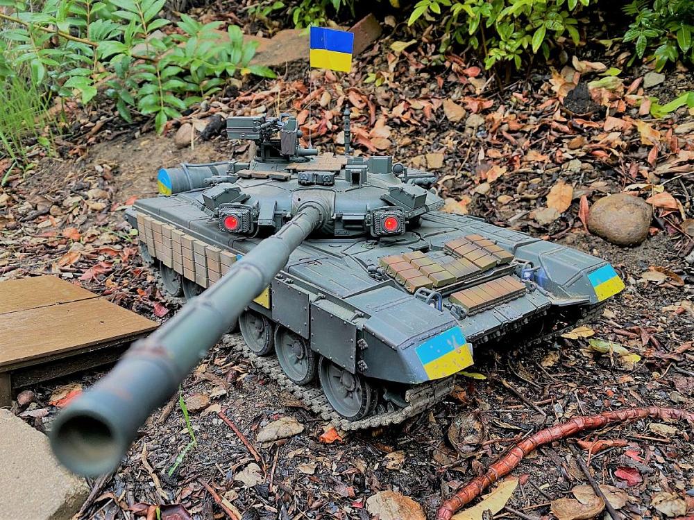

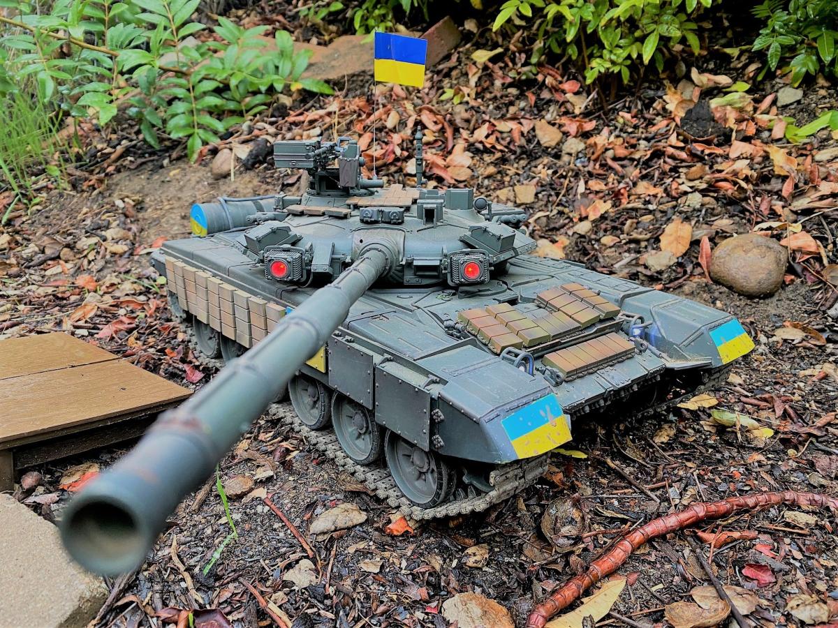

          Red eyes.. these were store bought with the tank, but simply routed wires through holes in the turret and connected to, in my case, the tail light circuit.

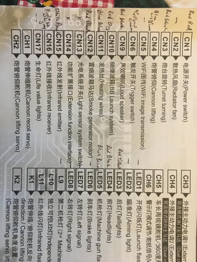

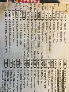

                            Sorry. I guess it’s what I wrote in my manual…

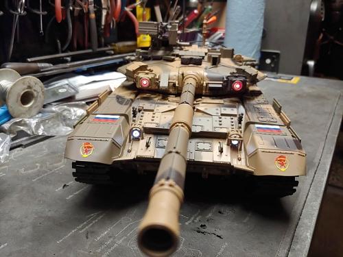

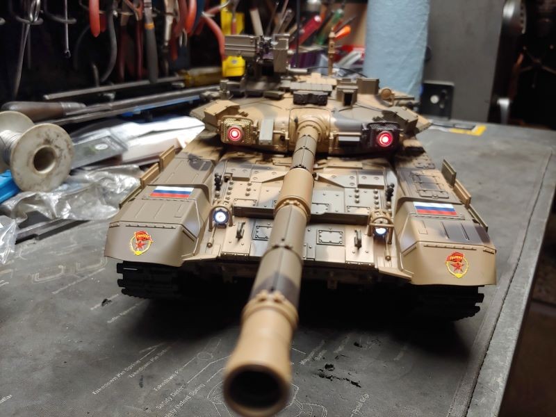

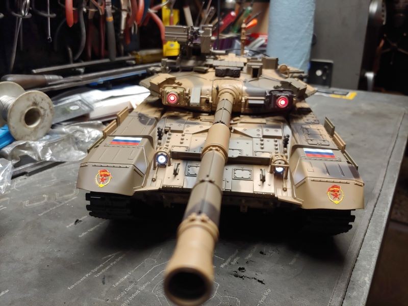

                                Okay, got the 'Red Eyes' mounted and wired to LED3 on the TK-7.0 board.
