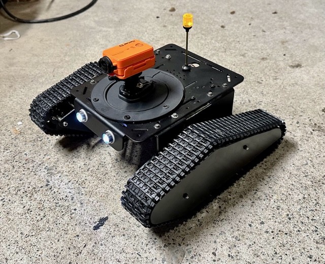

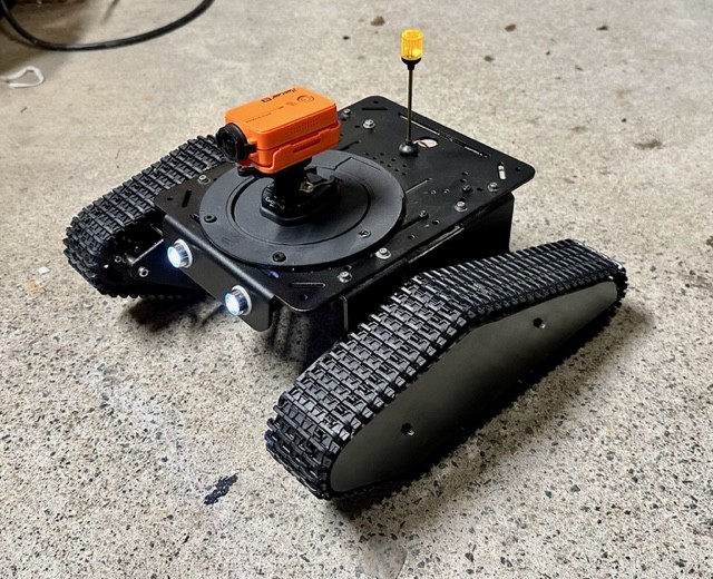

          After I removed my TK26 from a tank, I placed it in my roving camera.

          • #65
            It looks like Wall-E went to the gym

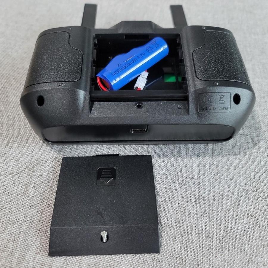

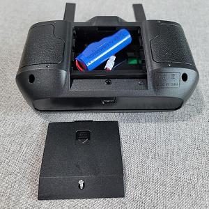

              YK 26 controller use 1s/800 mA.
              Unfortunately, the Lithium Ion 14500 cell in the Can Shou controller is far from a 800 mAh battery. I topped it off with a standard USB transformer and the CS charge cable. The capacity was measured to be 320 mAh when discharged to 3 volts. I tried to charge it with the SkyRC charger, the CS battery will not take any charge current higher than 0.1 ampere (yes, 0.1A, no typo) and charge to 3.84V and 160 mAh. It is a very cheap, low capacity battery designed for trickle charging only.
              Click image for larger version  Name:	cstk26__1673258958_b0249399_progressive.jpg Views:	0 Size:	147.0 KB ID:	392865
              This low drain, low capacity battery has 2 advantages. It takes less than an hour to charge up fully and does not heat up much in operation.
              Most RC tank controller are very short range device, thus, need very little power. But the 320 mAh will last only part of a battle day. I plan to make a 2P 14500 battery pack which should give it 1600 mAh capacity and a few full days operation. (The CS controller battery compartment is too small for the LiIo 16650 cell.)

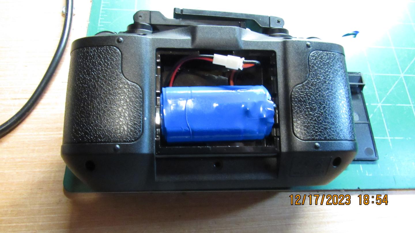

                      I made a 1S2P 14500 battery pack using 2 EBL cells. I can charge the pack using 1.2A charge current (SkyRC charger) and reach 1114 mAh in slight more than an hour. I charge Lithium Ion cells to only 4.1 volts to get the most of their cycling life. (Manufacturer's rating for quality 14500 LiIo cell is typically 800 mAh for charging up to 4.2 volts.) The 2P configuration allows me to use a relatively high charge current of 1.2A for about an hour before it tappers off.
                      The CS TK-26 compartment can house the 1S2P 14500 battery pack easily.
                      Click image for larger version  Name:	IMG_5272.jpg Views:	0 Size:	129.0 KB ID:	393005
                      I estimate that it will take 7-8 hours to charge this pack using the build-in USB-C plug.
