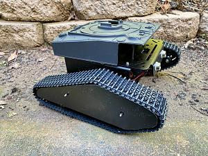

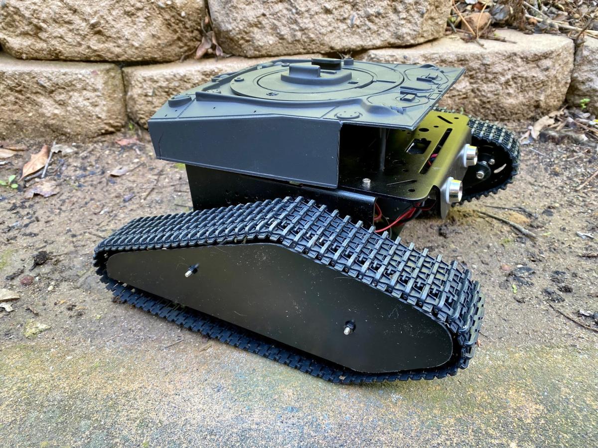

                            I put the system into a lightweight tank, an all-plastic HL Sherman. I did this to use its servo recoil and elevation capability. The "good" is that those functions are versatile. Both functions required reversing servos, which the board does easily. The "bad" is that there is nearly no low speed, just fast. One can get low speed but it takes a very fine control on the stick. Previously I had put it in a couple heavy tanks, lastly an all metal Mato Sherman, and this "jackrabbit" tendency wasn't apparent. This plastic Sherman is much lighter, and so jumps to speed much faster. I wouldn't put it in an IR battler. Also, LED3 the tail light socket doesn't work, which makes that circuit unusable for the LegoDEI IR receiver LED use.
                            For me, it'll be a workbench board, for checking out new tanks that don't already have a main board.

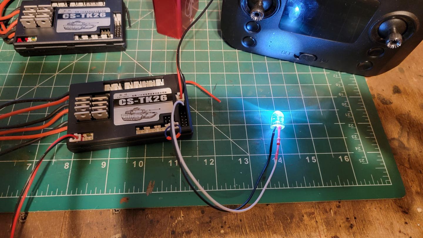

                                  Bob, rear tail lights: Function key + Left stick, left.....It lights up this white LED with a forward voltage of 3.8 just fine...
                                  • SoCalBobS
                                    • 2716
                                    • Southern California
                                    #57
                                    Thanks Ken. Actually I misspoke. I connect my LegoDEI lights to LED3. It does work just as you said. What I was trying to say is that I hook up tanks that have taillights normally on LED3 to LED2 on HL boards which is "brakelights" to free up LED3. The TK26 doesn't have a brakelight function on LED2.
