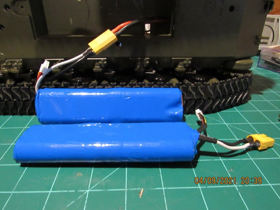

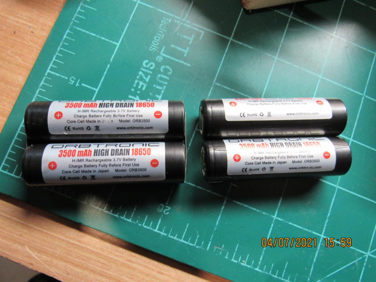

              I looked at the Lithium Polymer battery quite extensively. They are much cheaper than the Li-Ion packs and more plentiful from e-bay and Amazon sellers. I purchased a 2S 2200 mAh, a 2S 5200mAh and a 3S 3000 mAh packs. The 2S 2200 mAh, and 3S 3000 mAh packs fit the HL battery compartment easily, But I could not get any LiPO pack with a larger then 4000mAh to fit unless I cut up the tank chassis and decided against it.
              I finally settled on the Li-Ion using 2S 26650 or 2S2P 18650. The Li-Ion has high energy density, holds constant voltage over most of the discharge cycle, thermally stable (a safety issue) and has slow self discharge. But good Li-Ion packs are hard to find and expensive to get. Most of the cheap packs from China barely hold 1/5 of the charge they advertise, some even less. Finally, I ended up making my own Li-Ion packs using old premium cells I got in the past.

ID:	367082Click image for larger version

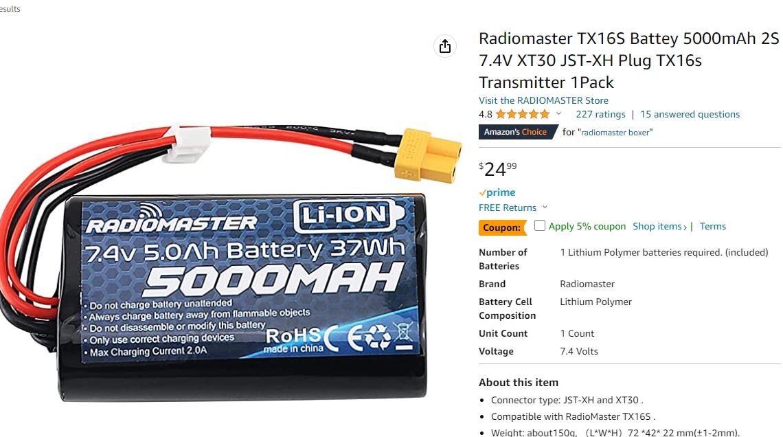

                                Amazon has this Li-Ion in stock. This should do it for our HL tanks right..
                                • #17
                                  This is Lithium Polymer battery of very low drainage intended for radio transmitter only. After changing the connector to XT-60, I will recommend testing the tank at full speed on the workbench to measure how much the battery warns up.
                                  In general, I recommend ONLY lithium Ion battery pack using cells with built in protection circuit. It is misleading for them to print Li-Ion on a Lipo battery.
                                  • #18
                                    I bought one and while it worked it wasn't very good at supplying amps or run time. I still use 5200mAh 2S LiPo's. These are what I use but mostly as they were old LiPo's I no longer was using in airplanes.
