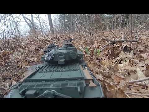

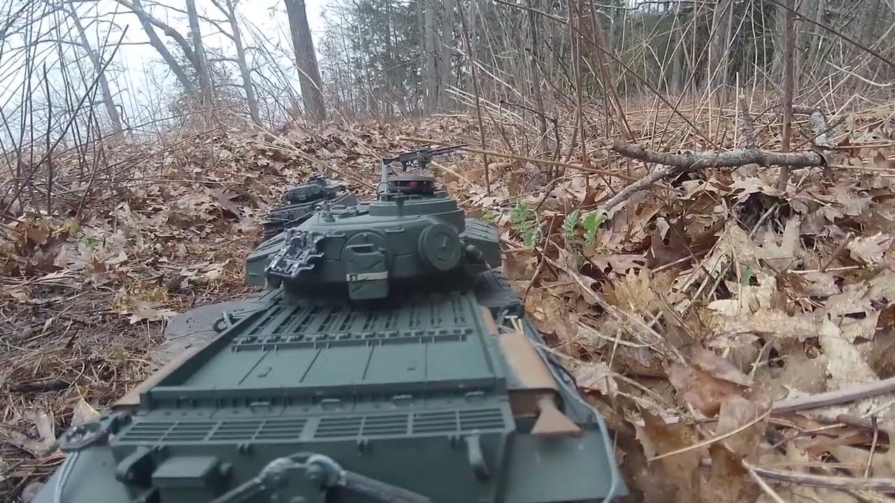

                  I have put together a cam trailer for one of my centurions to pull. This morning I recorded a run with the two centurions with it. The cam is supposed to suppress vibration with its software but I think it still shook too much. Be that as it may, the two tanks are being controlled simultaneously with the one Radiomaster transmitter. One of the tanks did get snagged on something once and I had to reach down and give it a push. Otherwise all went pretty well, with a few missteps but no disasters.
                  I have attempted to post the video to my instagram account. No idea if it worked and is viewable. My instagram is: oldwolf1946. Feelfree to take a look and let me know if it actually can be viewed. In my experience, the first try on such a thing never works.

                      Your video displayed fine on Instagram. Impressive double driving skills. I really like the trailer POV. Sure does looks like New England! Nicely done.
                      I do like putting my videos on YouTube so they’re accessible whenever for anyone. The way I do it is: there are a number of format options on the banner over the message text box. One is an icon of “film”. Get and copy the address of your desired YouTube video. Select the film icon. In the box it shows, paste the YouTube address you copied. Tada!
