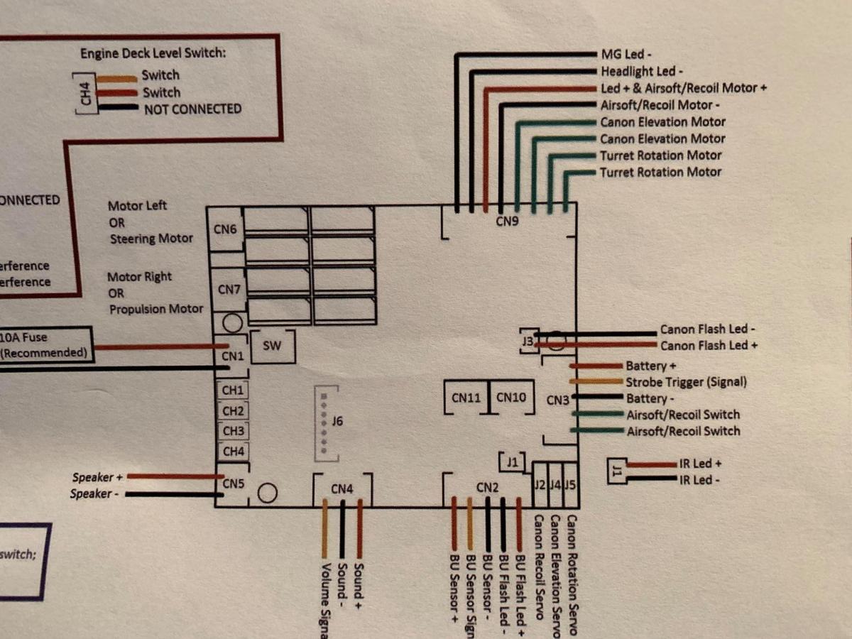

                  Can anyone post the Clark TK50 wiring diagram please?
                  • SoCalBobS
                    • 2716
                    • Southern California
                    You can go to their website then screen capture what you need. The TK40 & 50 are esentially wired the same.
                    • tank_me
                      • Feb 2022
                      • 1182
                      There is an easier to read version that I like to use.
                      Notes on the 8-pin connector:
                      Turret rotation + and - pins are not labeled as it doesn't really matter which is which being a motor connection. It can be swapped freely to get the right motor directions.
                      The MG and front headlight LEDs share a + feed, but have their own - ground feed.
                      General Notes:
                      CN6 and CN7 are the primary motor feeds and the + and - can be on either pin depending how your motors are wired. They can be swapped freely to get the right motor directions.
                      Cannon flash LED is for a standard 3mm or 5mm LED flash and not the Taigen high intensity flash. High intensity goes into CN3.
                      Ground wire (black) for the servo connections is closest to the edge of the board.
                      I've never fused any of my Clark board power inputs, but you can if you like. I don't think many have.
                      Must program the board with the Sony remote to use the servo recoil and servo elevation or they will act really weird. That weirdness has burned out servos before.
                      Click image for larger version  Name:	tk40 Wiring.jpg Views:	0 Size:	148.1 KB ID:	376476
