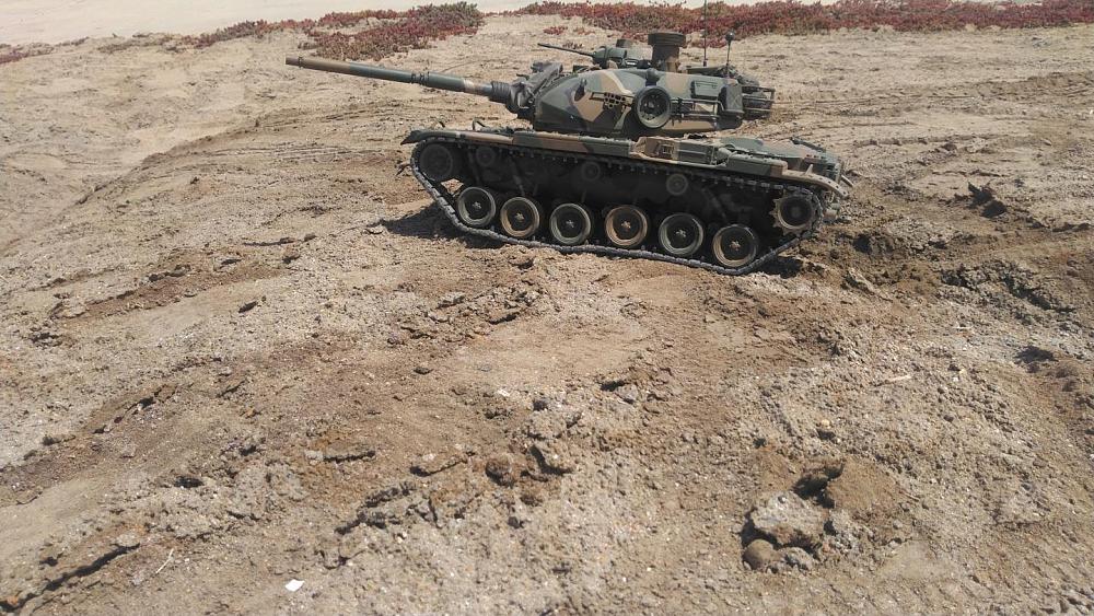

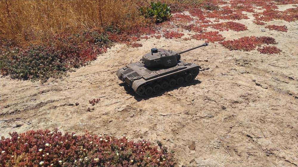

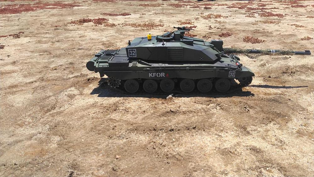

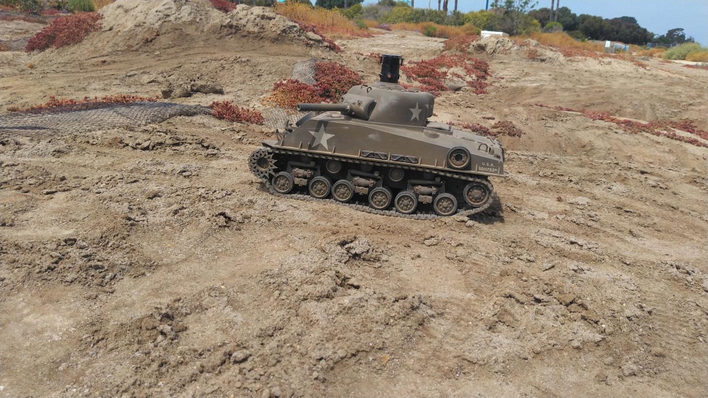

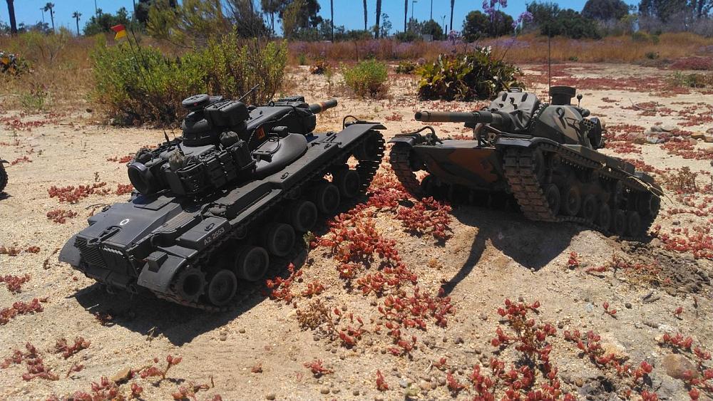

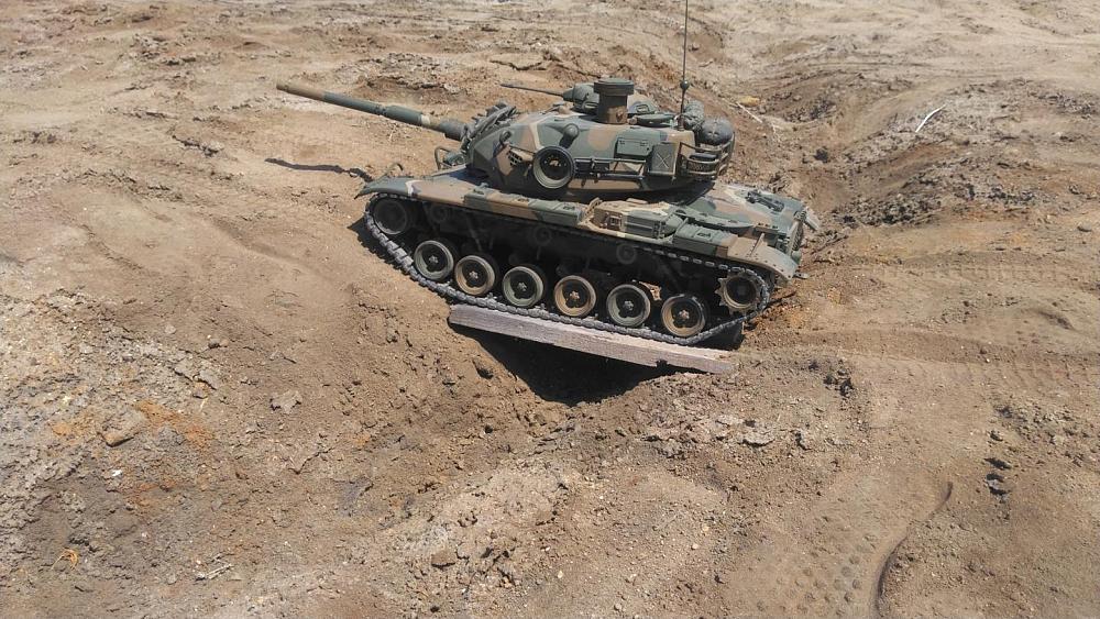

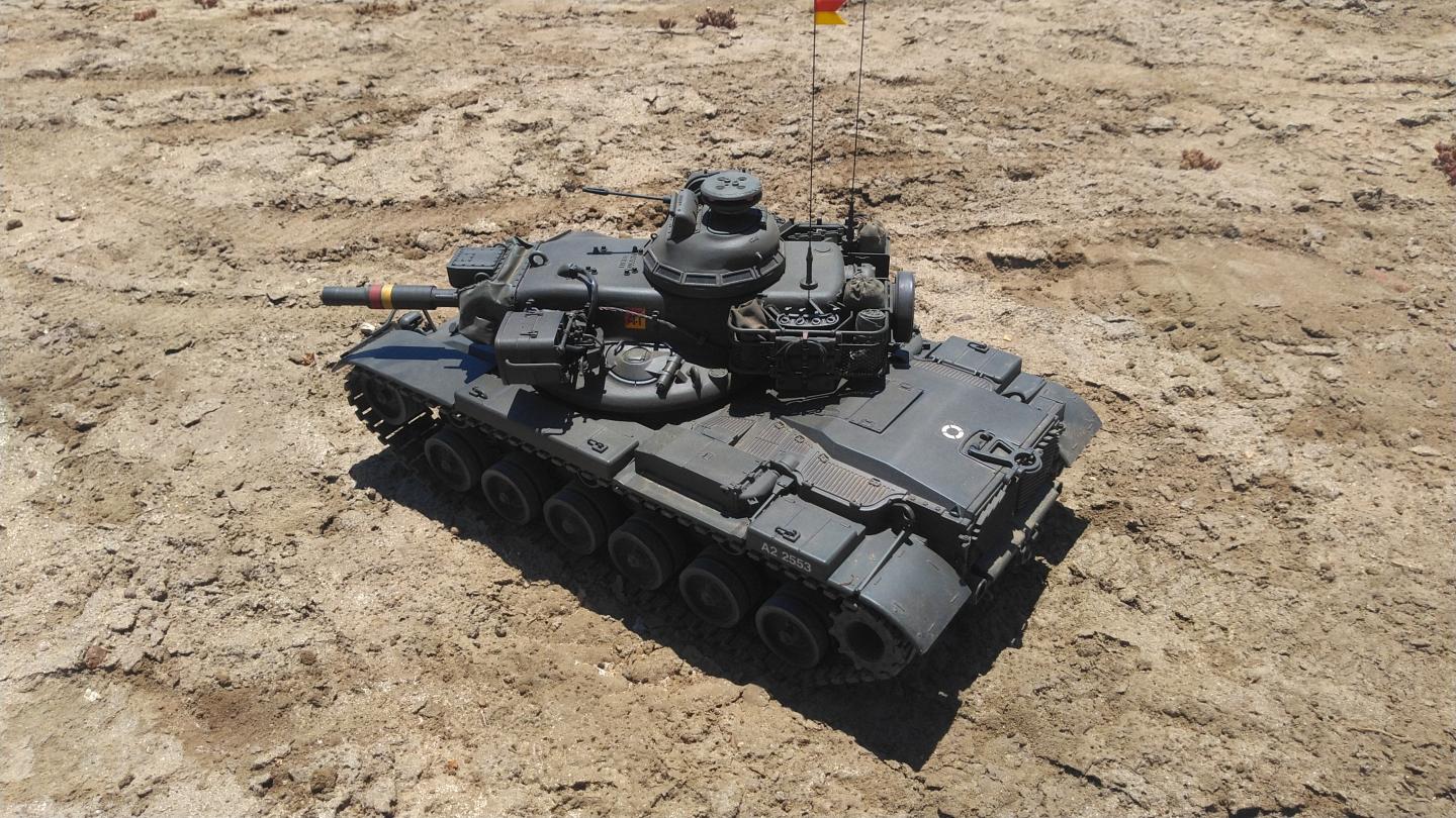

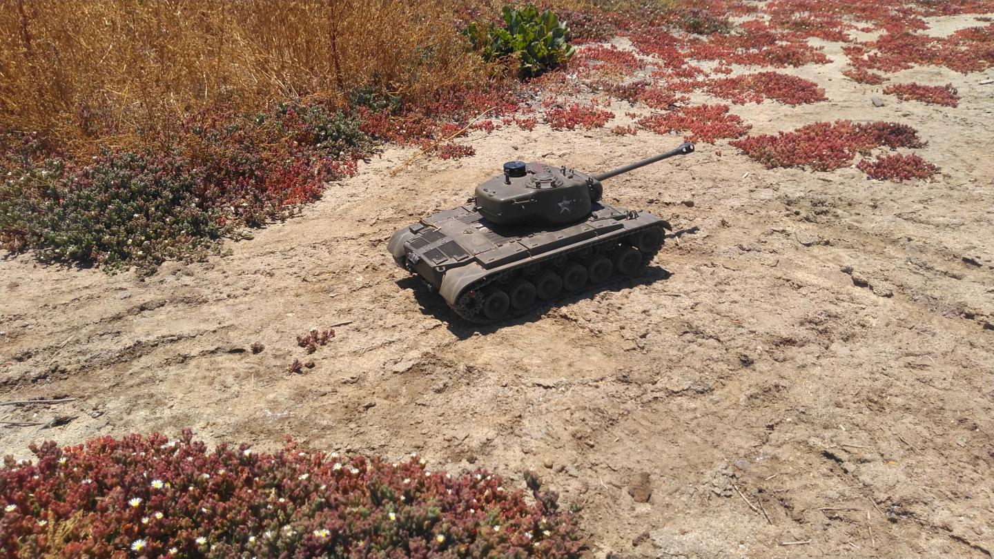

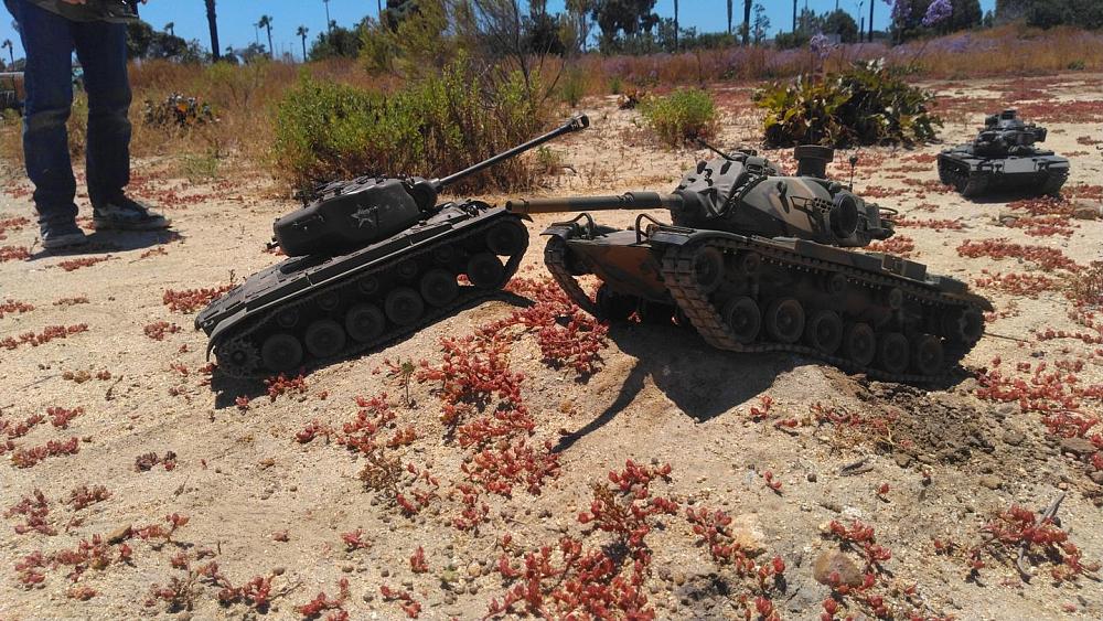

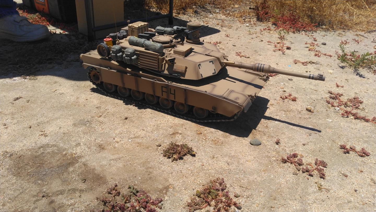

            Some more pics from our fun field and battle day

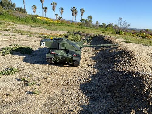

                  #28
                  Here's that same field this Spring. No red then!

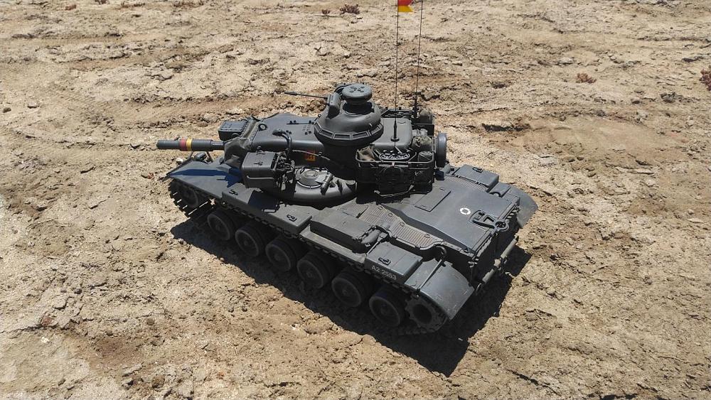

                    #29
                    Originally posted by tank_me
                    I think a tank with the Red Desert MERDC camo would like right at home on that field. :)
                    An LA member had one I painted for him. It blends in very well.
