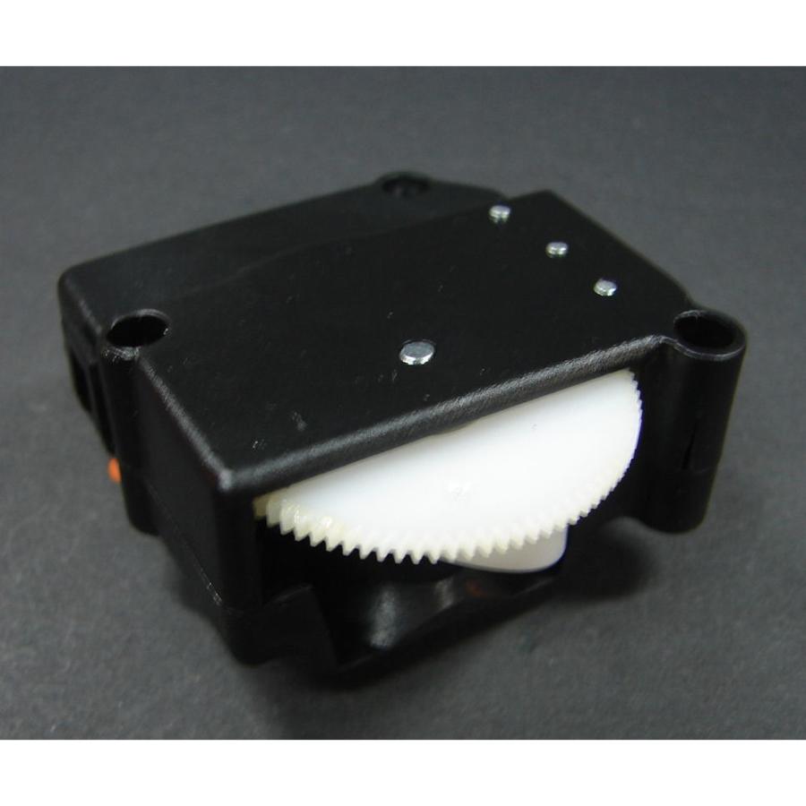

            With HL tanks from 2011 era, you would likely have the horizontal cam system elevation that is continuous.
            Newer HL tanks use a side elevation that is no longer a continuous rotation, but have up and down limits. Servo does the same (limits up and down movement)
