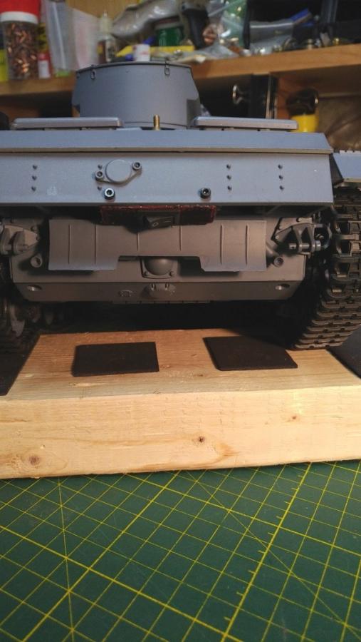

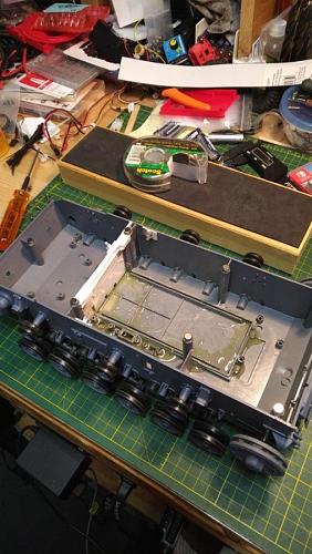

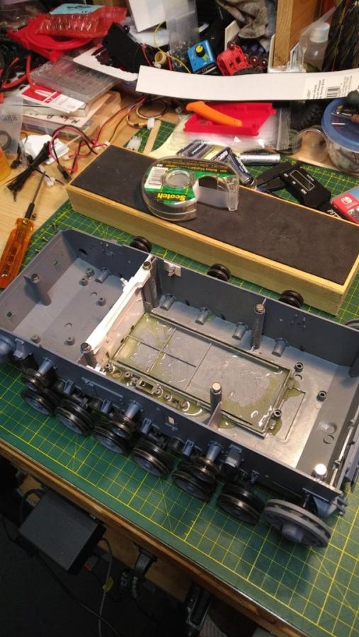

    Battery box removal/sealing and magnetizing hull.

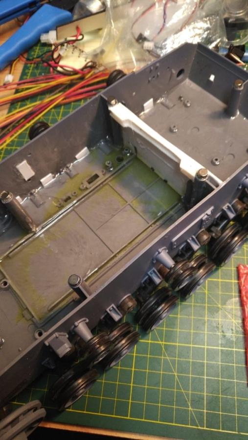

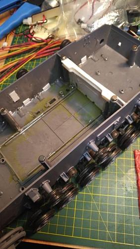

    Adding a resin base to the chassis floor.

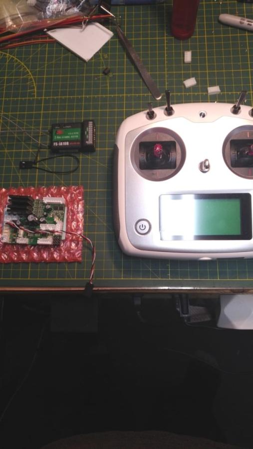

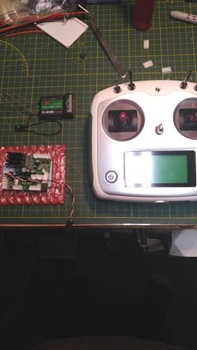

    The Clark TK-40S (Tiger I sound set) & FS-I6S TX to be installed/used for controls
    Click image for larger version  Name:	PZ3-J04.jpg Views:	0 Size:	70.7 KB ID:	382086

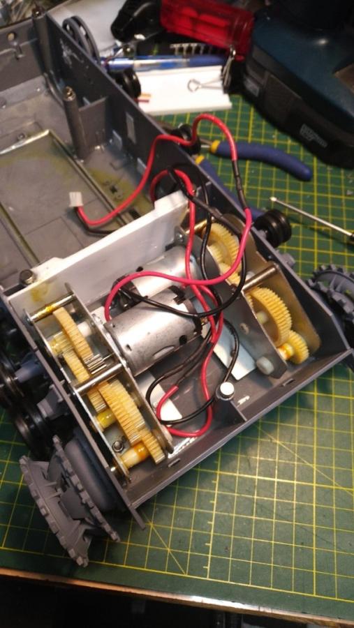

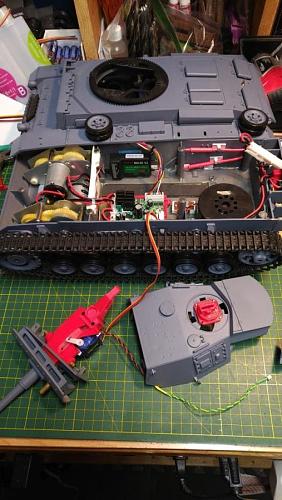

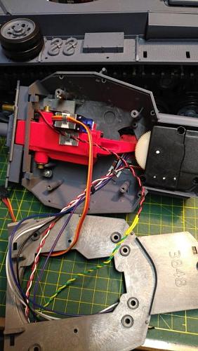

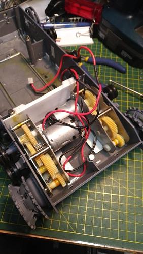

    Original gearboxes re-installed. If it had metal tracks, or massed much more, steel replacements would be in order.
    Click image for larger version  Name:	PZ3-J05.jpg Views:	0 Size:	81.1 KB ID:	382087

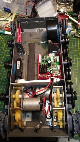

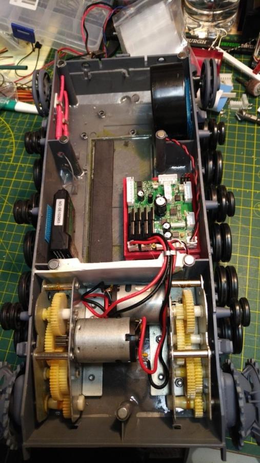

    Basic layout for TK40, RX, and factory speaker (TK40 only has a limited Wattage output, so factory speaker is OK)
    Click image for larger version  Name:	PZ3-J06.jpg Views:	0 Size:	60.2 KB ID:	382083

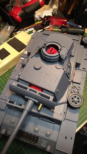

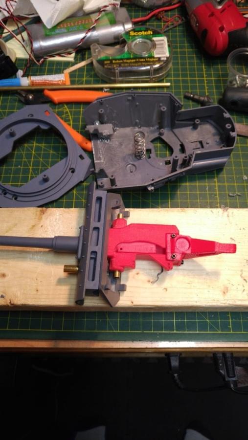

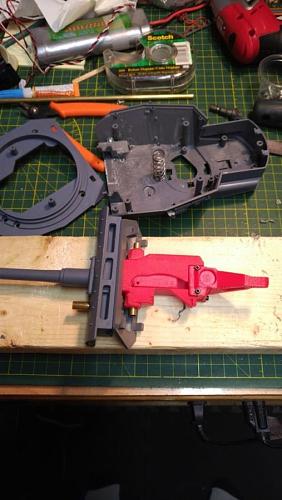

    Mounting of JCC compact recoil unit and a mantlet mounted emitter tube.
    Click image for larger version  Name:	PZ3-J07.jpg Views:	0 Size:	81.6 KB ID:	382094

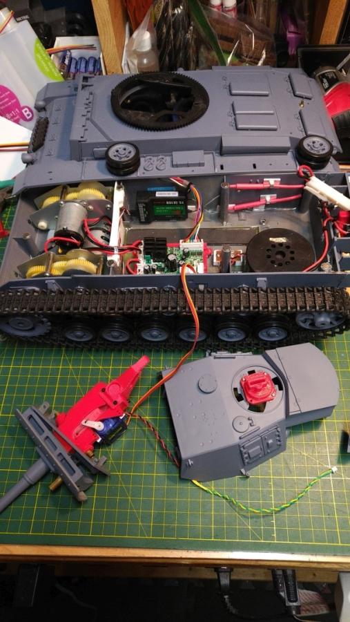

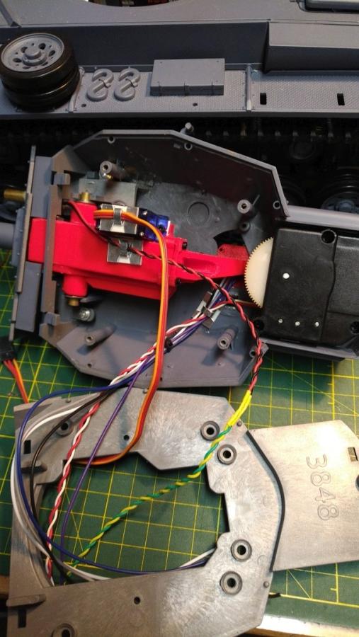

    Testing of driveline and recoil unit operation. Correcting motor polarity, recoil direction, sound tests, etc...
    You can see the custom PZIII/IV IR Mounting that fits inside the cupola).
    Click image for larger version  Name:	PZ3-J08.jpg Views:	0 Size:	71.5 KB ID:	382090
    Cannon, mounted, IR Apple base mounted. Tested for connectivity & functionality
    Click image for larger version  Name:	PZ3-J09.jpg Views:	0 Size:	79.8 KB ID:	382088

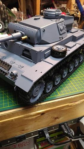

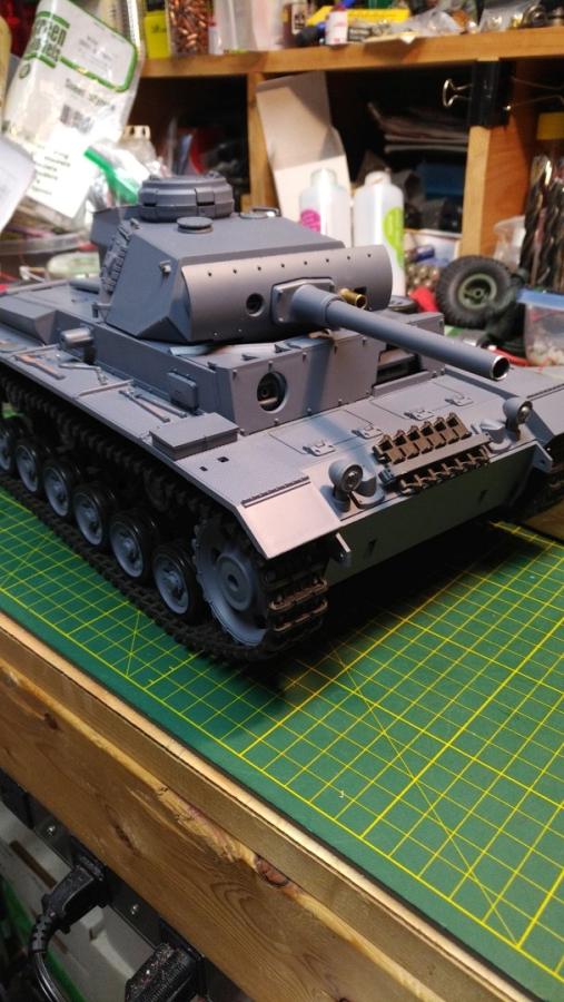

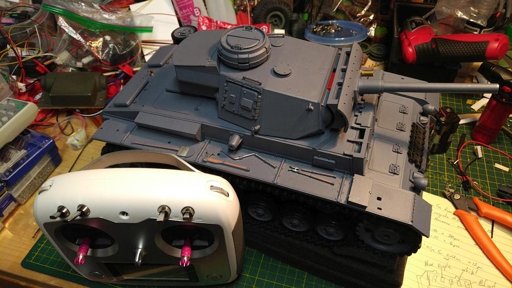

    Reassembled.
    Click image for larger version  Name:	PZ3-J10.jpg Views:	0 Size:	72.1 KB ID:	382092

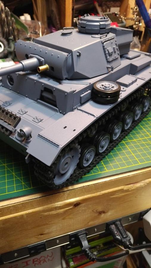

    Reassembled, showing the IR emitter tube.
    Click image for larger version  Name:	PZ3-J11.jpg Views:	0 Size:	71.6 KB ID:	382091

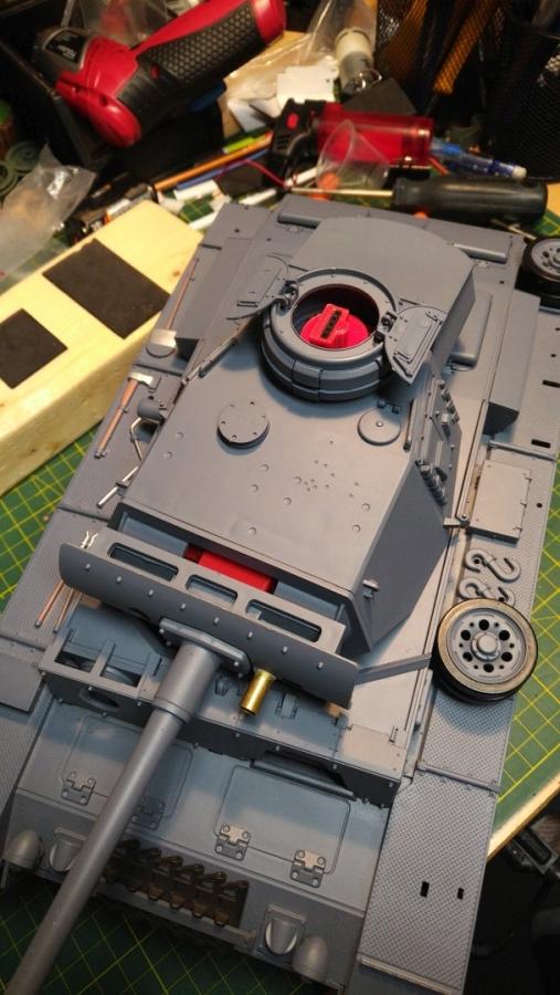

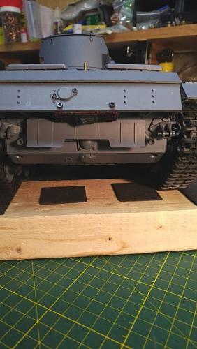

    Top view showing the Apple Base exposed for attaching an apple for combat.

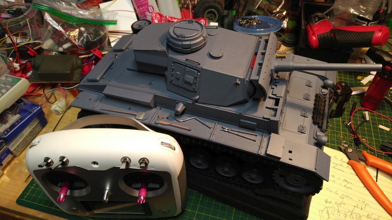

    Power switch is located externally under the back deck, for ease of operation.
    Click image for larger version  Name:	PZ3-J13.jpg Views:	0 Size:	230.8 KB ID:	382093

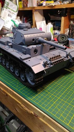

    The finished product, fully tested for IR Combat.

      I like your detail of using M3 bolts to anchor the gearboxes. I haven't had the screws fail yet, but it's a quality idea.
      • #4
        Also one of the reasons I like to resin pour a solid floor in my tanks for mounting the gearboxes. Prevents the trio of original little posts from taking all the assembly tension of the bolts on a gearbox side. Alternative is to use a piece of aluminum/brass tubing as a collar around the mounting posts to prevent collapsing.

            What's the length of the IR brass tube? I have to upgrade mine.
            • #7
              I use 6mm OD x 5mm ID brass tube, 20mm in length. IR bulbs fit directly into the tube, usually leaving at least 10mm from tip of bulb to tube opening. A dab of Shoe-Goo secures the bulb and still allows replacement when needed.
