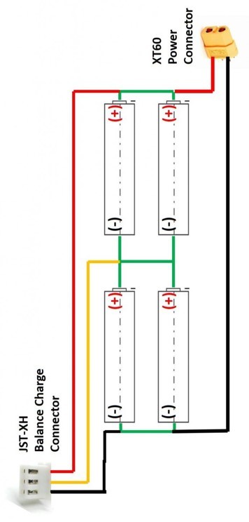

      The Lithium Ion battery that comes with the HL tank is not very good. Since the EV industry have driven the lithium battery way up, there is no easy solution to it. I built my own battery pack.
      For the HL tank, 4 18650 LiIo battery cells need to be arranged in 2S2P as this:
      Click image for larger version  Name:	IMG_4956.jpg Views:	1210 Size:	126.5 KB ID:	362075Click image for larger version  Name:	IMG_4960.jpg Views:	1178 Size:	123.1 KB ID:	362076 Click image for larger version
      When I built these in early 2021, I paid $10 for 4 of the EBL cells and got a 6000 mAh pack. Now, similar single cell is more than $10 EACH. The parallel charge plug is for use with a B6 parallel charger.
      Now, it is very difficult to find good quality 18650 battery at reasonable price. I built 2S pack using 2 EBL 26650 cells that cost about $6 per cell on e-bay. The EBL 18650/26650 are low current batteries, but sufficient for the HL class RC tank. EBL is the only honest manufacturer whose battery rating I can verify myself.
