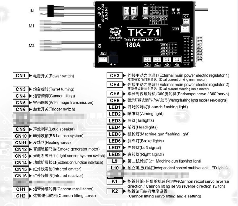

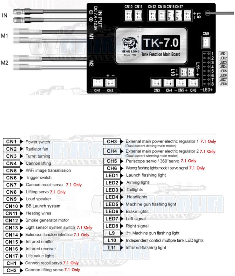

If you get the Heng Long generic metal recoil unit, the recoil connects to CN6. If it is a servo recoil, you will have a 3pins connector which goes to CH1 of the TK7.1 MFU.
Since your tank comes with the TK7.0 MFU, I suspect it comes with the generic trigger motor recoil. You need to show a picture of your recoil unit for anyone to help you.

The board you have does not support recoil, or elevation servos. I afraid you will need to upgrade to a TK7.1.

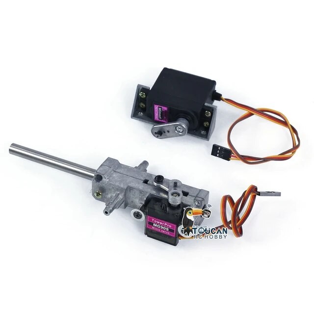

The servo recoil unit requires the HL TK7.1 MFU. Below is one unit I have, but did not install on a HL tank yet.
Can you use these pictures to identify which recoil unit do you have on your Challenger 2?

From memory, you will need to connect one wire to CN10. And then make a plug to install in CN6 to act as a trigger. Recoils that use servo can be obtained from the likes of Forgebear in the UK, or, as shown by Keilau from Toucan. They require a board like a Heng Long TK6.1s or TK 7.1.

The installation and connection of the servo barrel recoil and lifting unit is simple and straightforward. Just follow the instructions. You lost the BB shooting function when switching to servo recoil system.

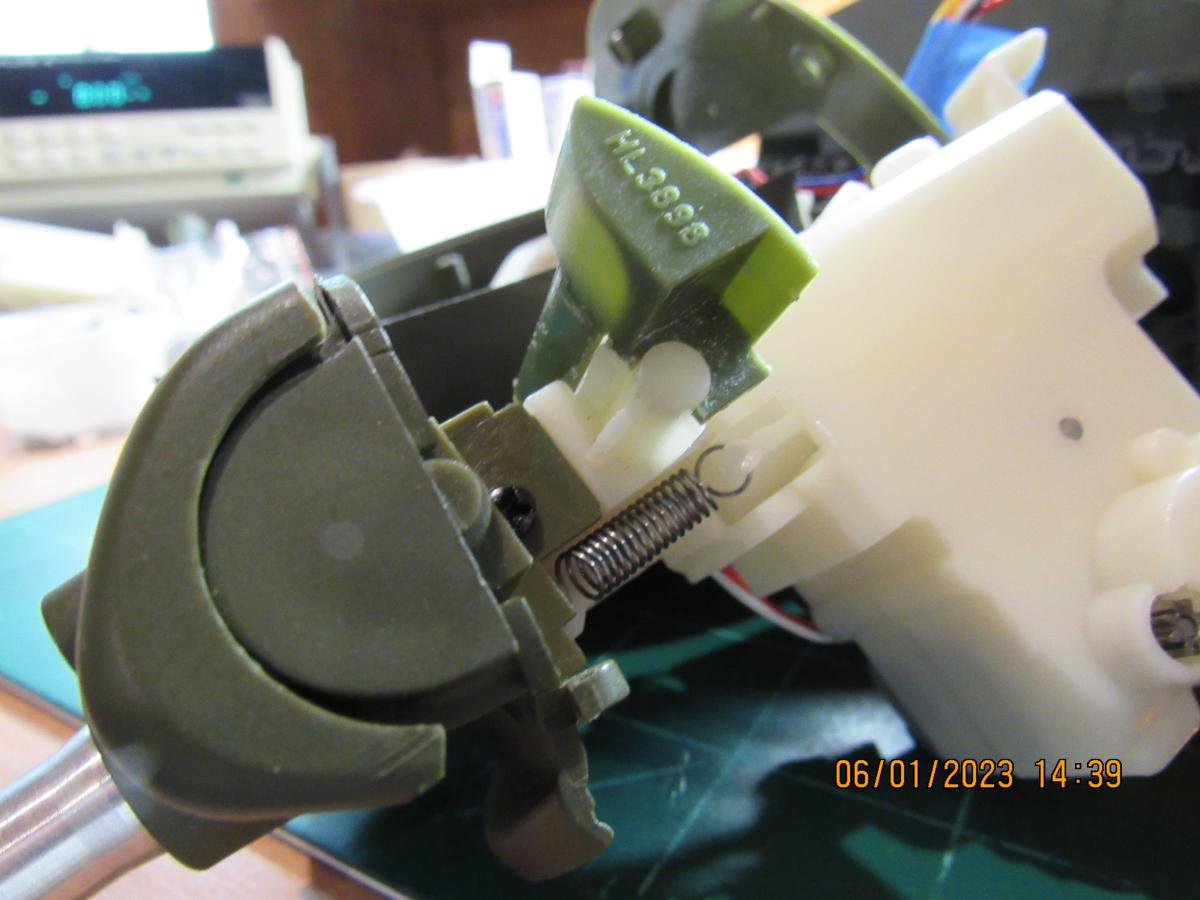

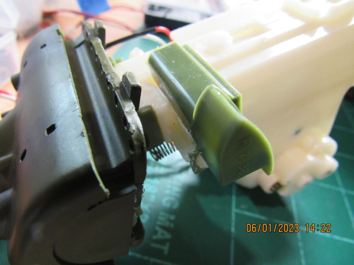

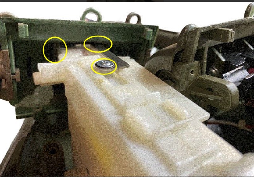

The installation of the trigger motor recoil is somewhat more elaborated. There is a light green BB feeding house as shown in Picture #1 and #2 of Post 6. The Heng Long recoil unit does not come with a spare BB feeding house so you must remove the housing from the original BB shooting unit. It took me several hours to remove one without breaking it. Or you may say "to hell with BB shooting" and install the recoil unit without the shooting function.

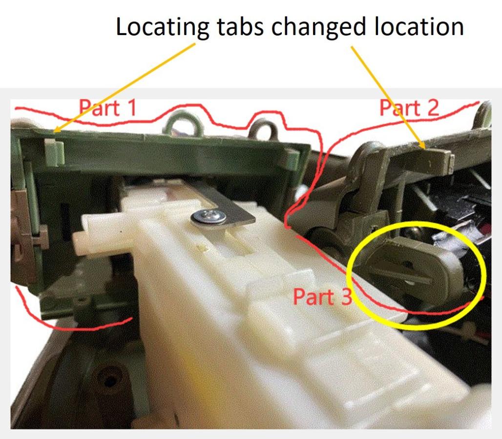

A few days ago, I posted on a Heng Long Metal Barrel Recoil BB shooting unit for 3838 Pershing upgrade kit that I purchased for my 2005 Snow Leopard. I said that over 18 years, HL changed the cannon mantle mounting plate enough that the kit does not fit my Pershing. I contact the Toucan seller (build-for-u) to request a return.
keilau are those pics from your Sherman adventure? Was that an older or earlier Heng Long tank? Because the last 3 or 4 tanks I've taken apart all 2020 and newer didn't have any issue with the BB feeding tray. Just curious.
Yes, Picture #1 and #2 are from a Sherman. Picture #4 and #5 are from a very old Pershing. Sharp eyes. I randomly picked those pictures for illustration purpose.
The HL T-34/85 has the same BB feeding housing as the Sherman. Both of them were purchased in the last 4 years. I have very limited collection of RC tanks and do not want to generalize too much. I am confused by what answer is @barrel recoil looking for.
