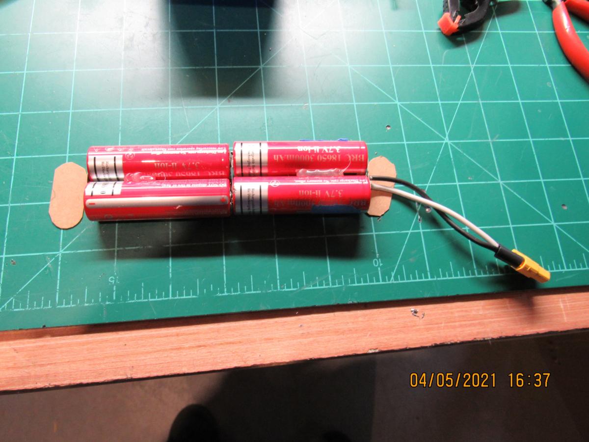

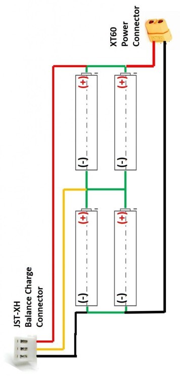

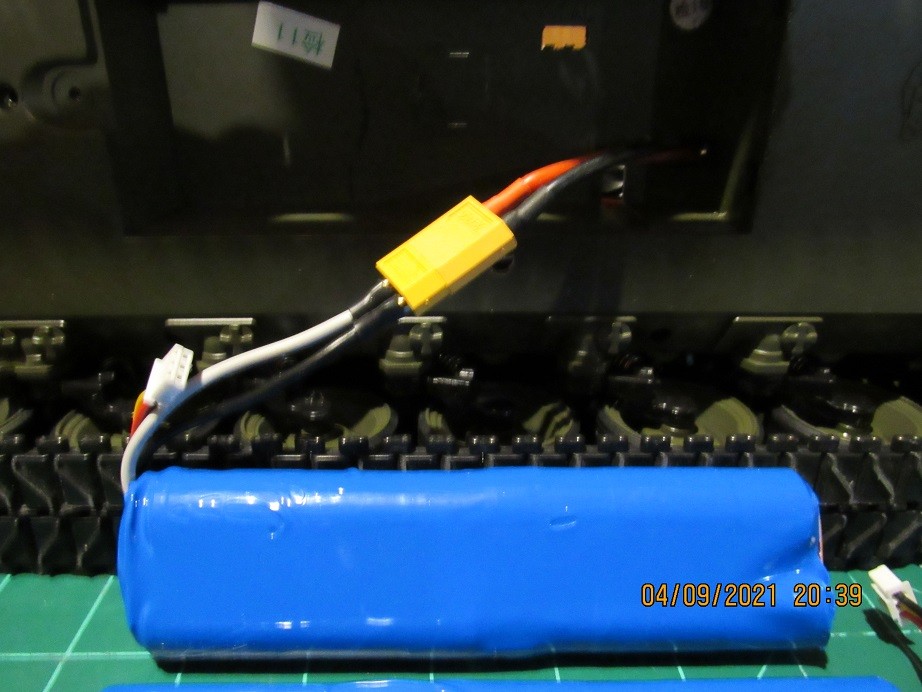

      The older HL used 6S NiMH battery and changed to 2S Lithium Ion battery in current production. No matter what battery you use, the voltage is 8 volts plus/minus 0.4 volt fully charged. But the discharge rate and capacity can vary a lot. Avoid no name brand battery that advertised unrealistic capacity such as many sold on ebay.
      I use home built 2S or 2S2P Li-Ion battery packs in my HL tank because I can use name brand battery cells with honest capacity rating and built-in protection circuit. I do not use LiPo on RC tank for the lack of protection circuit despite they are much cheaper.
      Click image for larger version  Name:	2S2Pschematics.jpg Views:	0 Size:	34.8 KB ID:	398214 Click image for larger version  Name:	IMG_4957.jpg Views:	0 Size:	111.8 KB ID:	398215 Click image for larger version  Name:	IMG_4960.jpg Views:	0 Size:	123.1 KB ID:	398213
